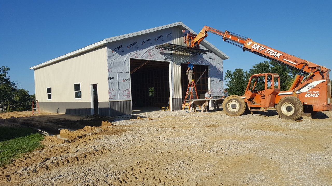

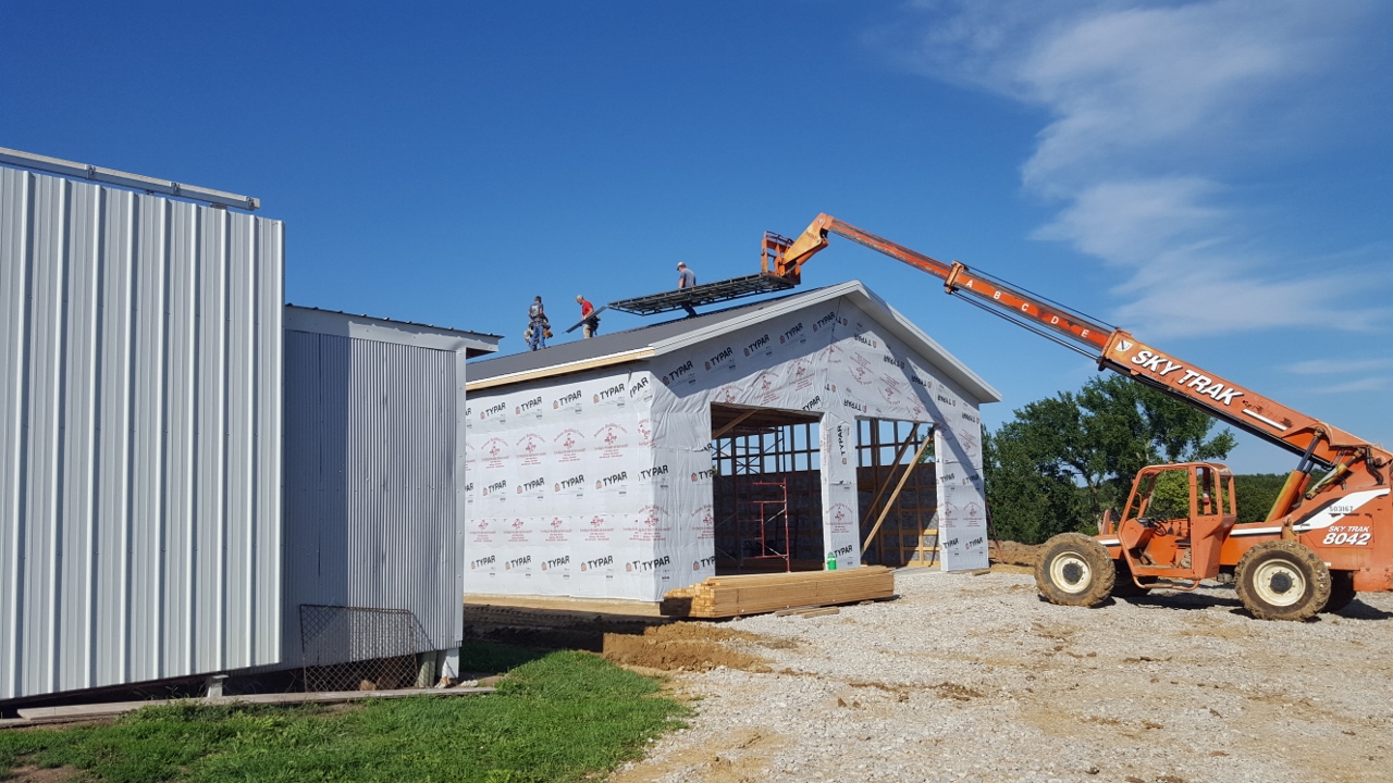

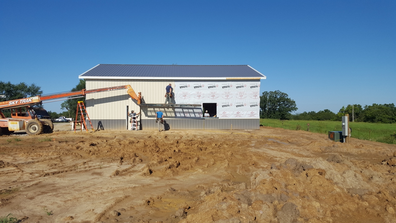

Update time. Been pretty hectic the past week or so....
My builders took little time to tin the shop. They are so precise in their skills that they pre-drill every screw hole with no misses. Wayyyy beyond my capabilities.
Overhangs took the most time. 12" on the eaves. 18" on the gables. This eliminates waste of roof tin.

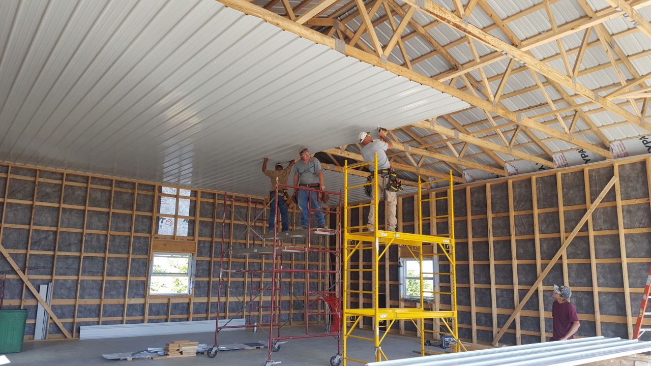

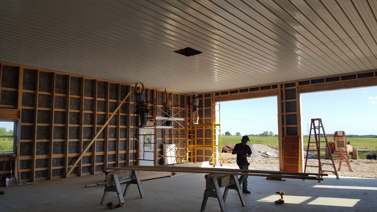

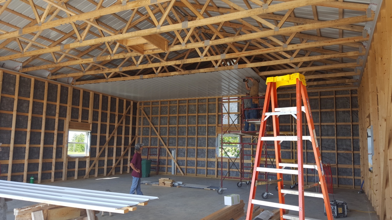

My buddy and I had planned to do all of the interior. My builders got done with the outside mid-day so I asked them if they would do the ceiling metal liner. 2 hours and 45 minutes later it was done. Would have taken us 3 days minimum...?br>

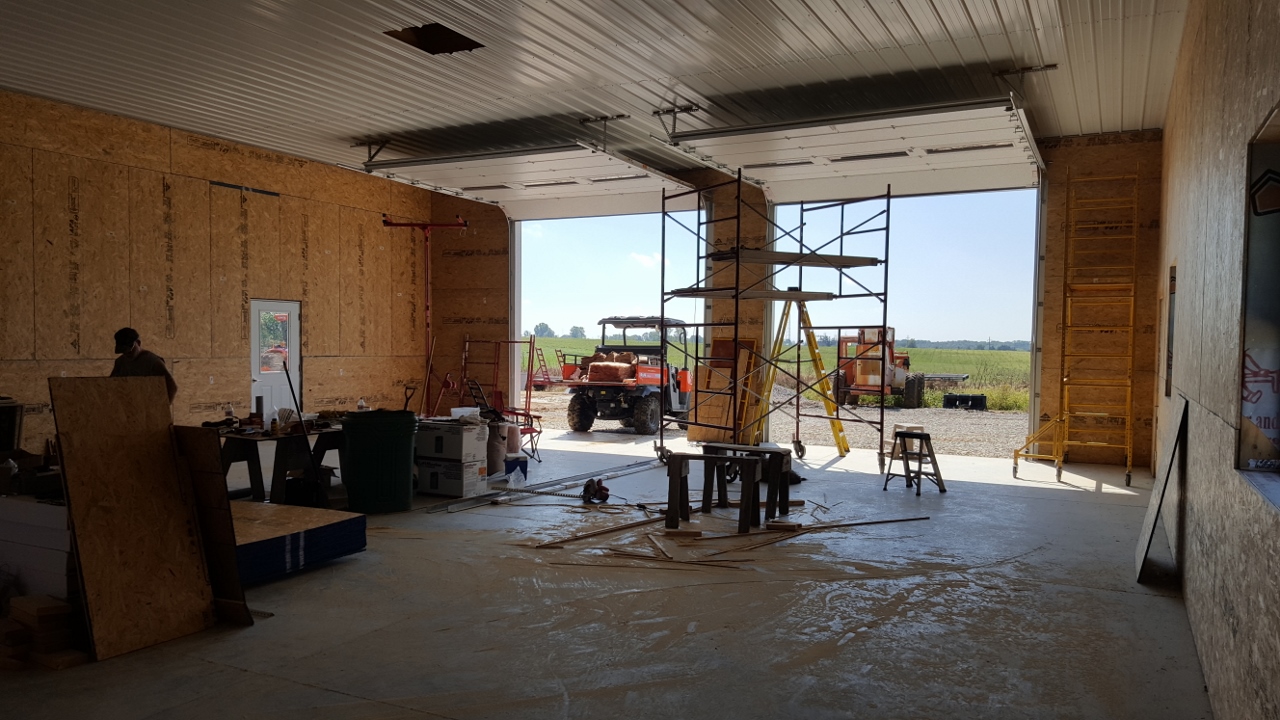

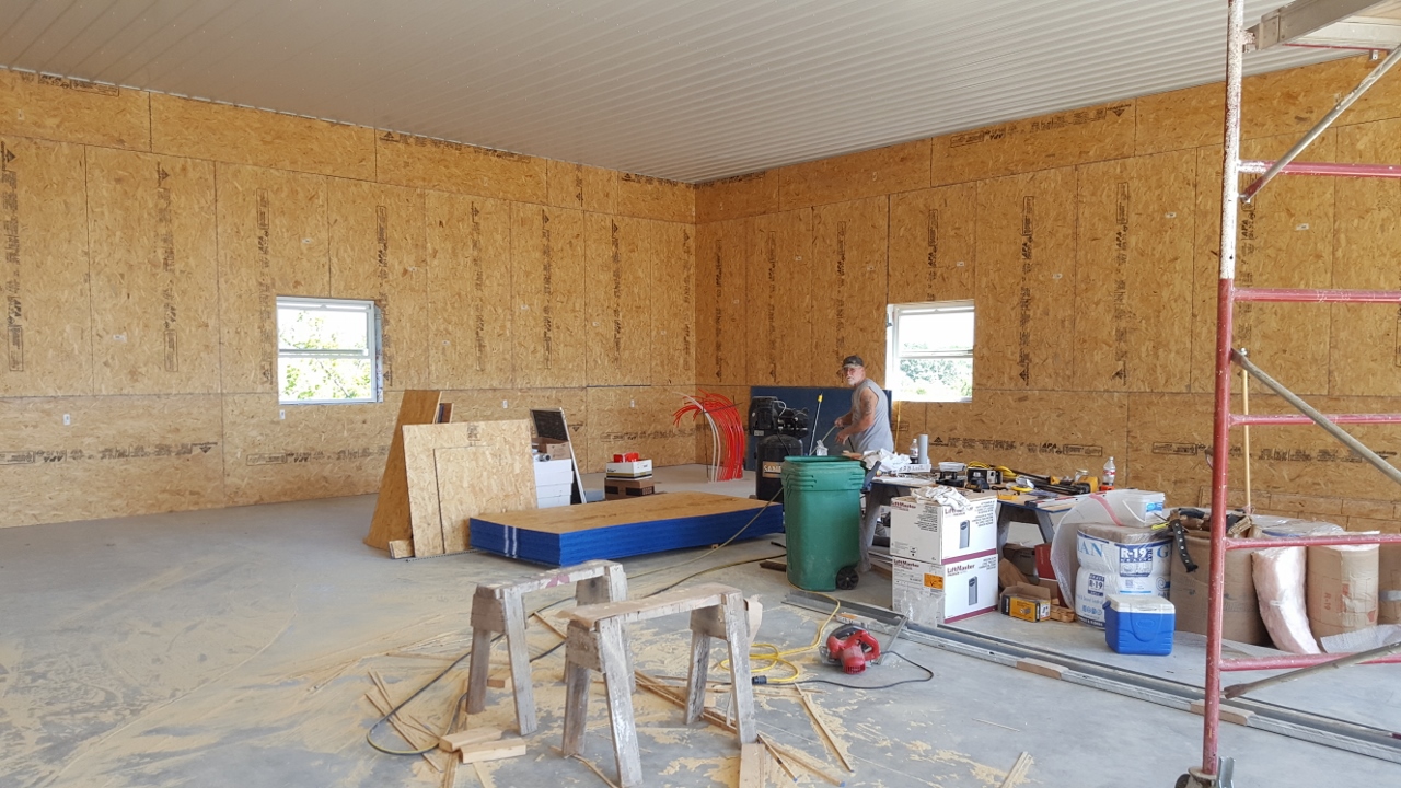

Once the doors were on we started working on the interior walls. Stapled up R19 faced fiberglass insulation. Didn't capture a pic of that process. Then sheeted with 1/2" OSB.
