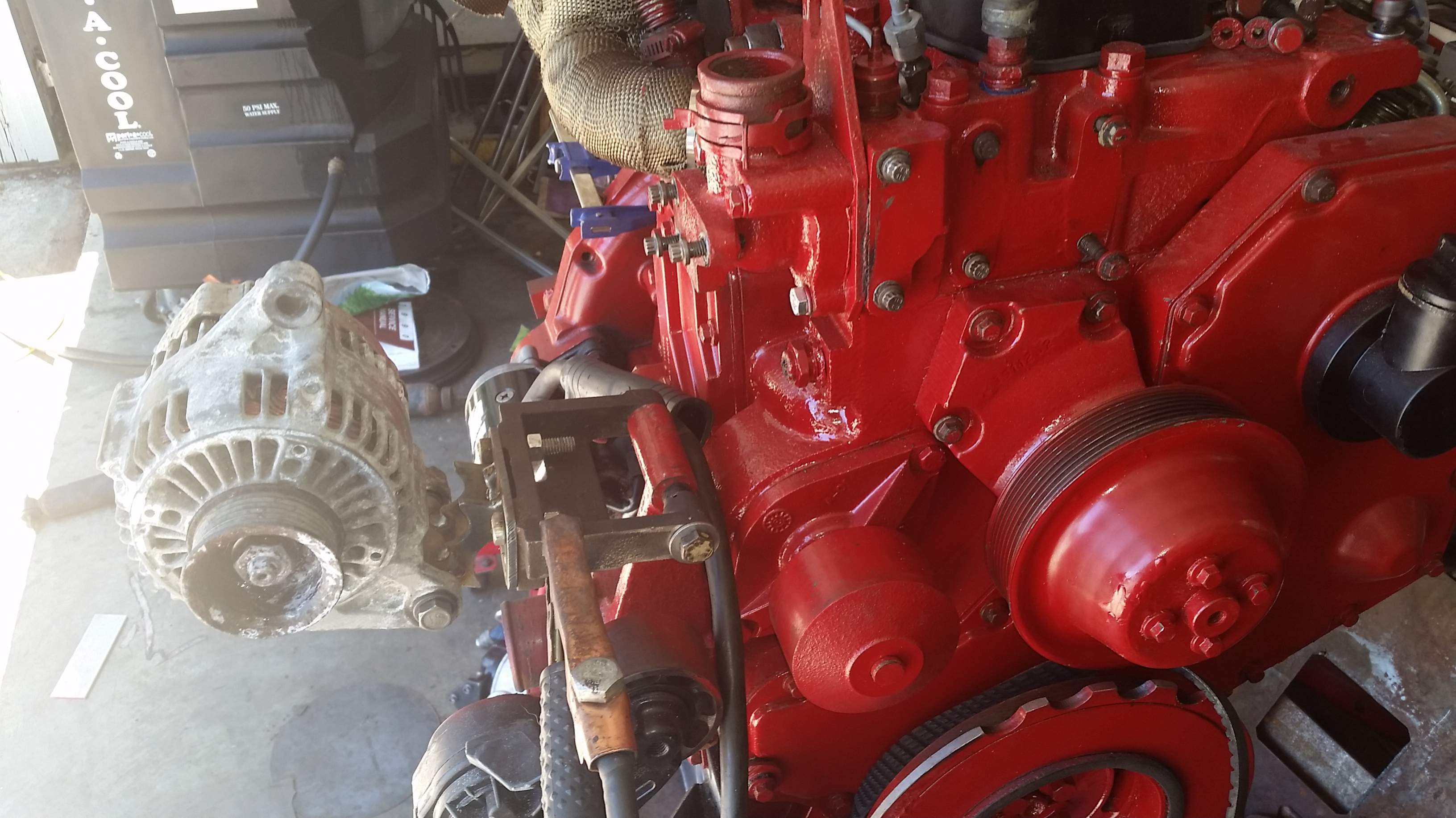

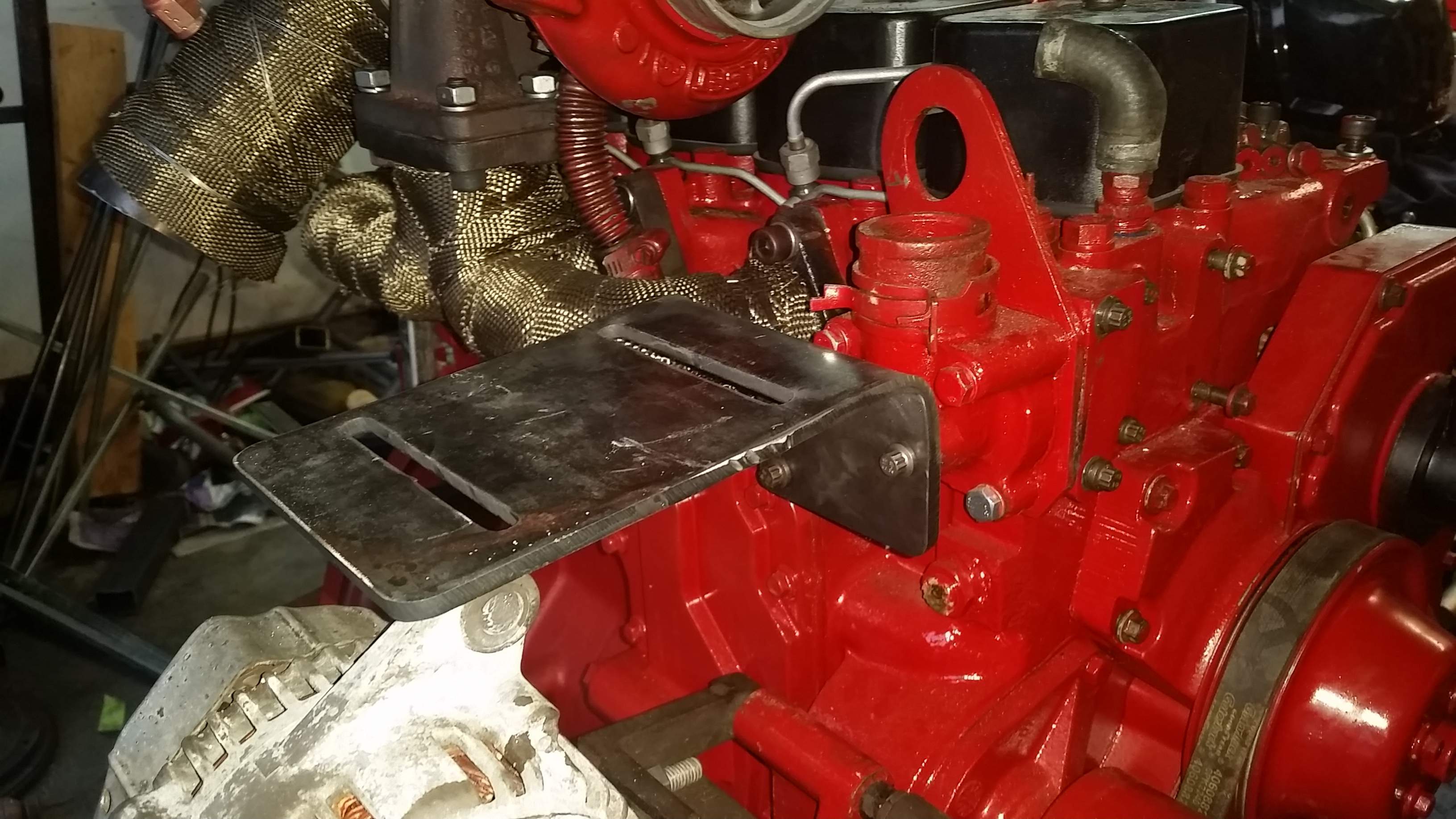

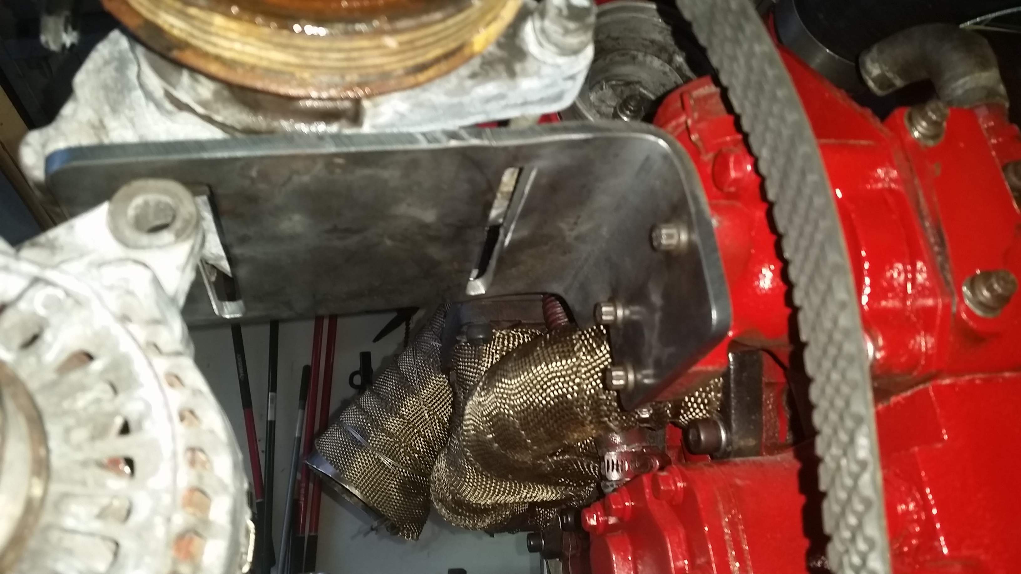

Jun 10, 2015 / 4bt cummins jeep tj Thread Starter #93 OP dzljon Advertiser Joined Jan 11, 2015 Messages 304 Location Jacksonville florida Tractor none Started building a alternator mount, the goal is to use off the shelf jeep parts Attachments 20150610_134511.jpg 421.5 KB · Views: 178 20150610_125201.jpg 802.4 KB · Views: 149 20150610_125133.jpg 441.2 KB · Views: 162 20150610_125124.jpg 376.7 KB · Views: 168

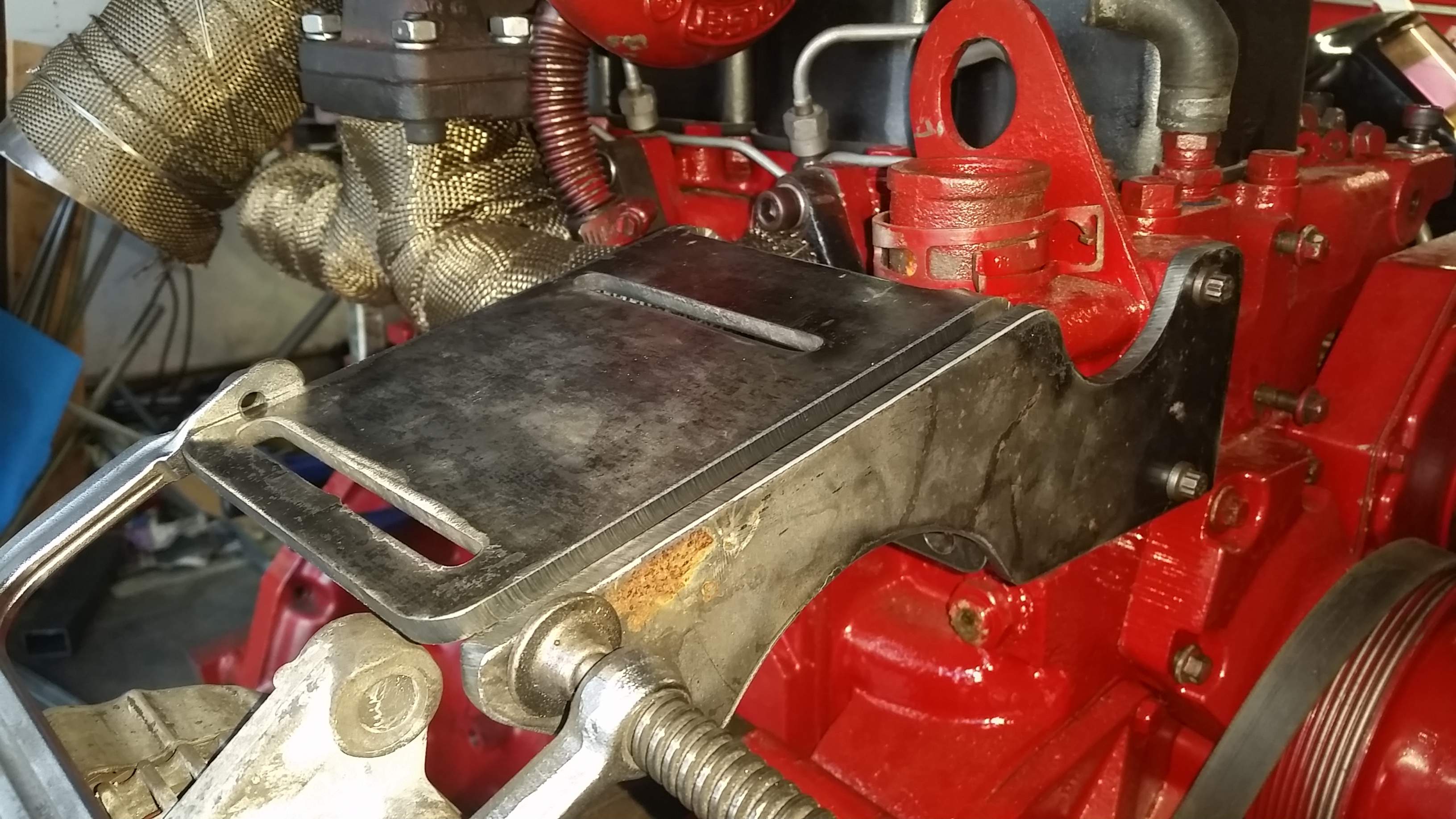

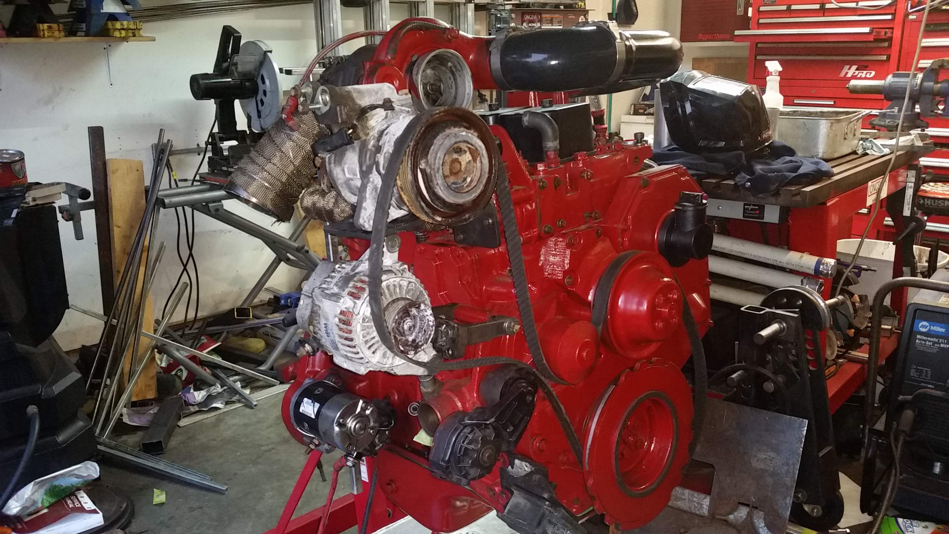

Jun 10, 2015 / 4bt cummins jeep tj Thread Starter #94 OP dzljon Advertiser Joined Jan 11, 2015 Messages 304 Location Jacksonville florida Tractor none Mocking up accessories Attachments 20150610_203241.jpg 548.5 KB · Views: 185 20150610_202928.jpg 455.6 KB · Views: 170 20150610_202916.jpg 356.1 KB · Views: 178

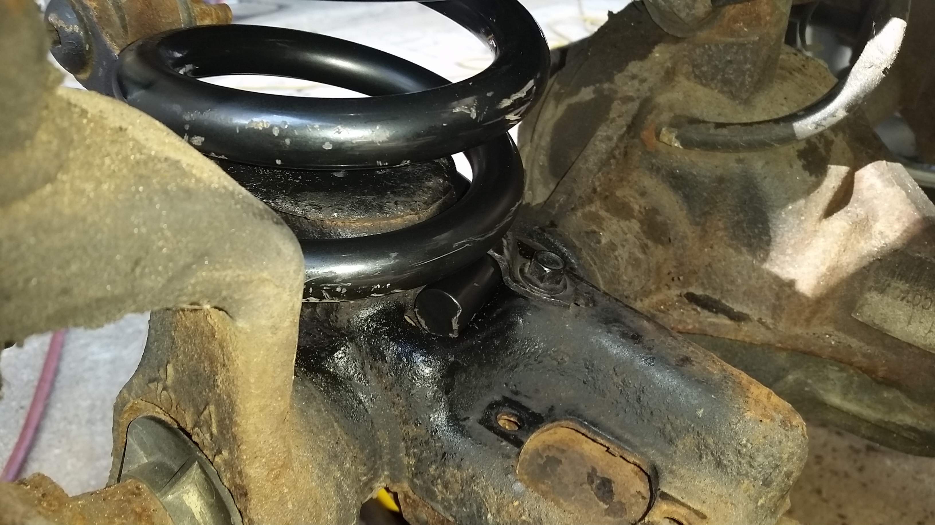

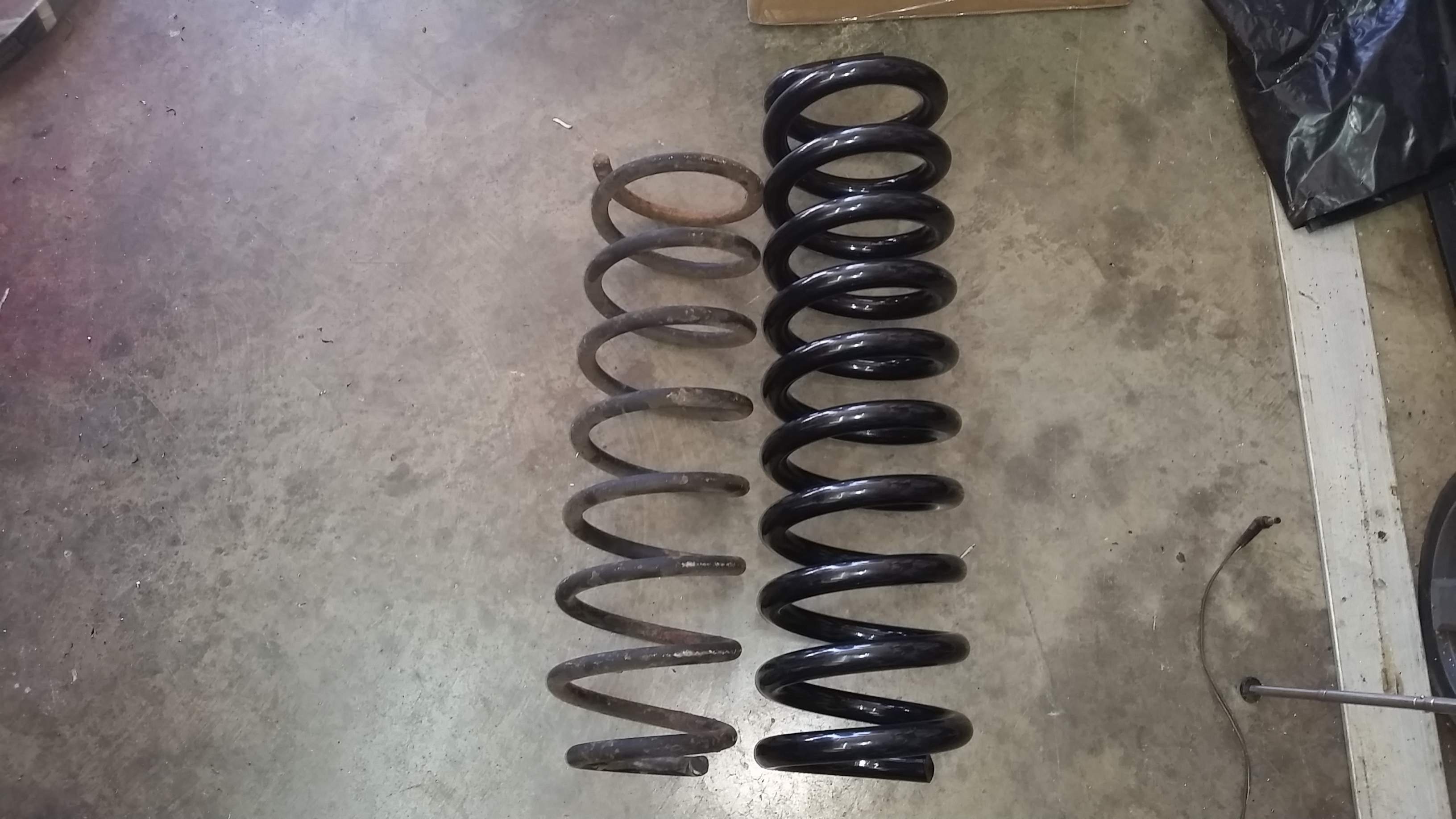

Jun 11, 2015 / 4bt cummins jeep tj Thread Starter #95 OP dzljon Advertiser Joined Jan 11, 2015 Messages 304 Location Jacksonville florida Tractor none Stock tj spring and the new ones to lift and support the heavier motor Attachments 20150611_154511.jpg 355.5 KB · Views: 179
Jun 11, 2015 / 4bt cummins jeep tj #96 wmonroe Elite Member Joined Nov 12, 2005 Messages 3,499 Location Southwestern, PA Tractor 1958 Ford 961 Powermaster Big difference in the springs.
Jun 11, 2015 / 4bt cummins jeep tj Thread Starter #97 OP dzljon Advertiser Joined Jan 11, 2015 Messages 304 Location Jacksonville florida Tractor none wmonroe said: Big difference in the springs. Click to expand... Yep, they are for a 1979 bronco

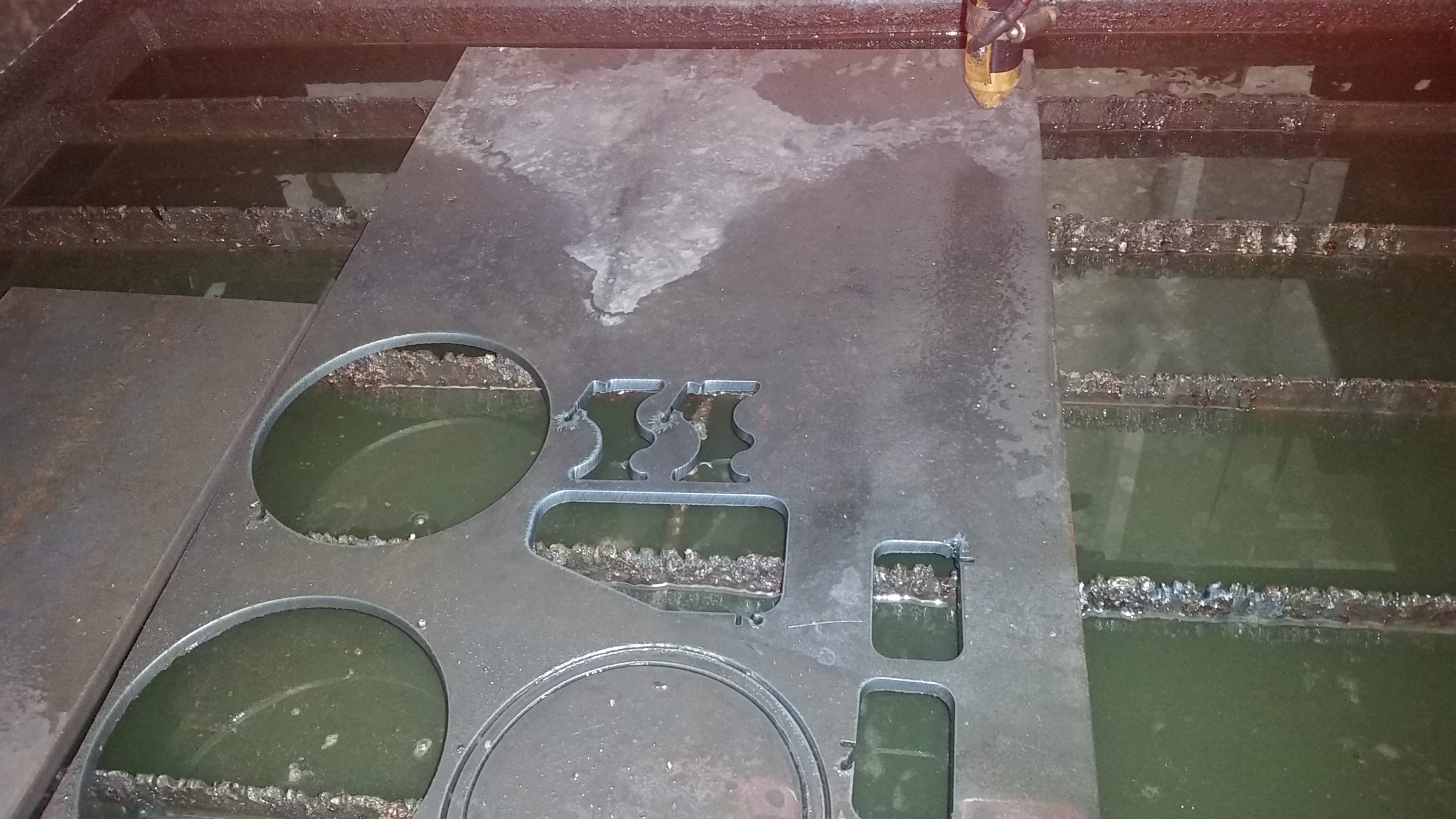

Jun 11, 2015 / 4bt cummins jeep tj Thread Starter #98 OP dzljon Advertiser Joined Jan 11, 2015 Messages 304 Location Jacksonville florida Tractor none Air con bracket progress Attachments 20150611_193817.jpg 355.5 KB · Views: 168 20150611_193751.jpg 493 KB · Views: 185

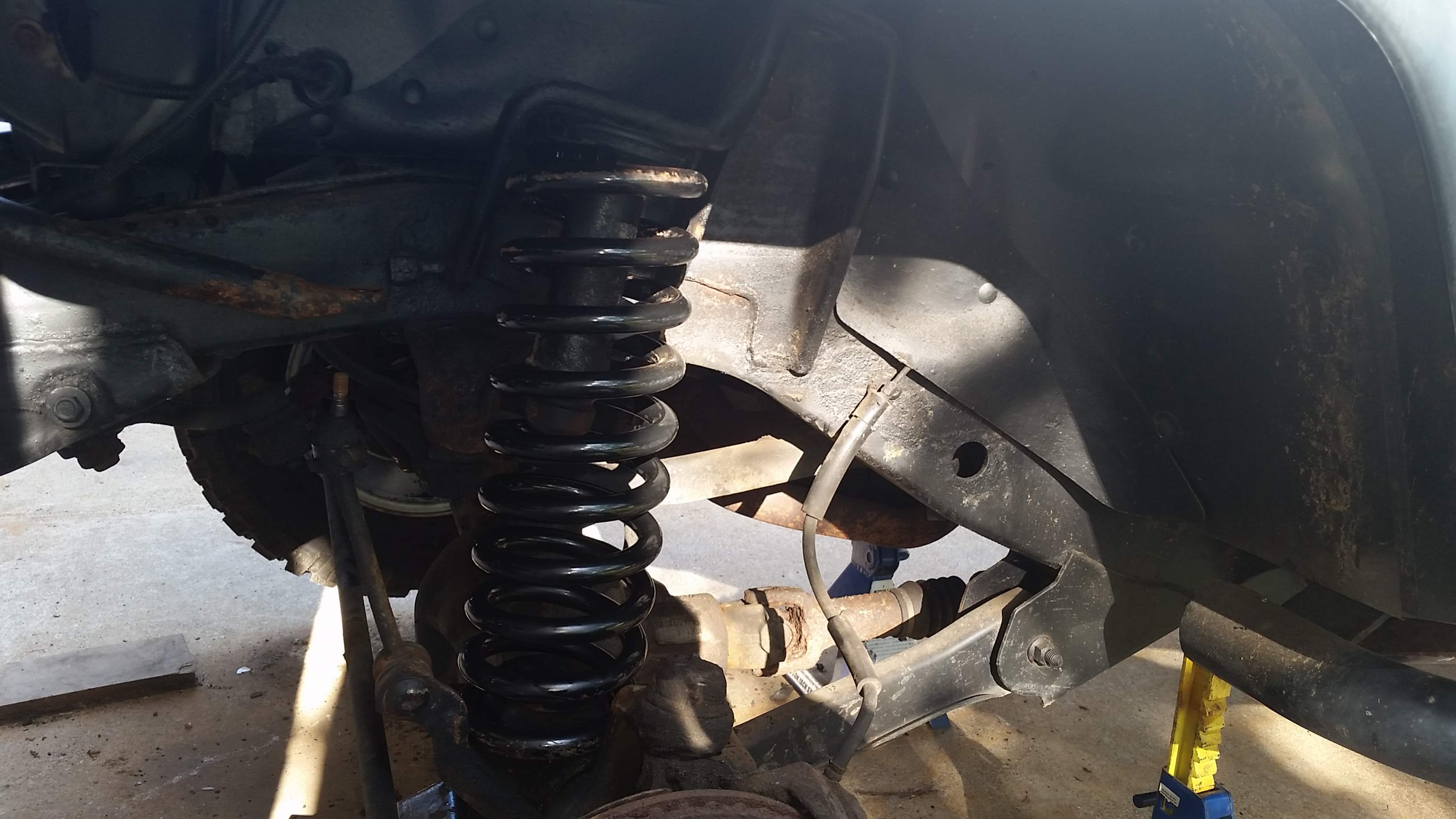

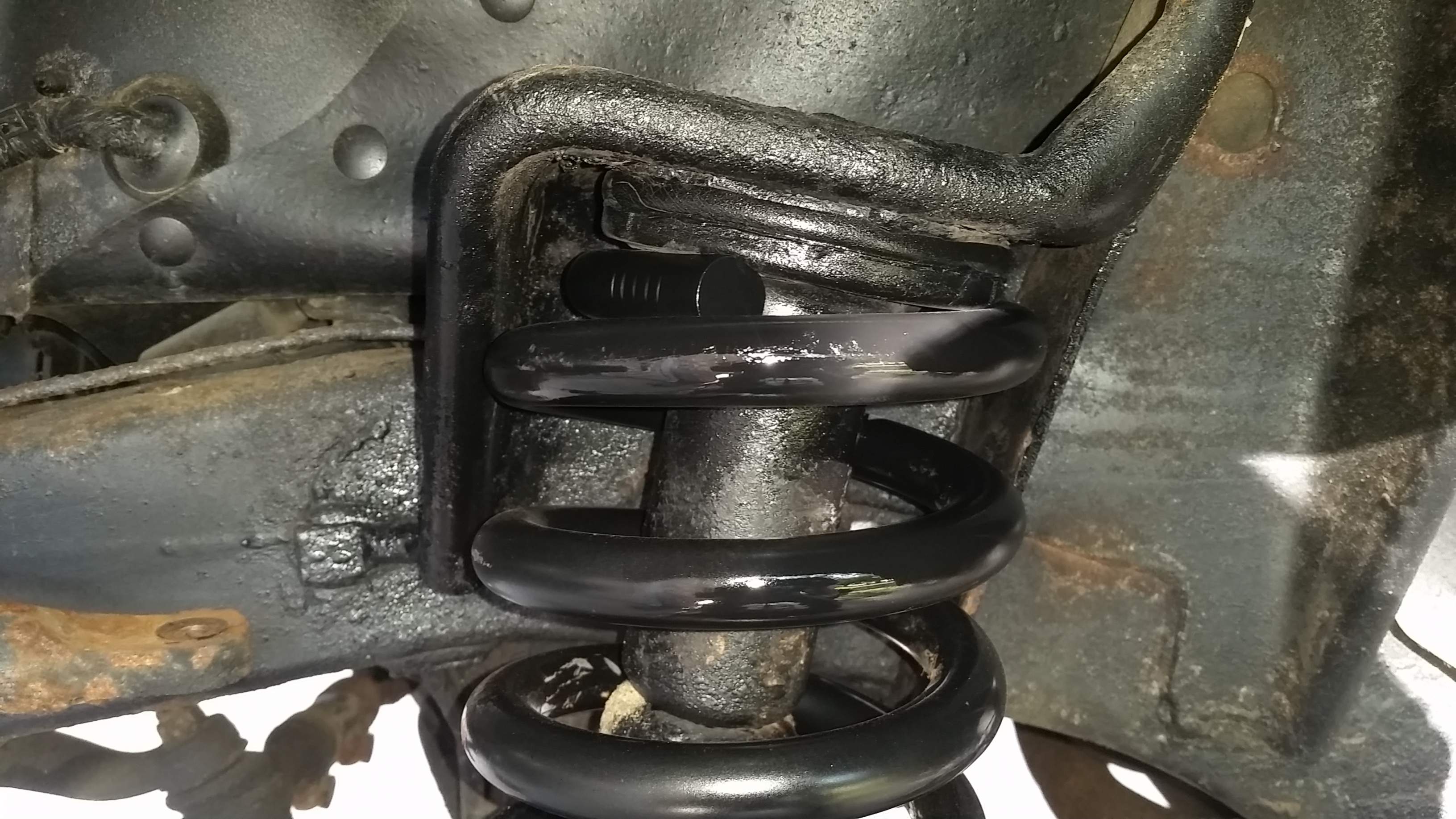

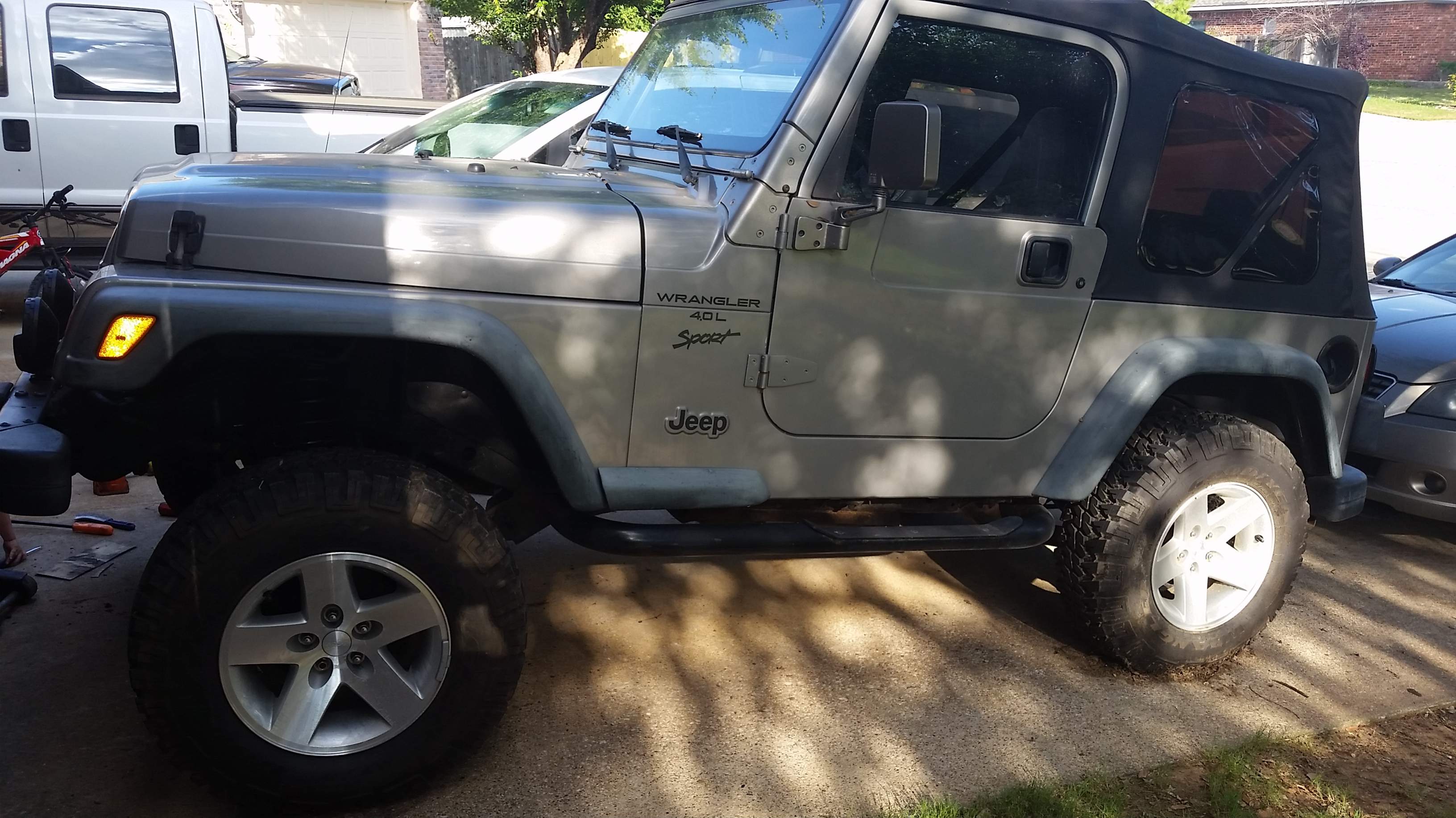

Jun 12, 2015 / 4bt cummins jeep tj Thread Starter #99 OP dzljon Advertiser Joined Jan 11, 2015 Messages 304 Location Jacksonville florida Tractor none 1979 bronco springs installed in the tj to lift and support the added weight Attachments 20150612_183244.jpg 514.7 KB · Views: 249 20150612_181307.jpg 461.1 KB · Views: 179 20150612_181300.jpg 501.2 KB · Views: 193 20150612_181229.jpg 375.5 KB · Views: 197
