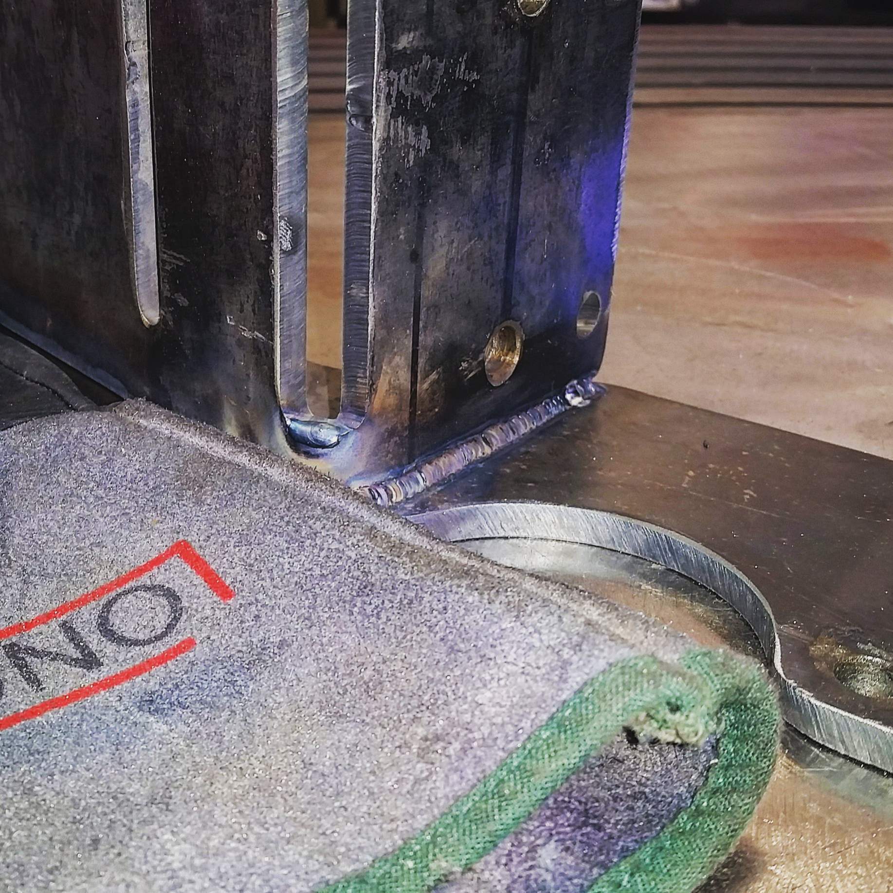

#103

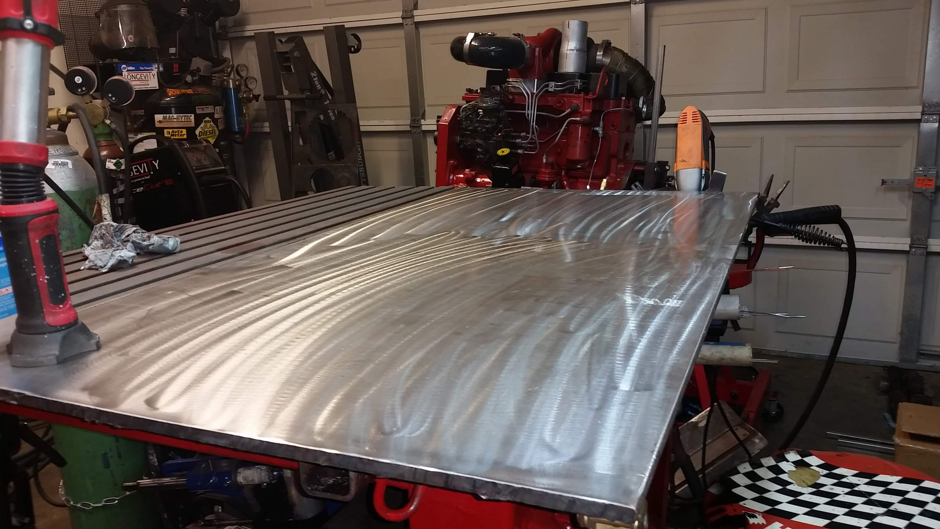

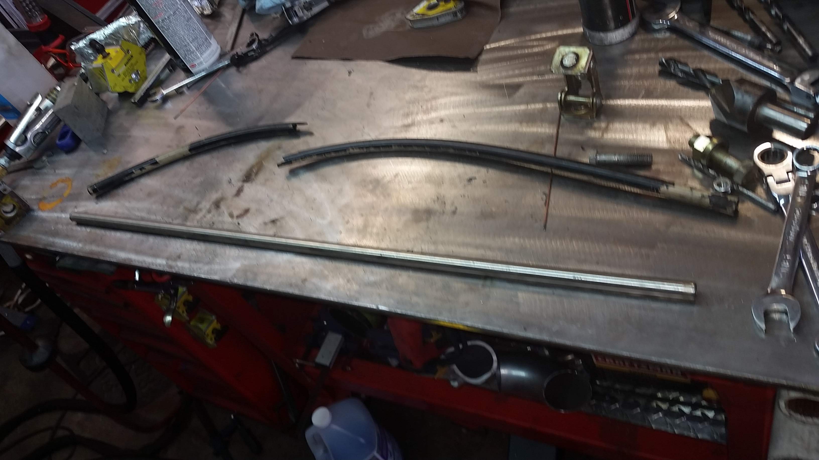

Started welding the bracket

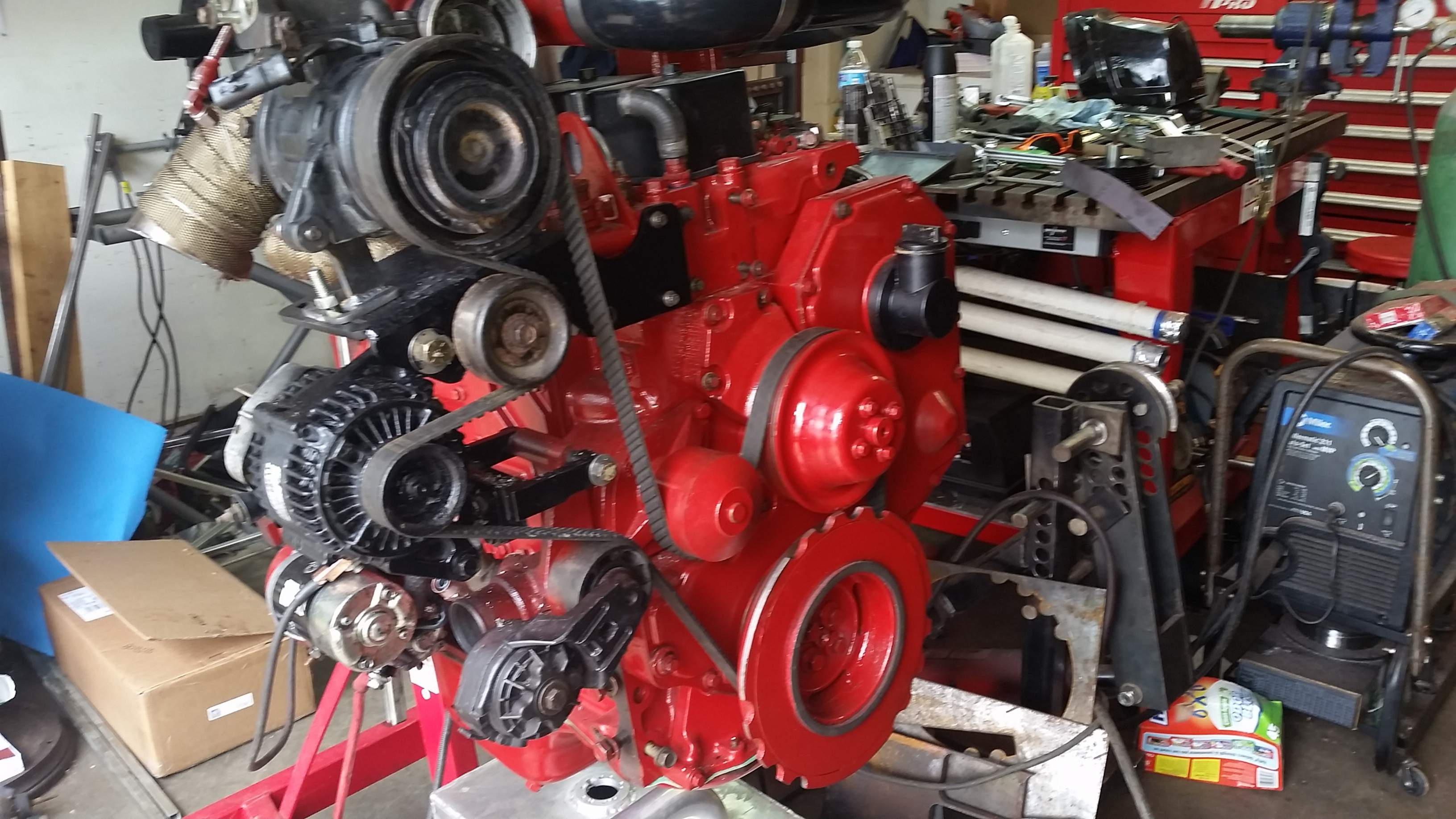

#106
Factory jeep alt, ac comp and drive belt fit and are tight

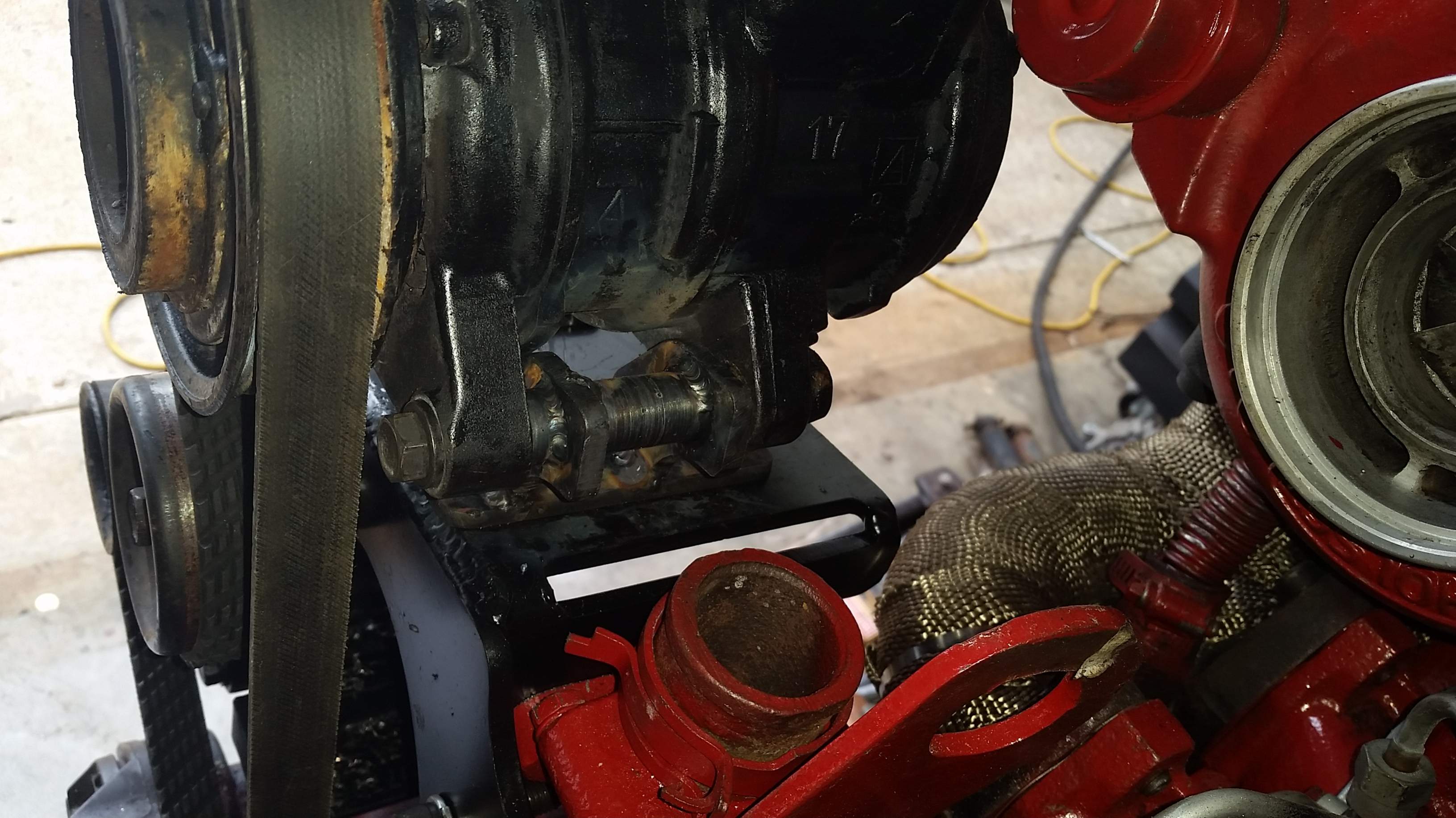

Here is a closer look at the air con compressor mount that is not completely done

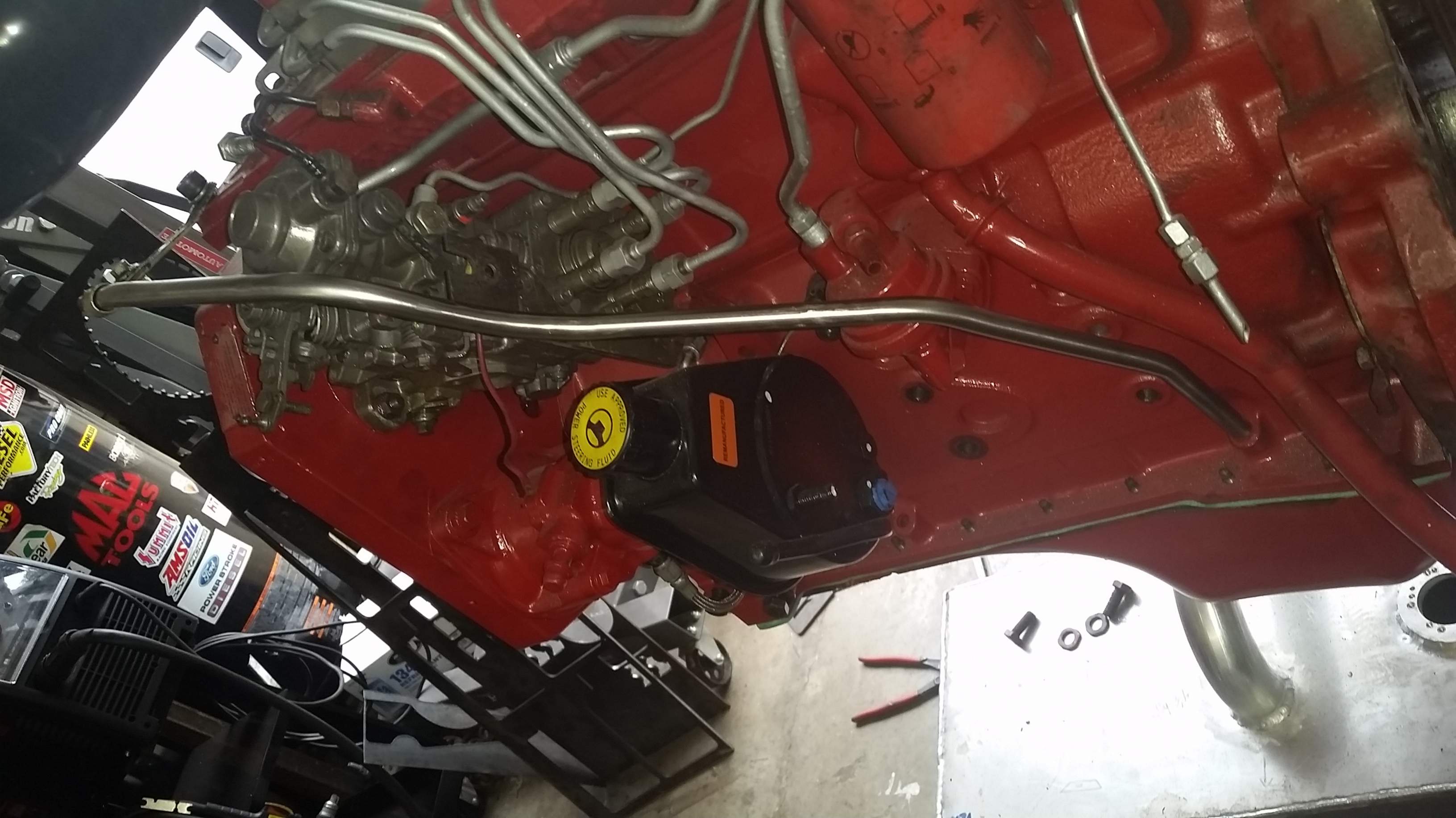

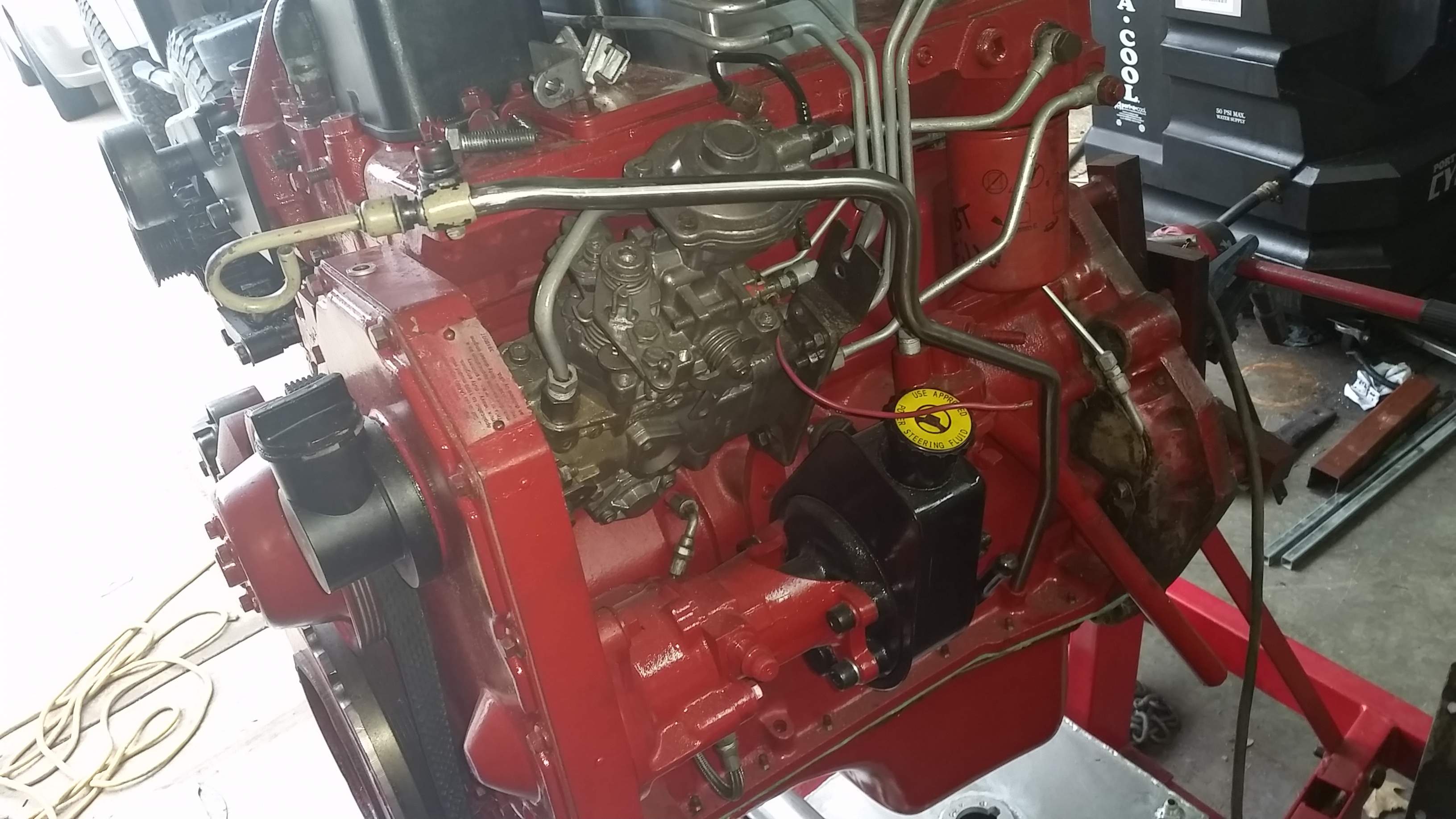

I broke the dipstick shroud so I replaced it with stainless steel
