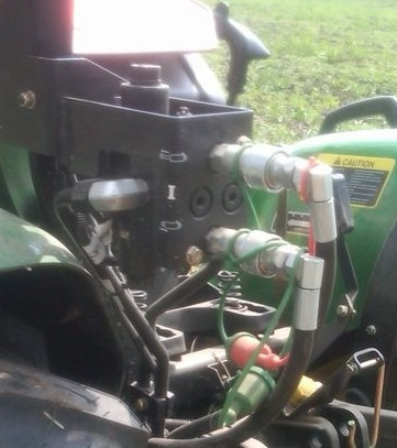

Can anyone tell me how to relieve pressure in my 3rd function (grapple) lines. There are times i cannot unfasten the quick connect couplers when i want to remove the grapple. My prior tractor had a bleed valve for these lines. Moving my joystick with the engine off relieves the pressure in the lift and curl lines - but not the third function.

I see you have a JD4105. Same tractor I referenced above with the valve for 3rd function pressure relief. My 3rd function used a rear remote which was routed under the hydro pedals with electronic thumb control on my joystick. To relieve the hose pressure, I loosened the small valve on top of the rear remote mount. I was very happy with my 4105. When the grapple was removed, I could use the rear remote for another application such as hydraulic top link. Now I have 3rd, 4th and 5th SCV.
