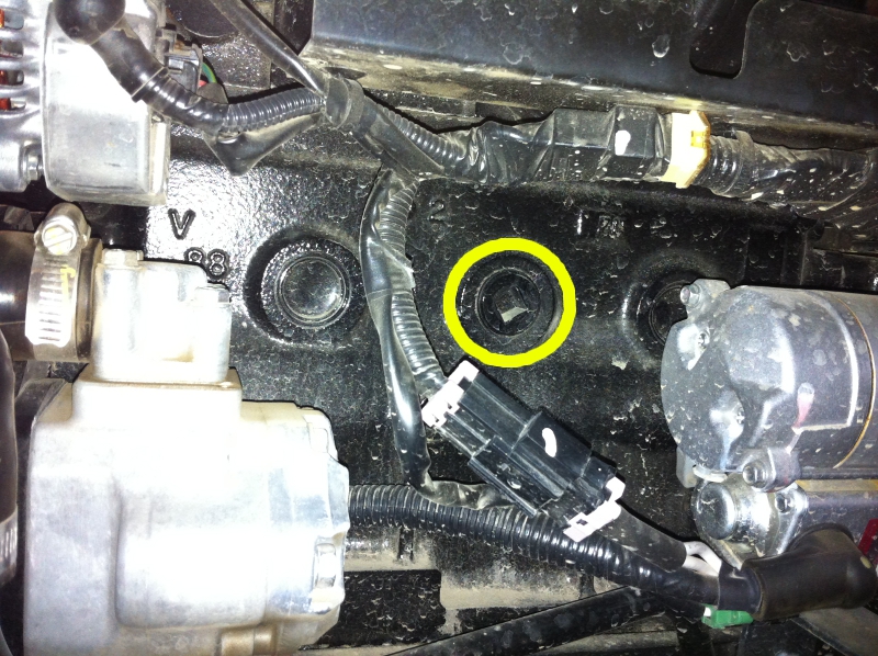

I was wondering if anyone had a lead for an engine block heater that fits a Yanmar 4tnv88 engine. I'm looking for the screw-in type to go where the plug is circled in the picture. I know these exist for Yanmars, I just haven't see one marketed to fit the 4tnv88. Thanks!
   / 4tnv88 Block Heater #2
I don't have a definite answer but I believe the ones made for the 3 cylinder Yanmars have 1" npt threads. I know Hoye lists theirs as appx 1-1/4" threads. I also read these plugs can be very difficult to remove and was suggested by one dealer to remove the plug before ordering the heater. My understanding is they have a 1/2" square opening for a breaker bar. If your hole measures appx 1-1/4" I suspect it would fit. Proceed with caution! :)
Yep, the plug was wound in there pretty good. I ended up putting about a minutes worth of propane heat on the plug then tapped it with short bursts from a 1/2" air impact wrench until I saw the plug move. I was then able to easily back the plug off half a turn with a 25" breaker bar, and it does indeed appear to be 1.25 inch plug. Now to get a heater ordered, thanks for the info!

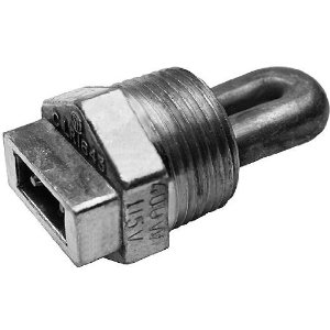

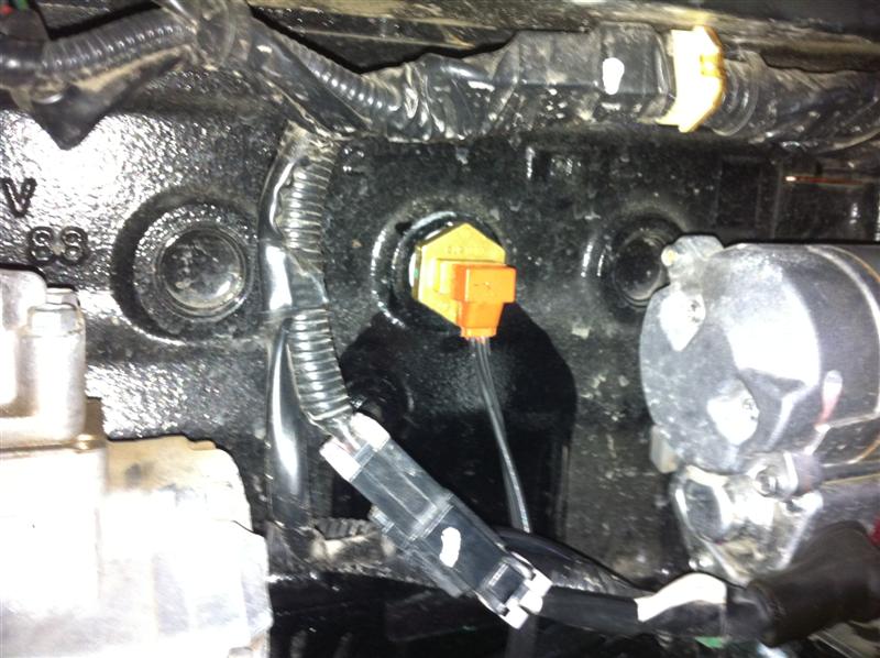

Finally got it done, it was actually a 1 inch NPT plug. The plug measured about 1.29" while still threaded into the block using my calipers, so that threw me off a little, but that's about what the outer diameter of 1 inch pipe is (1.315 to be exact).
I never did find a block heater maker that listed the 4TNV88 engine, but I looked at the Zero Start catalog and saw that their #3100003 model fit both 3 and other 4 cylinder Yanmar engines so I took a gamble that was it. #3100003 fit perfectly and I only lost about 8 ounces of coolant when making the swap as I didn't want to bother with draining the block.

Welcome and that looks perfect fit on that engine you will really like it when the temp gets low! :thumbsup:
