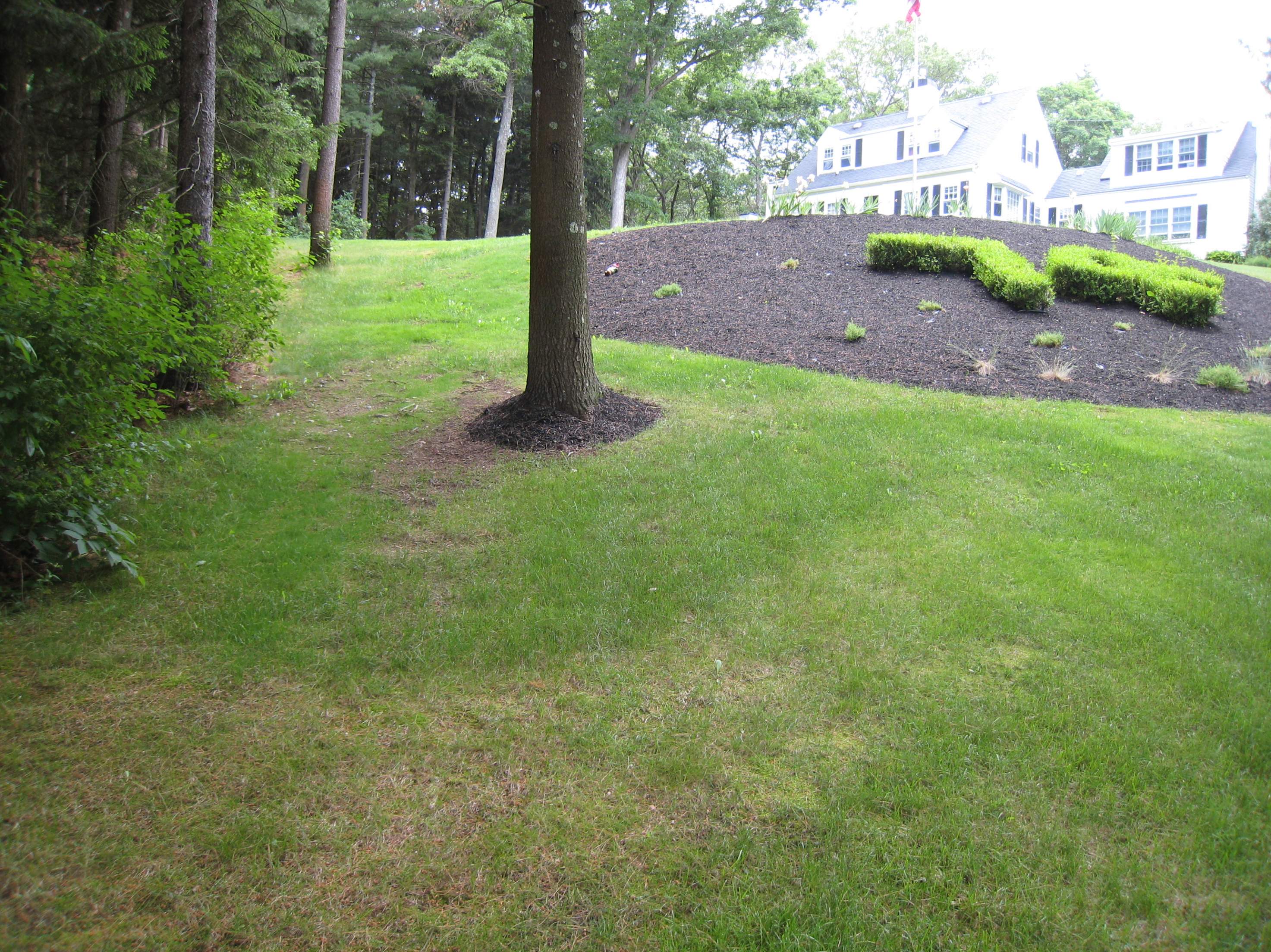

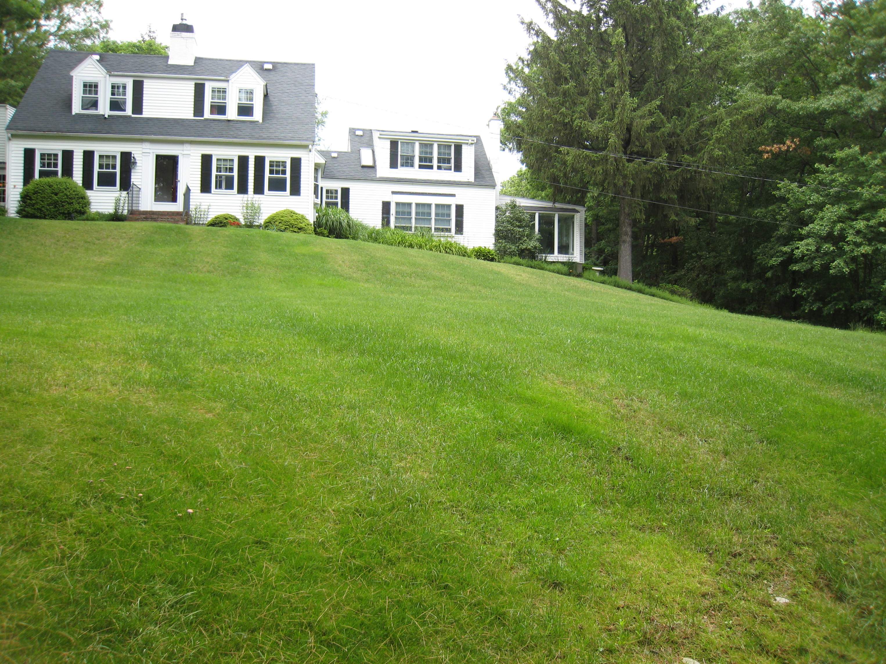

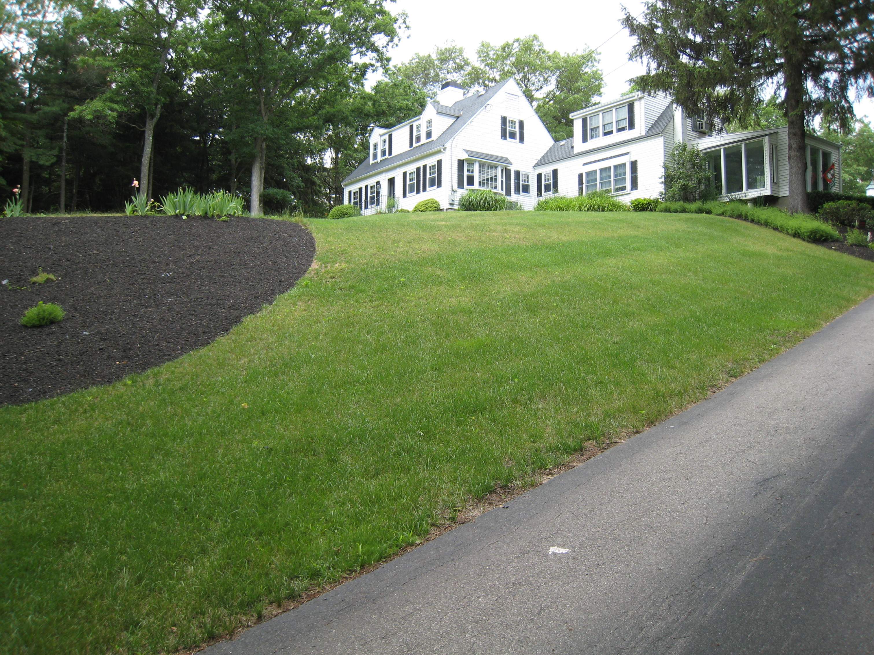

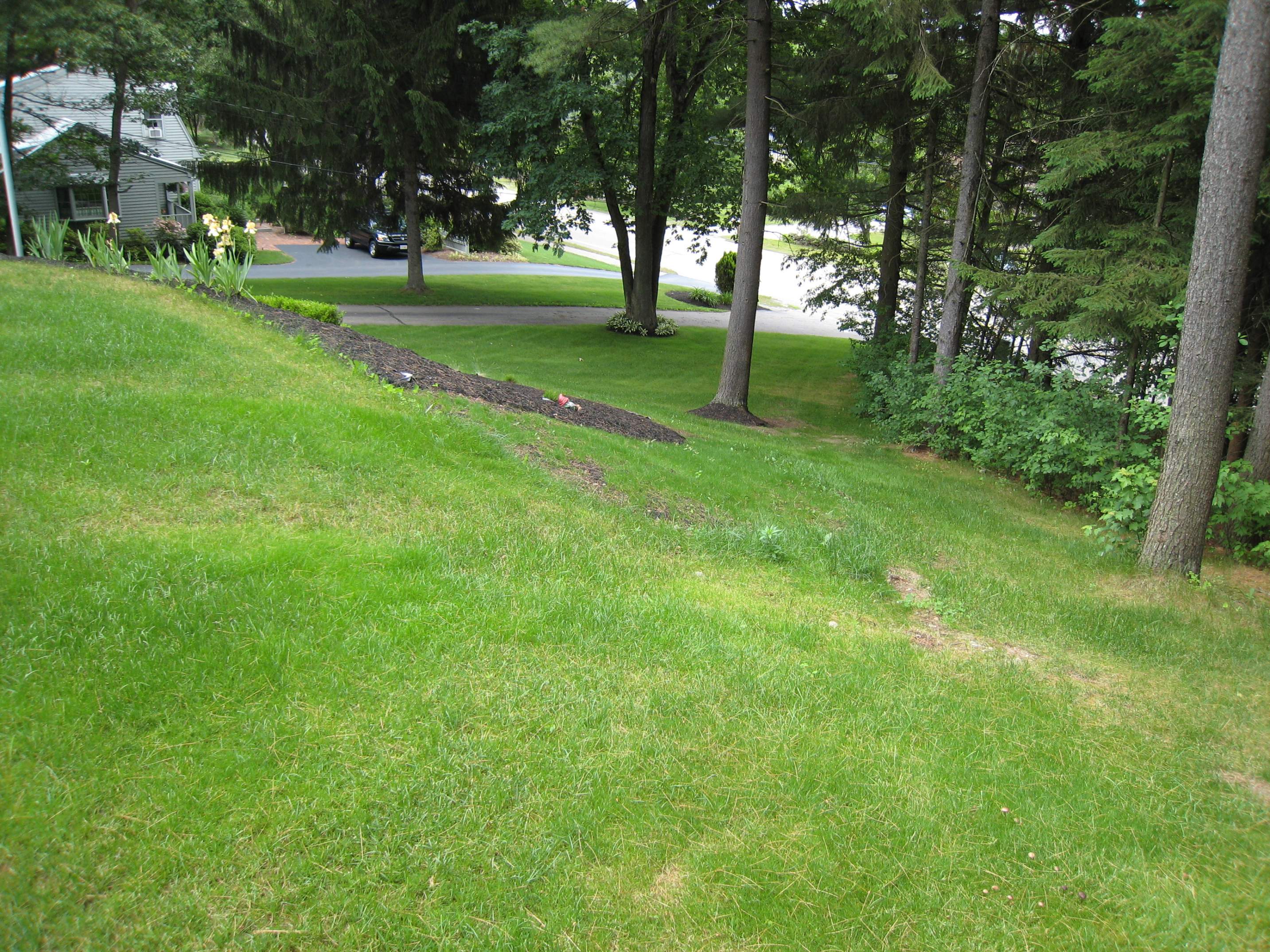

Taft - Seems like I've misread your equipment - thought you own a typical zero-turn mower, but I now see it's a ZTT. I'm quite surprised it's giving you issues on slopes, mine is very stable on side slopes. Perhaps you have REALLY steep slopes! I've never tipped mine over, but I'm leaning so far on in the seat the safety switch is activated a few times.....:laughing: and, before I had thick grass the whole tractor would slide sideways down the slope, so I would have to turn into the slide and drive out of it.
In your particular situation, you could try the fluid filled tires, but something like the X749 might suit you better, they are nice machines. Any pics of your slopes?

Here are some pics that I brought with me when I bought my ZTT1046 in 2008.
