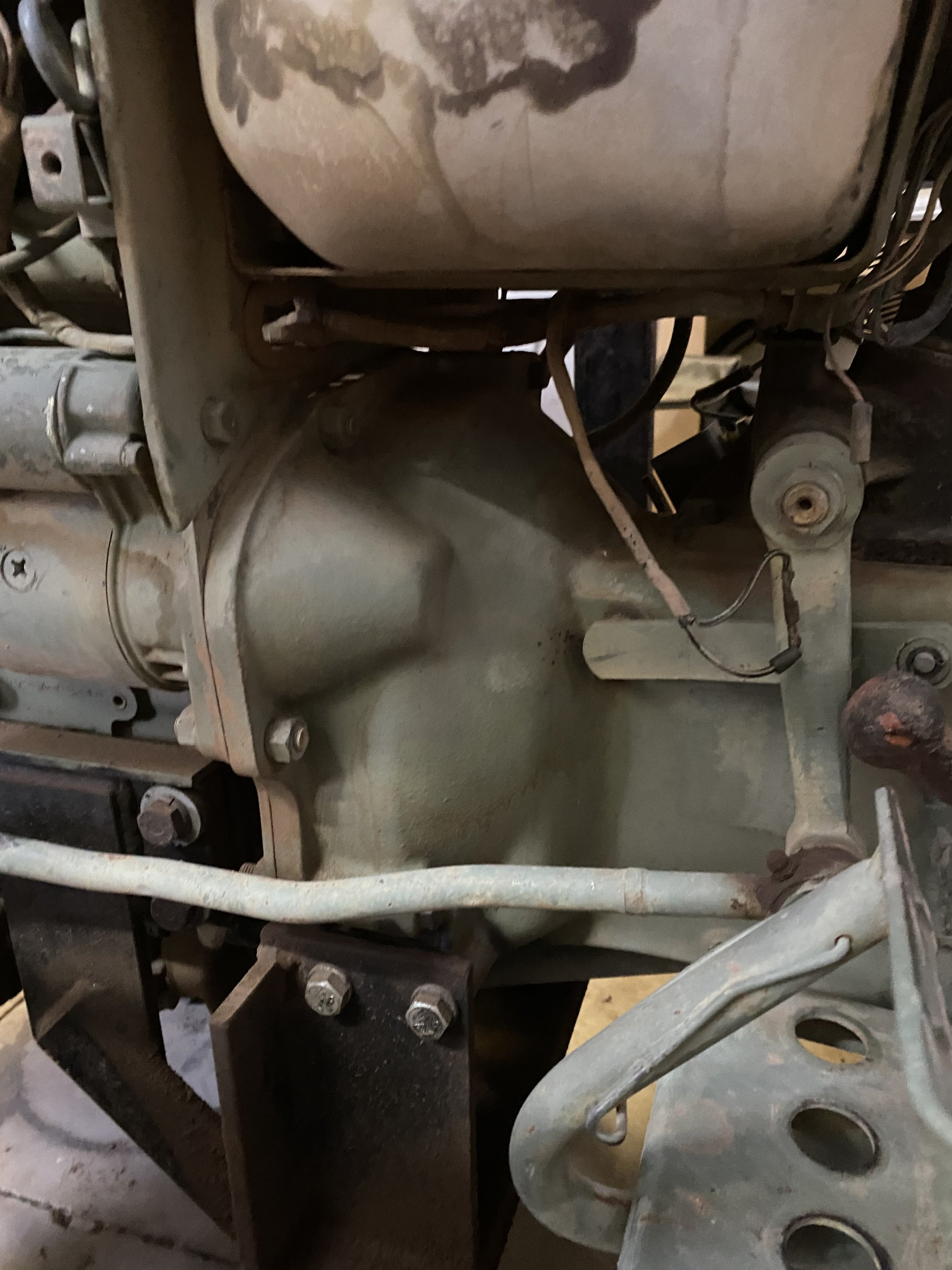

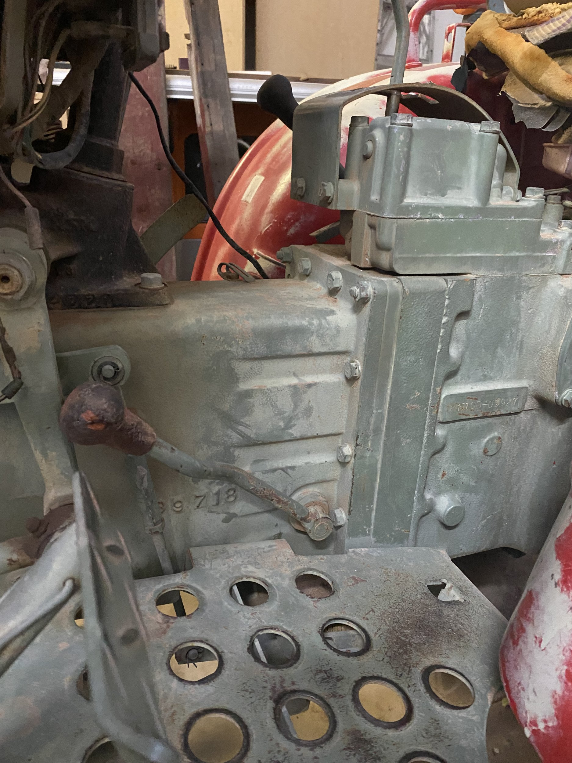

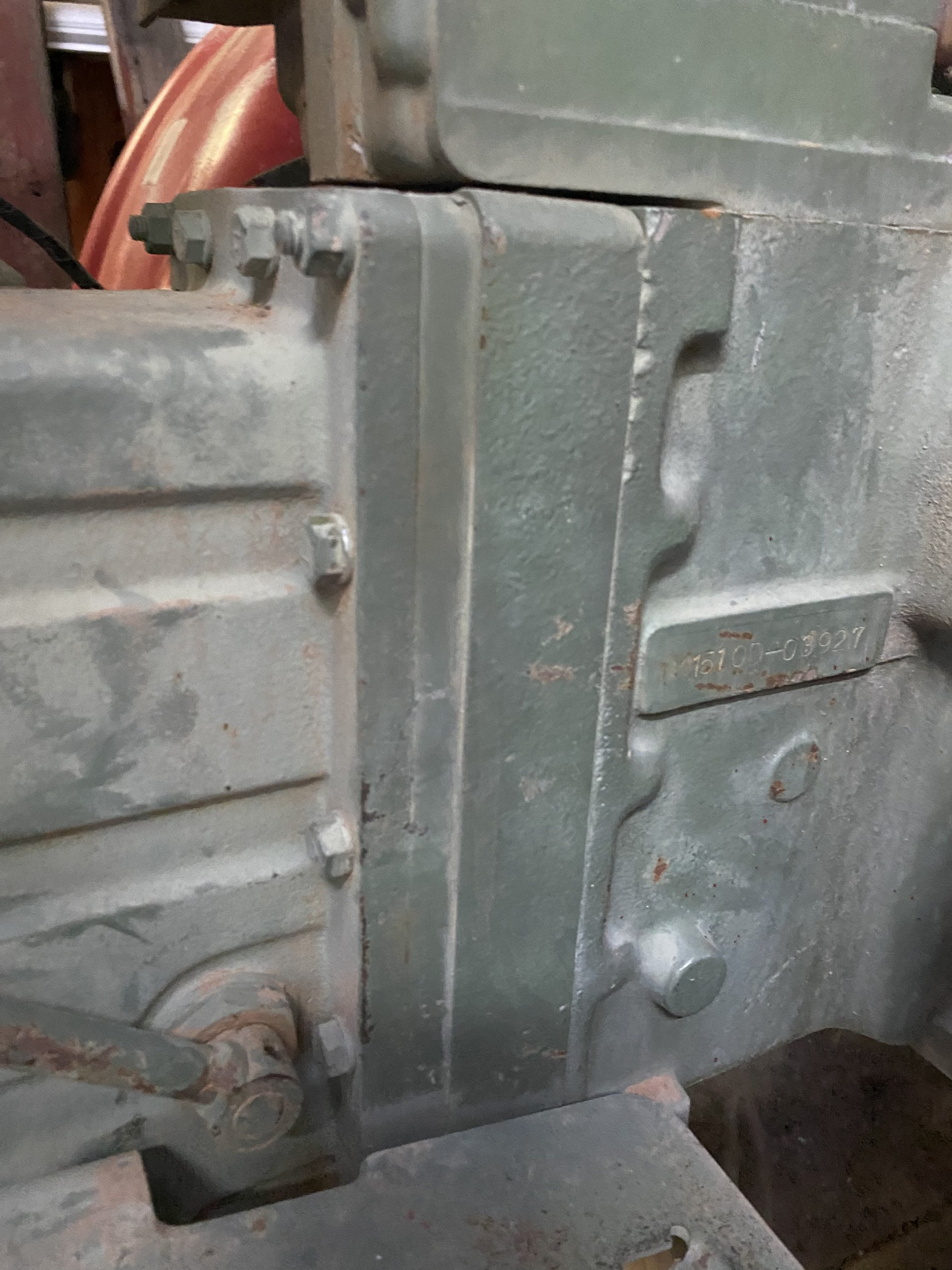

I have a Yanmar YM1510 D. This thing is awesome! I’ve had it for just a little under a year and have used it for all sorts of different things despite the front wheel assist not engaging. The shifter you use to engage the four-wheel-drive moves freely and I don’t feel it ever engage. In reading other posts on this forum it sounds like that is likely one of the pins has sheared off. Two questions I have:
1) does that sound like the likely issue?
2) In order to replace it do I have to split the tractor? If so, see my picture. Would I just split it right behind where the four-wheel-drive shifter is? Or would I split it a foot and a half further up where the clutch is (I included a picture of this spot also for reference)? I watched a hoye tractor video of them splitting a tractor to replace a clutch.

If I were going to split I would splitwhere clutch housing bolts to motor. May have to go further, but that would be my starting point. I guess you have this drawing. 4WD_SHIFTER: Yanmar Tractor Parts
Thanks for the response. Do you suggest splitting there due to familiarity? Or why do you suggest that?

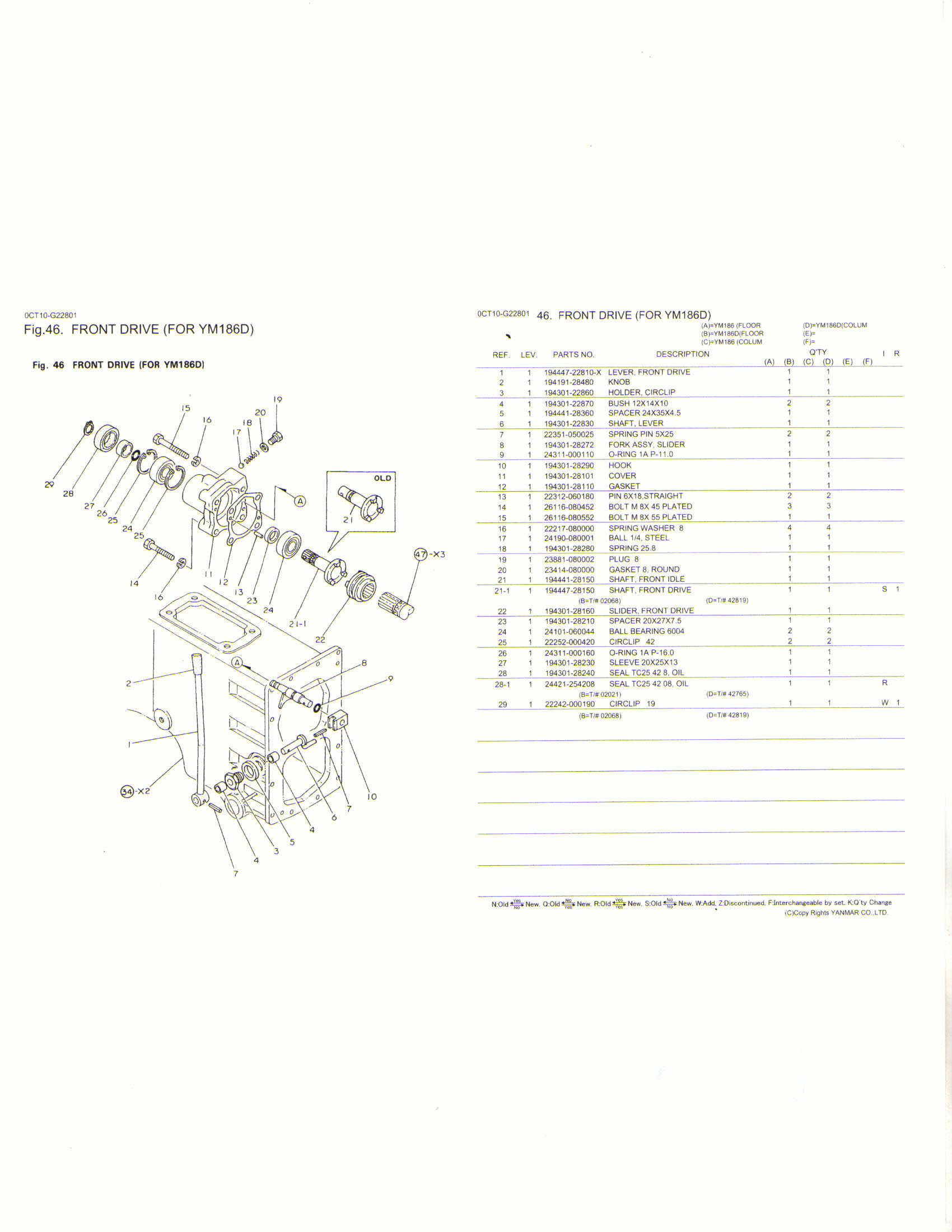

Here is the drawing for the 186, very similar to the 1510. Not sure either of these is going to have easy access to get to that linkage.

Have you visually confirmed the shaft is rotating with the lever.
/ 4wd not engaging - ym1510d
I got underneath the tractor and could see the linkage is moving with the lever. You have to look through the drivetrain and everything. I’m not sure yet if I’ll be able to access it without splitting it or not. I’ll try to video it when I do it so I can share it.

On the YM186D you can replace the four wheel drive shifter without splitting the tractor.
In the picture that winston1 posted, you can see the large nut #3, unscrew it and the shift linkage all comes out except the block #10, which is on the shaft #8.
Thank you for posting that description! Repairing it sounds reasonably simple.
I vaguely remember a post long ago where he repaired the inner tip attached to that horizontal shift rod, or something like that, and he had accessed it from beneath the tractor.
You need to drain the transmission before taking that rod out, no?
Hope I never break that.
/ 4wd not engaging - ym1510d #12
Alrighty then. The nut on the 1510 and 186 is the same (194301-22860) so all should come out on the 1510 if it will come out on the 186.

So I’m trying to take off that nut as suggested. Can’t get a wrench in there in it. So I pulled the spring pin to pull the lever off, then I was going to put a socket on that nut and take it off. I can’t get that lever off. Any suggestions?
So far I’ve tried:
- grabbing and pulling with pliers
-sprayed with liquid wrench
- heated up with propane torch and pulled
My next though was to cut off the lever short enough that I could get the socket on the nut then I’d either buy a new lever or weld the lever back on. Thanks for everyone’s input so far.

High heat and penetrating fluid, or candle wax. You might try tapping it when it is warm and you have the penetrating fluid on. MAPP gas if you have it. You want it to get hot as fast as possible.
Do you have a gear puller that would fit?
I wouldn't worry about the nut until you have the lever off.

Had a friend come over and he put a long pry bar in there and wiggled it off in less than 3 minutes. It was slightly disappointing to me how easily he got it.
Got the broken pin out and I’ll see if hoye has any used ones otherwise I think we might be able to weld it back together. We pushed the lever inside with a screwdriver and jacked all the wheels up to confirm the four wheel drive is now working. So glad I didn’t split it apart like my initial thought was to do. Should be pretty easy from here. Thanks everyone for your input.
