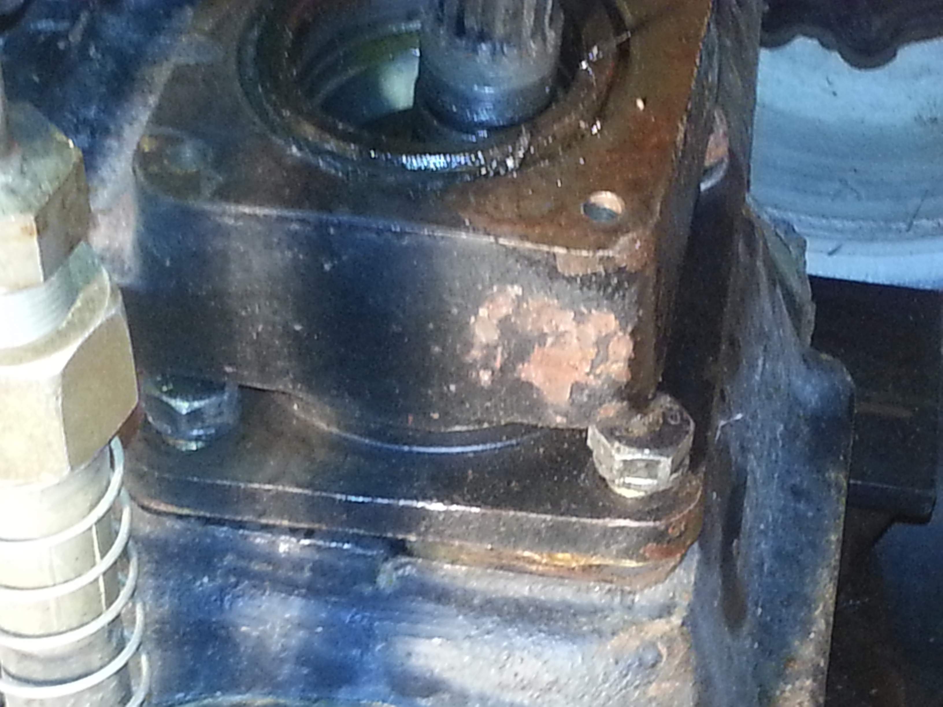

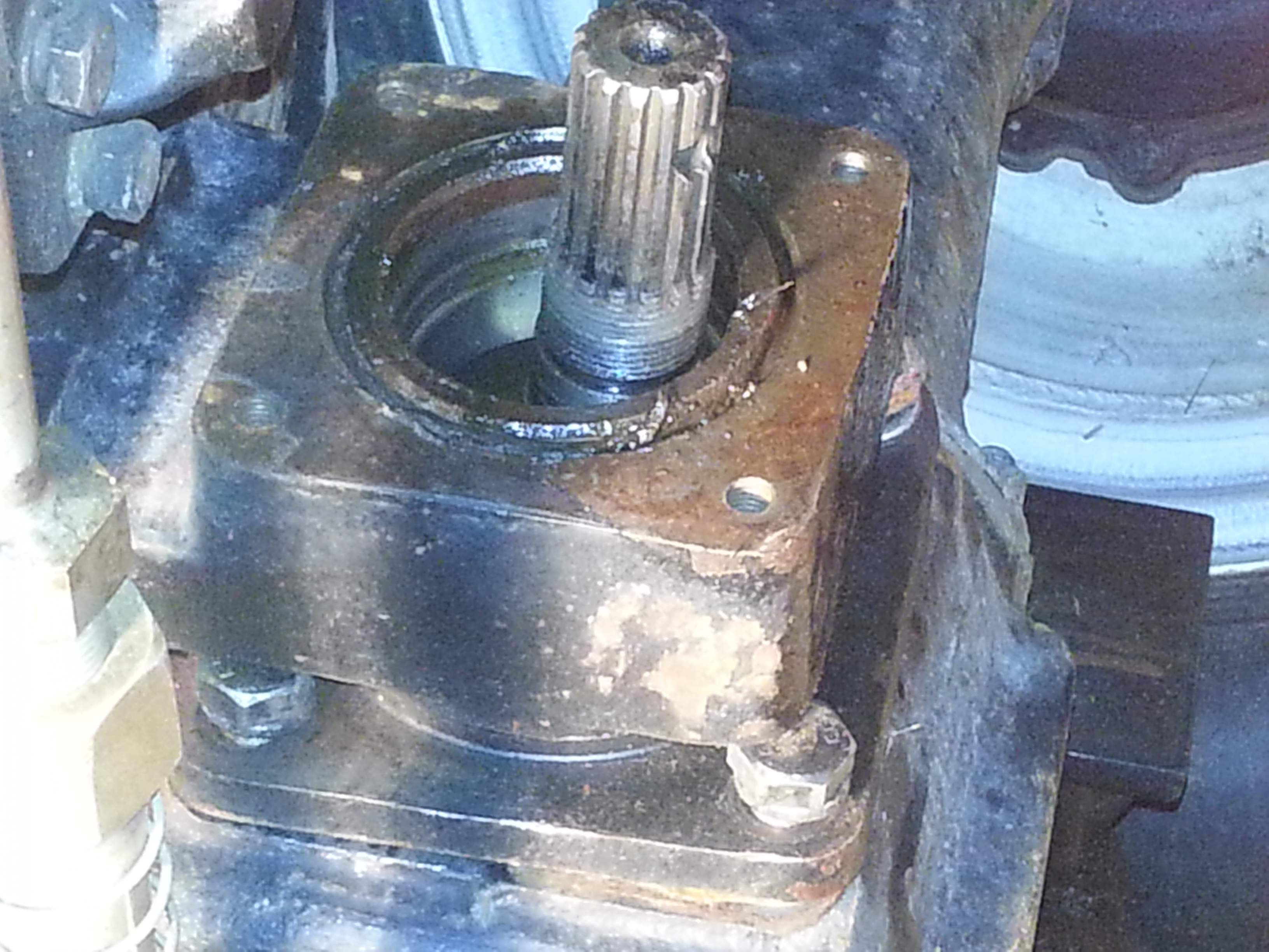

I finally found that the piece will come out but it is sealed to the frame. Where the two bolts attach to the frame, it is cemented in place by heat, paint, dirt, rust. So i need to break it free. But it will not take hammering or pole with sledge to come free. It is locked. I can only think of three things, use a cutting blade to cut between the two peicesed in places that I can get into, Use a concrete air hammer with blade and cut it apart, or drop the front axel and use its weight to separate them. I have heated it with a sauder torch.

I pulled her into the garage to get a closer look at her. Figured it would take some time. But once I got her into a warm place and I lifter her up. She gave it up like a prom date.

I got the bolts out and pulled the shaft out. I was getting mad the shaft was find. No damage at all. But then I turned the big gear and noticed that 184.31.187 Diff side gear was missing at least one tooth missing. Is this my problem? Or could there be more of a reason?
   / 4x4 went out when put on rear dif lock #35
Could be, but equally important is where the missing tooth/teeth have gone. They pose potential interference problems all by themselves. Next step would seem to be removing the pumpkin cover. If I'm not mistaken, that involves dropping the whole front drive assembly to the ground.
