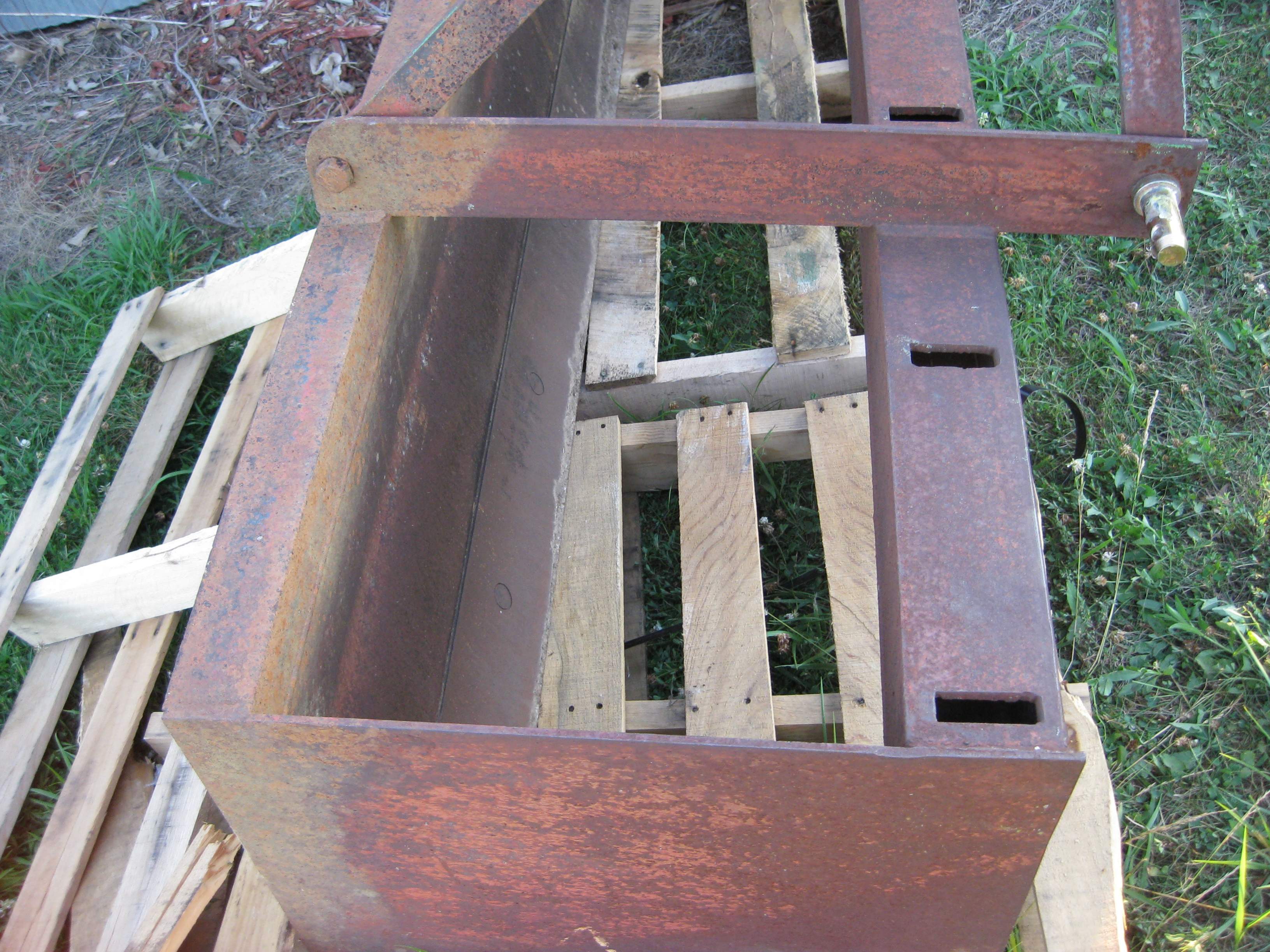

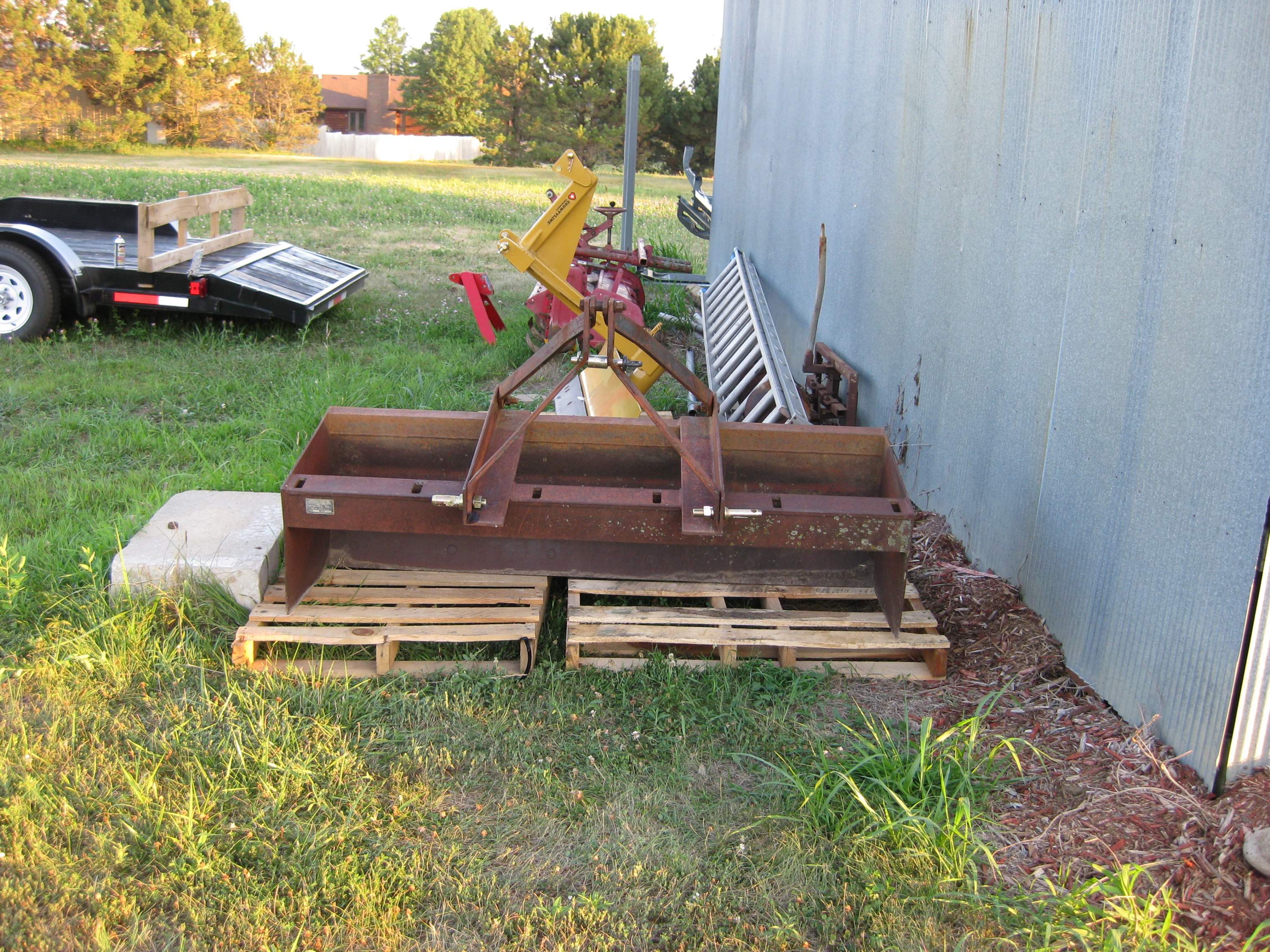

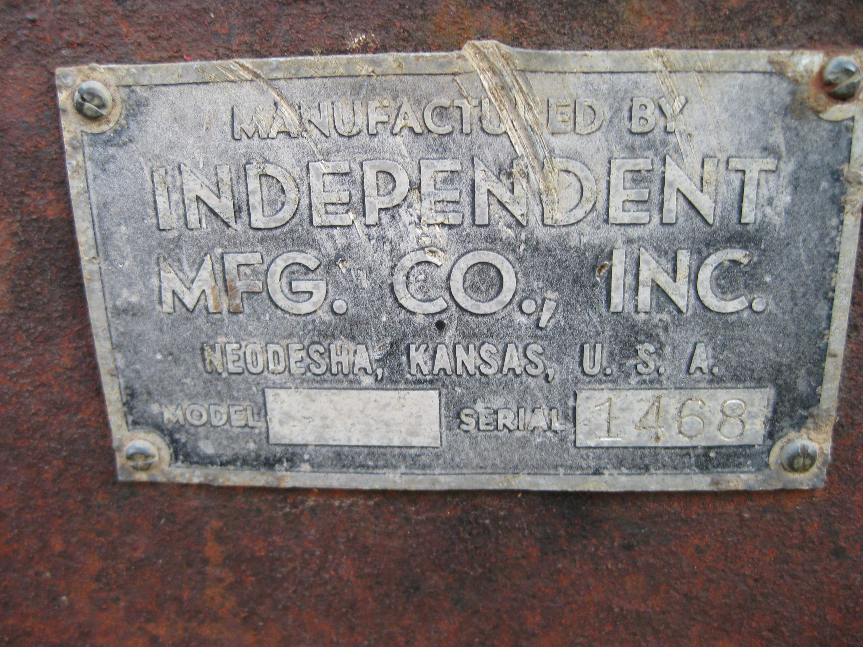

I finally got around to posting photos of the 5.5 foot box blade. I guess I shouldn't have taken the seller's word on how easy it would be to find ripper shanks. How do I know if I need the type with front notches or rear notches? Does any one have a good lead on where to source some?

It looks like you need the ones with no notches. The problem is going to be how to secure the ones from Agri Supply if that is your choice.
Your box blade will need "keepers" welded to each side of the slots for a pin to go through. Otherwise the shanks will just slide up and down when you try to do work with them.
Bent re-bar, some oversized nuts, or specially fabbed pieces of metal with holes are necessary. Then the pin (which will also have to be purchased) can go through the shank and the "keepers" on each side of the slots.
If you don't weld or fab you'll have to find a neighbor to do it. Oversized nuts that the pin will go through would be the easiest and quickest. It doesn't matter if the pin rattles around a bit.
