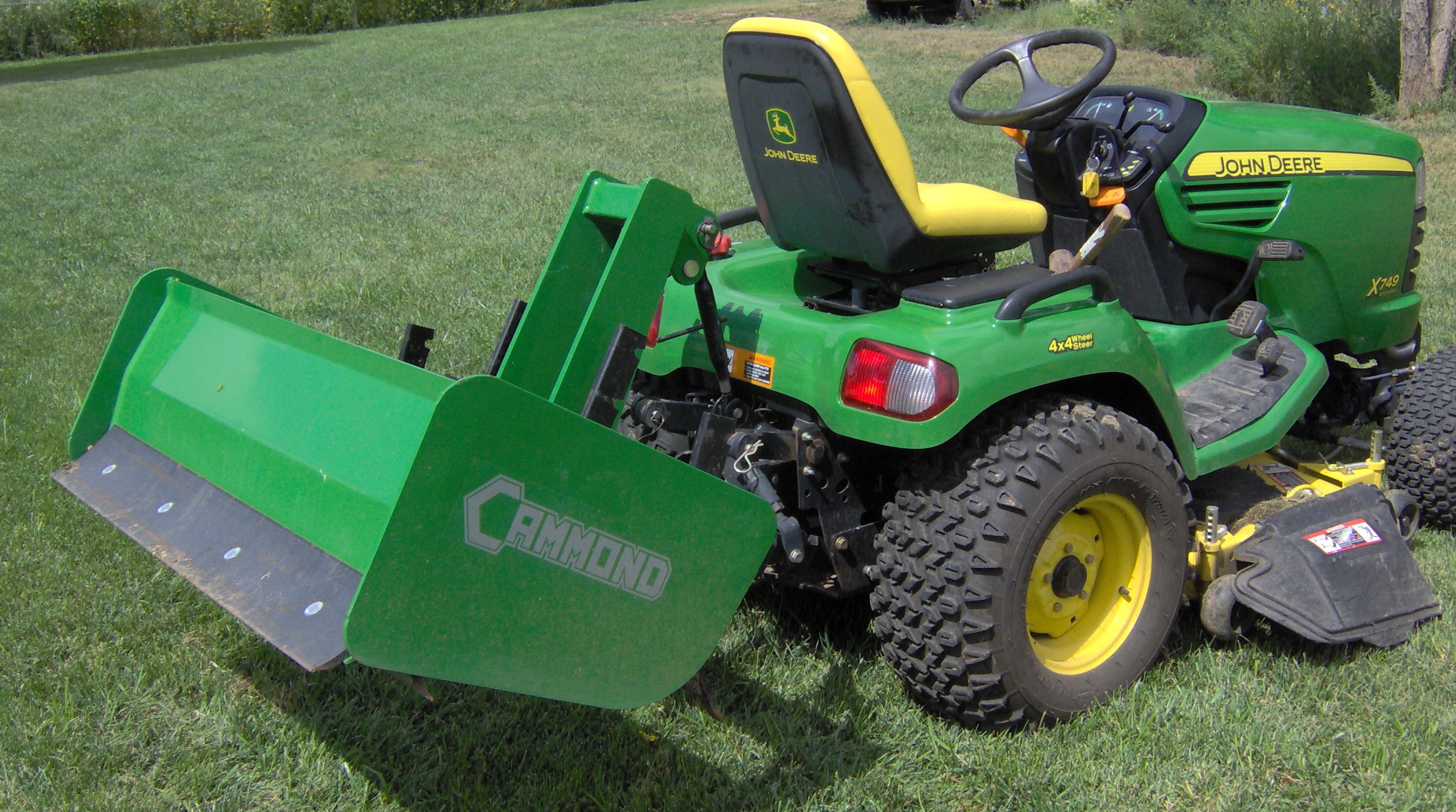

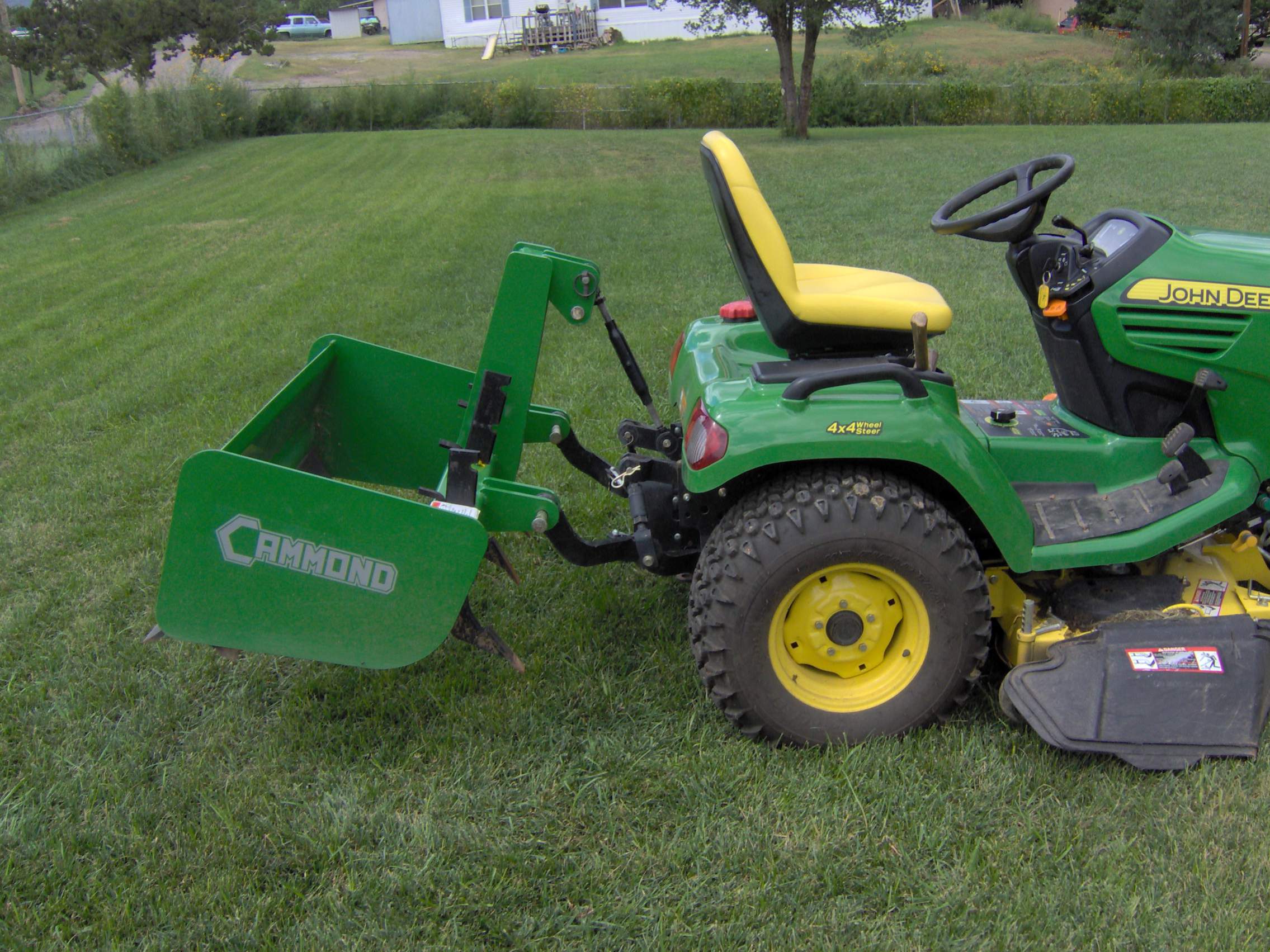

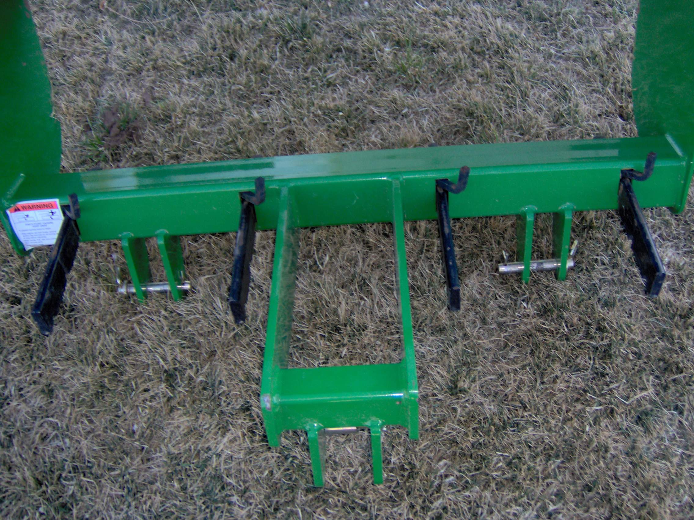

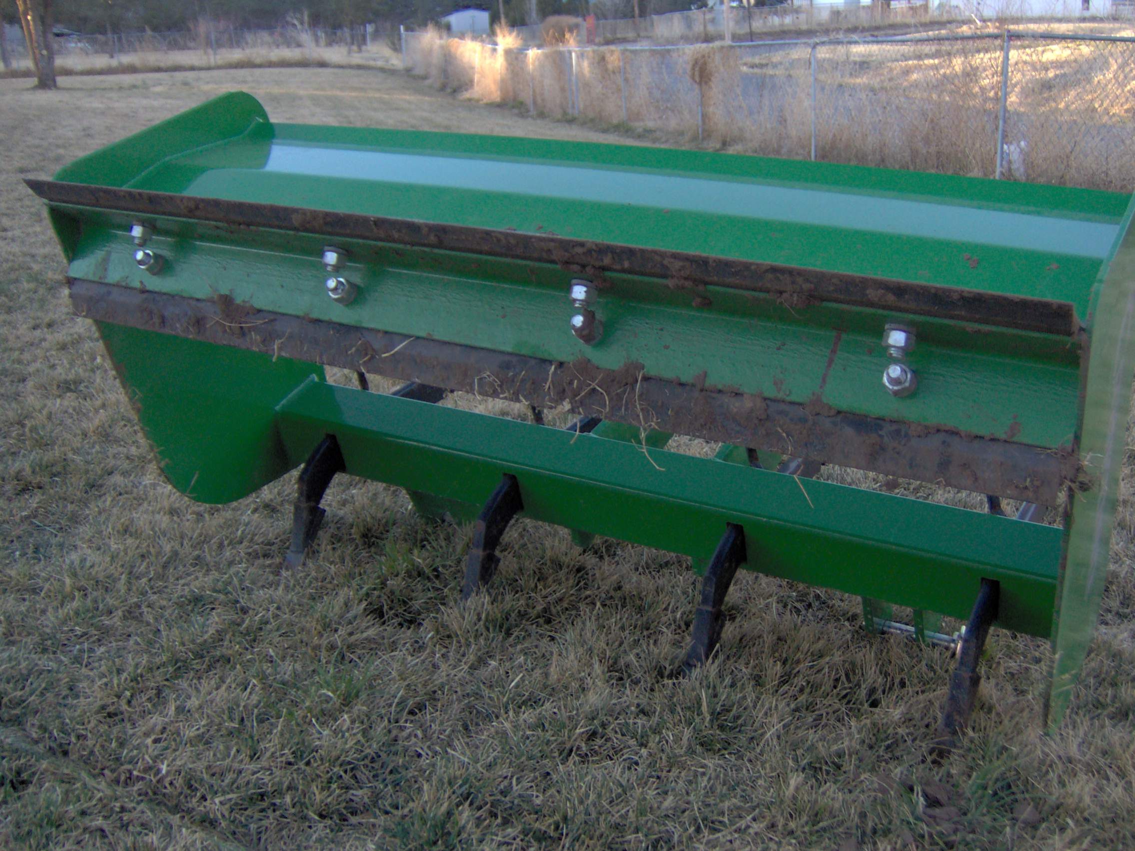

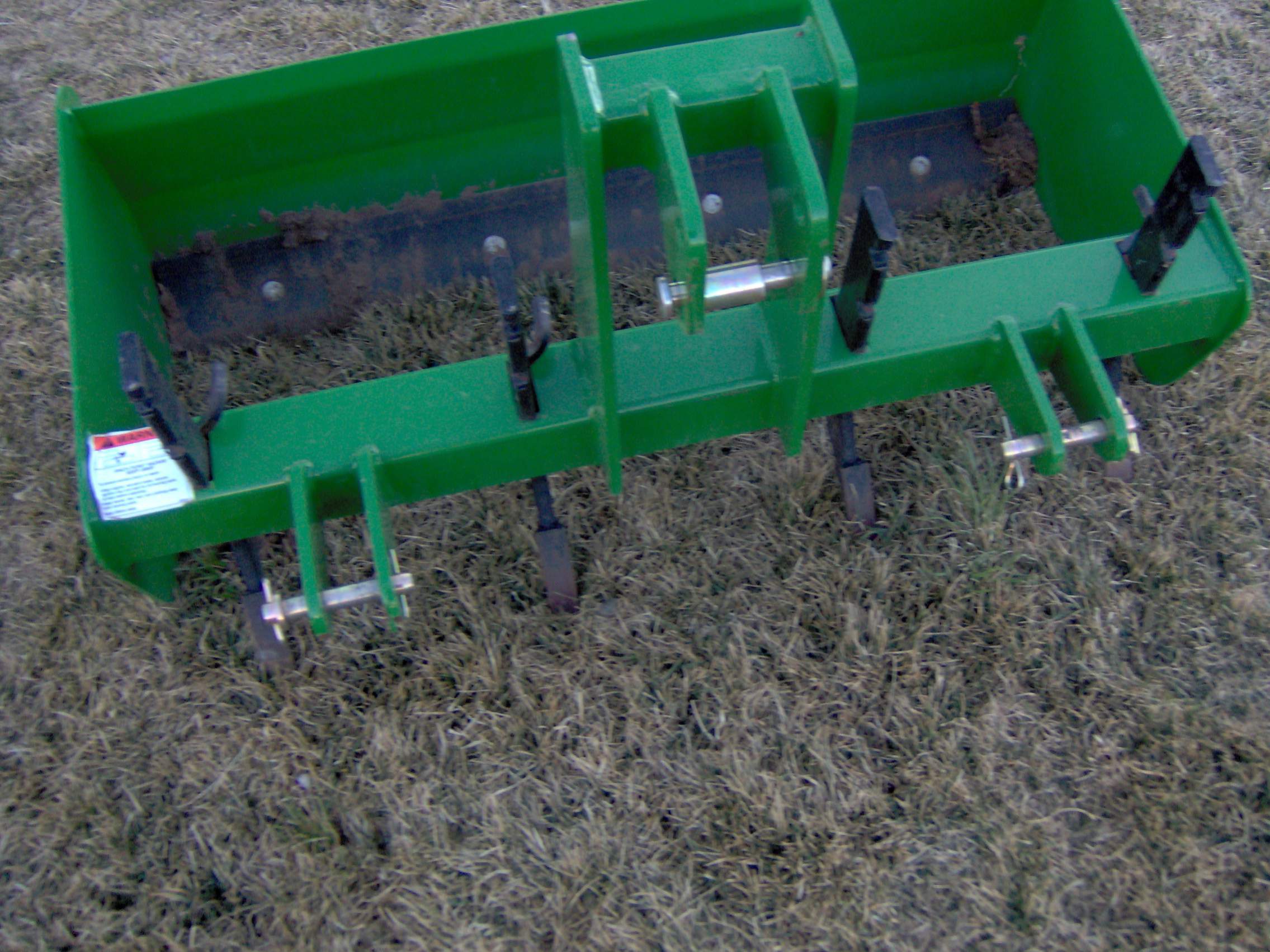

When I was shopping for a small box blade I picked Cammond brand after looking at several others. I have not used it a bunch yet but will be using it this week to finish up a lawn project. It is quick hitch compatible so using it this week I can quickly switch between my 4' land plane and the box blade.
Here are some pictures of the box blade.
