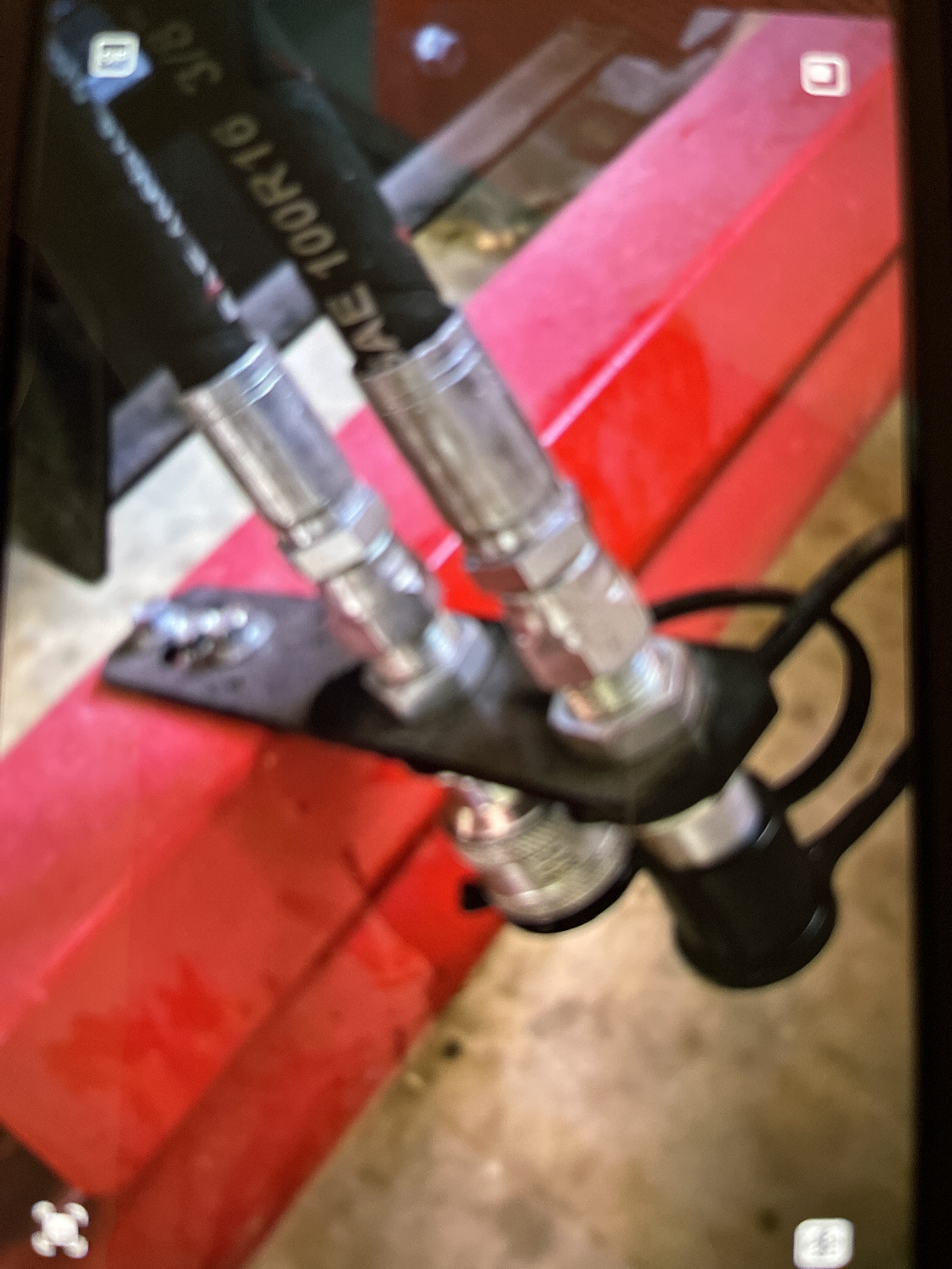

5 hours of use and leaked hydraulic fluid on my driveway 🙄
   / 5 hours of use and leaked hydraulic fluid on my driveway 🙄 #11
With that big of a leak I dont think you will need special tools to find a leak.
Clean The unit, run it and watch. Not very hard Task.

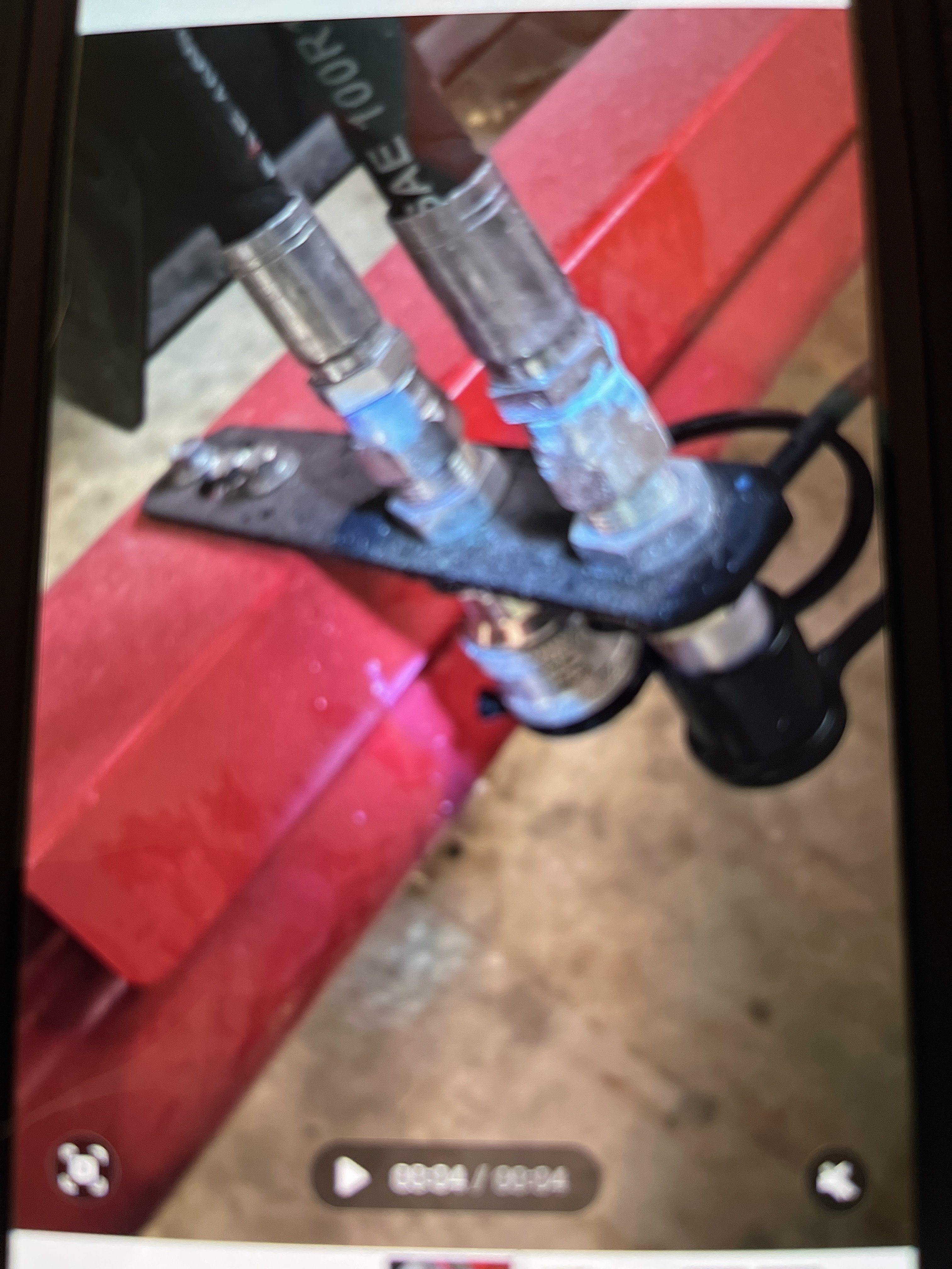

I just looked at my NH with two different ultraviolet flashlights. AFAIK I do not have any hydraulic leaks. However, we should see some fluid on the rods, at least in a ring at the extent of travel for the seals, and also on the dipstick for the hydraulic fluid. I have used only the fluid sold at the NH dealer and I bought this tractor new, so it's a known system.
Huzzah! The hydraulic fluid glows ghostly greenish white under the 395 nm flashlight. It glows a bit brighter under the 365 nm flashlight, even though this flashlight has less output (it's more difficult to make the shorter wavelength with LEDs).
An ultraviolet light source can make some substances fluoresce: they emit visible light of wavelength longer than the ultraviolet. Thus we can use our eyes to look for the substances. It might be that an infrared source does something interesting, but you'd have to have a special camera to see infrared, and it's difficult for a light source to make a substance emit shorter wavelengths (such as infrared to visible). Oh, sure, anti-Stokes emissions in Raman scattering will do that, but it takes a lot of work to get that to happen, and it's VERY faint.
With these ultraviolet flashlights, just a few other things glowed, such as the orange knob on the gearshift, and the grease on the FEL pivots. Nothing on the cylinders or hoses or control valve glowed. If there were a leak on one of these, I think the flashlights would have helped identify it.
Conclusion: ultraviolet flashlights should be able to show some hydraulic fluid leaks.
Well, I’ll be damned, @SmallChange - I thought these lights were only good for police work and checking hotel room sheets! This is a 365nm UV light I got off Amazon.

Worked with it this last weekend and didn’t lose a drop. My conclusion is, I put the dust cap on too tightly on the male hydraulic fitting and the hose completely drained on the driveway. The tractor was positioned in a downward trajectory to facilitate this.
Using that UV light, it’s the only place fluid was “visible”.
   / 5 hours of use and leaked hydraulic fluid on my driveway 🙄 #18
Appreciate the follow up. Keep an eye on the fitting just in case. I think, rather that the dust cap issue, there may have been a bit of debris holding the fitting open, or a poor seat on the fitting. If it occurs again, I would change out the fitting.
