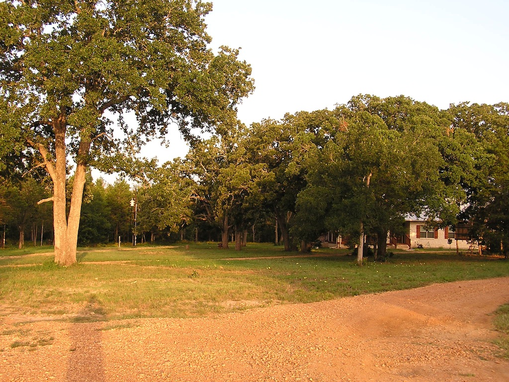

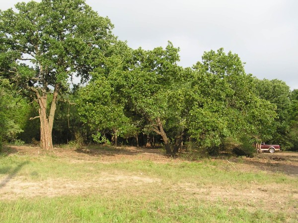

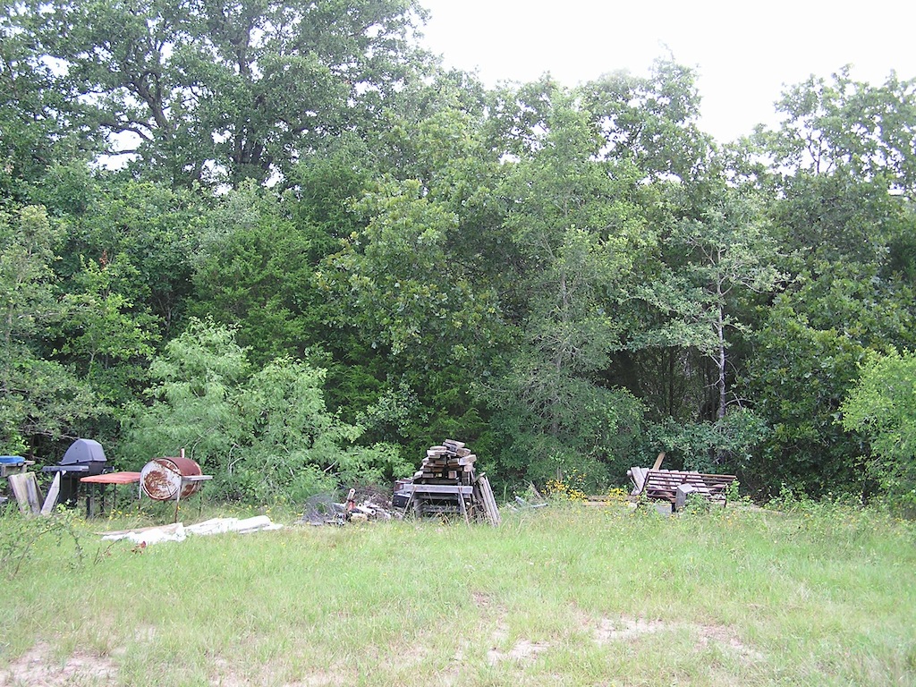

Wife and I bought this place 6 yrs ago and we started working in earnest around a year later. ....making progress....1) needed to clean up and clear to see.....2) like this ...spotted house site ....3) there it is.

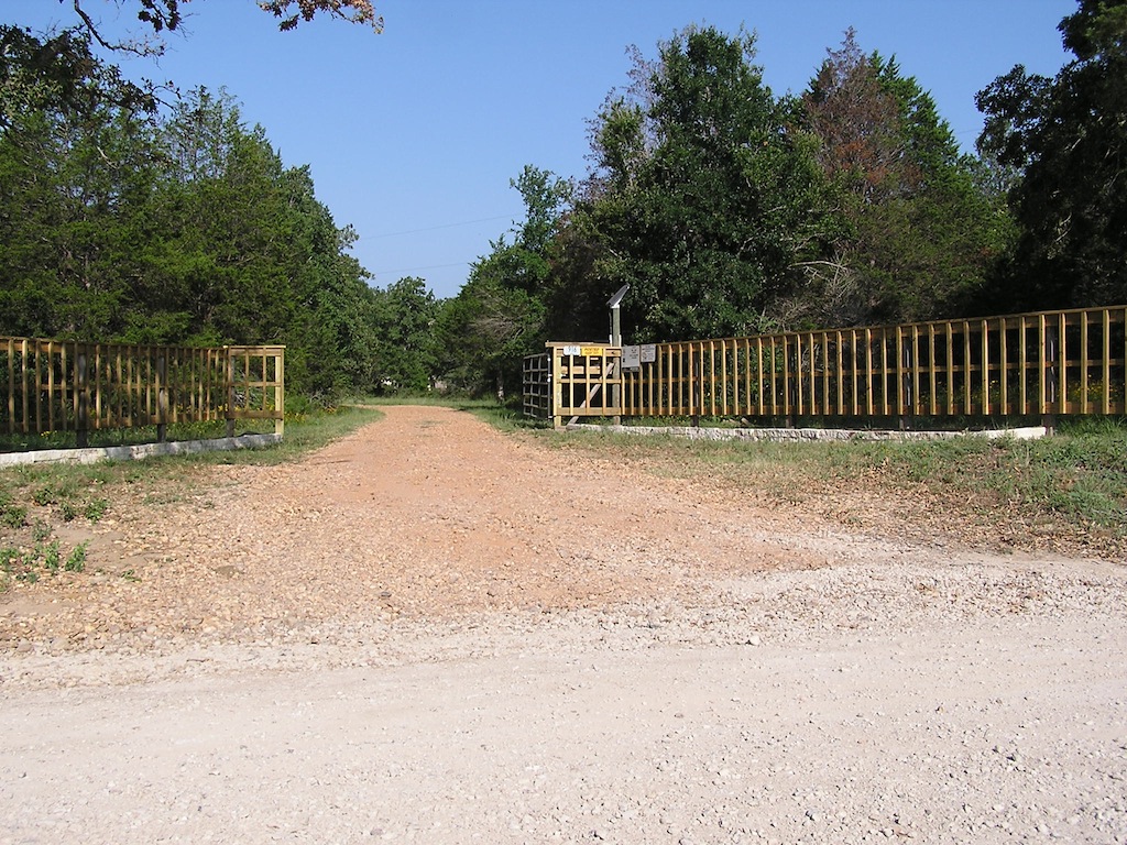

New entrance in progress. Planned something more -- as a hoped for TBN project but had to scale back due to unexpected budget hit.

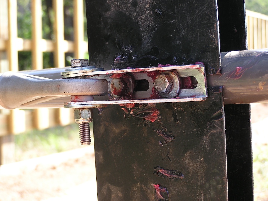

Using a "mule" opener so if anyone wants to start a pool on how long it will last - put me in for 14 months. I figure it should last the warranty period + just a little. ----Jinman --- I remember you putting a shock absorber on Kathy's old gate. I set this one up a bit different. I'm using the adjustable mounting slots as a slide. I added some teflon washers and grease. As the gate starts to move it gradually hits the end of the slots but the motor is up to speed by that time. I used nylok nuts and just "snugged" 'em. We'll see if I can maintain the correct snug for it to continue working as it is now.

Do you ever wonder about those split/twinned tree trunks? I've got about six pines that way on my property and they are more or less in a line.
