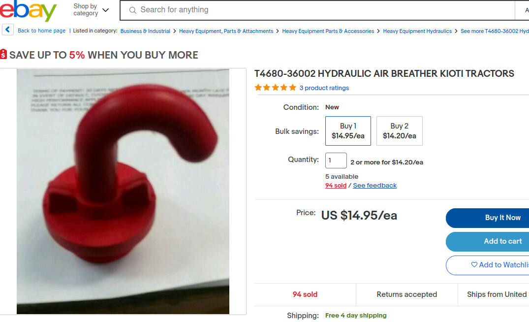

I'm thinking something like this:
I expect there is one or two ports on the hydraulic system that vent to outside air.
/ 50 hr Service #10
Once removed, that would be the location to insert the vacuum nozzle…. Also the breather pictured has no filter of any kind attached.

Okay, that make sense. Sorry, I assumed there were other ports elsewhere on the machine.
Watching someone's video where they lost 2-3 gallons of hydraulic fluid, while changing their filters, I decided then and there that the vacuum method was the way to go unless you were replacing the fluid too.
Thank you for the straightening me out! :cool:

Is this air breather oem for specific models? Mine does not have this.
Sorry, I was speculating about various ports when I wrote that post. I don't know what model that one fits.
My RX6620 does NOT use that breather though.
