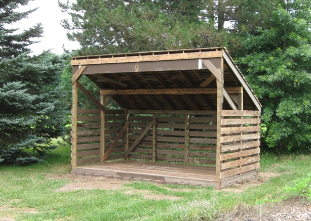

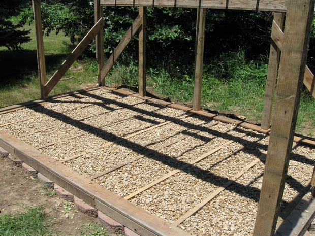

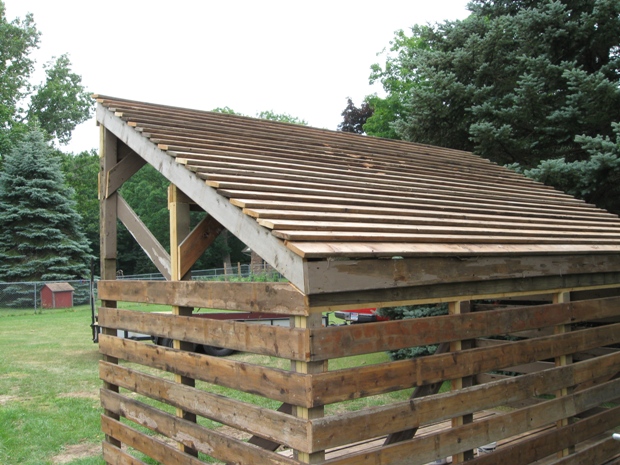

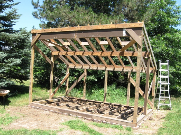

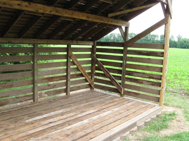

For a while I've wanted a wood shed instead of just stacking firewood, but it's hard to justify spending money on a wood shed. From other projects I"ve collected a lot of salvage that I needed to get rid of so I came up with this idea. I have a lot of retainer wall blocks from some landscaping I ripped out. Part of my cedar deck went bad and I replaced it with composite, but I saved the better portions of the cedar. When I rebuilt a bridge I salvaged some treated lumber including some doubled 2x12s over 14 feet long.
I laid a foundation of concrete block, topped by 4x4s. I ripped down some of the 2x12s to make posts, beams and joists. I used the cedar decking for various other parts, including the roof and the roof joists. I reused a lot of deck screws I pulled out of the old deck but I did buy a box of deck screws and a box of galvanized nails. I also bought some rock to fill under the floor to discourage the groundhogs from taking up residence. Cost came in about $50 but I may splurge on a gallon of waterproofing for the roof.
View attachment 382267 View attachment 382269 View attachment 382270 View attachment 382271 View attachment 382272
Excellent job,looks great.
