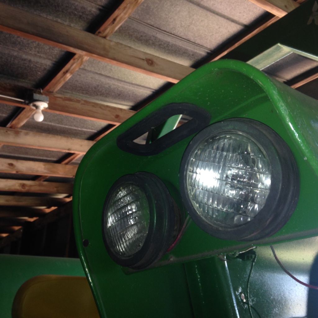

I suspect you can use led replacement bulbs on your tractor par 36 with the rubber rings common to these and the older bulbs. Do you have the original light bulb cans or housings on the fenders? There are several brands of par 36 lamps available with and without housings. Ranging from low power work lights to landing light replacements which would be more than you would want. If you don't have the housings there are lots of them available too.

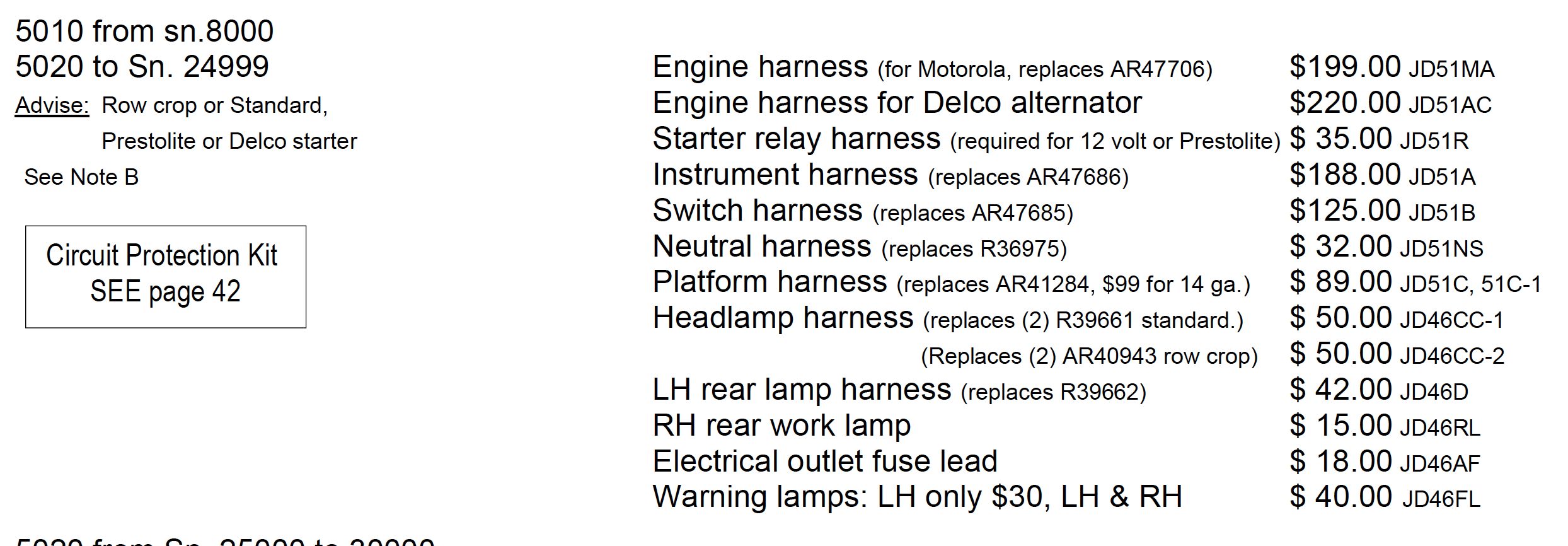

Yes, I have fender mounted lights with 2 lights per fender. I also have 1 work light in the back. Is this sufficient or should I put more? I do have the housing cups and rubber seals. Attached is the cost of various parts of the harness - I think it would total about 600-700$, this is not cheap. I really wanted to do it myself until I saw the diagram with various breakers, many wires and so on. Are all of those necessary? I am fairly handy with mechanical stuff but do not know anything about electrical stuff - I am not sure whether I will be able to do it. Which of the par 36 bulbs would you recommend for each location?

I am sorry, I made a mistake attaching 1 of the images. Please see below the cost breakdown of the harness.
I have worked in electrical and electronics most of my life and would tell you that having an electrical background in this case is only a minor help. If all the wiring has been stripped you need to be able to know where to put them back (routing). Does the technical manual show the routing of the cables? If not pictures of another 5020 might be a great help.
When this discussion started I thought you were in need of the lighting section only. If you need all new wiring you should buy a complete assembly. Which led lights spot or flood in par 36, I would have the spots on high beam and floods on low beam and rear work light.
