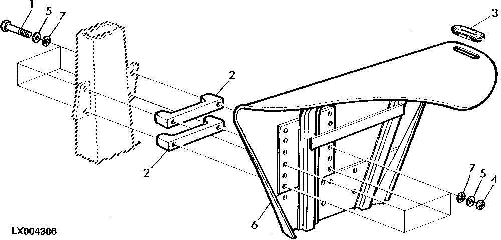

What do you mean by "cut outs"? On the newer 50 series the lower vertical part of the ROPS has tabs on the front back edges to bolt the fenders to. The fenders are not different for them (with or with out ROPS). There is a piece (spacer) that goes between the ROPS and fender. This on the newer series. I am not sure how 5020s were. I would assume the fender mount just stacks on the ROPS base?
/ 5020 roll guard installation
This is on the 1968 5020.
/ 5020 roll guard installation #4
Just guessing here but are the cut outs you speak of on the base plates for the fenders? You might have to notch the base plates to fit on the rops mountings. When I added a factory rops to my smaller 820 I moved the fenders and mounting plates outward and then bolted the rops mountings in place.
If it were me I would see if the fender base mounts had enough clearance around the rops up rights. I would be very careful not to cut out more than needed to fit. Don't want to weaken the fender mountings.
/ 5020 roll guard installation #5

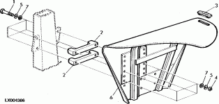

2755ropsfender.gifHere is a drawing of how JD did it on the newer tractors. The ROPS has tabs an spacers go between the fenders and ROPS. I think you could fab something up, straps on the inside of the ROPS, spacer between the ROP and fender and some nuts, washers, and bolts

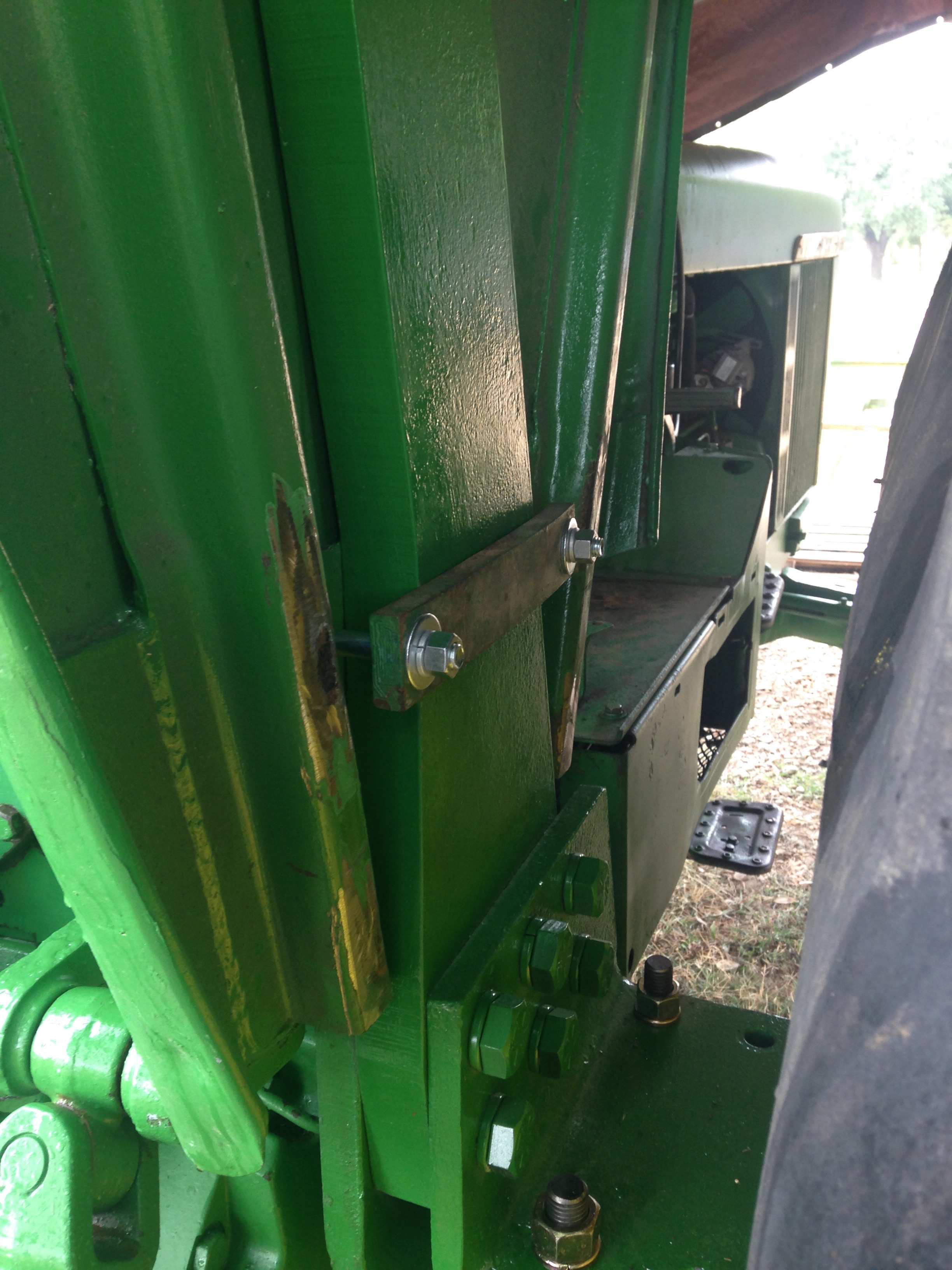

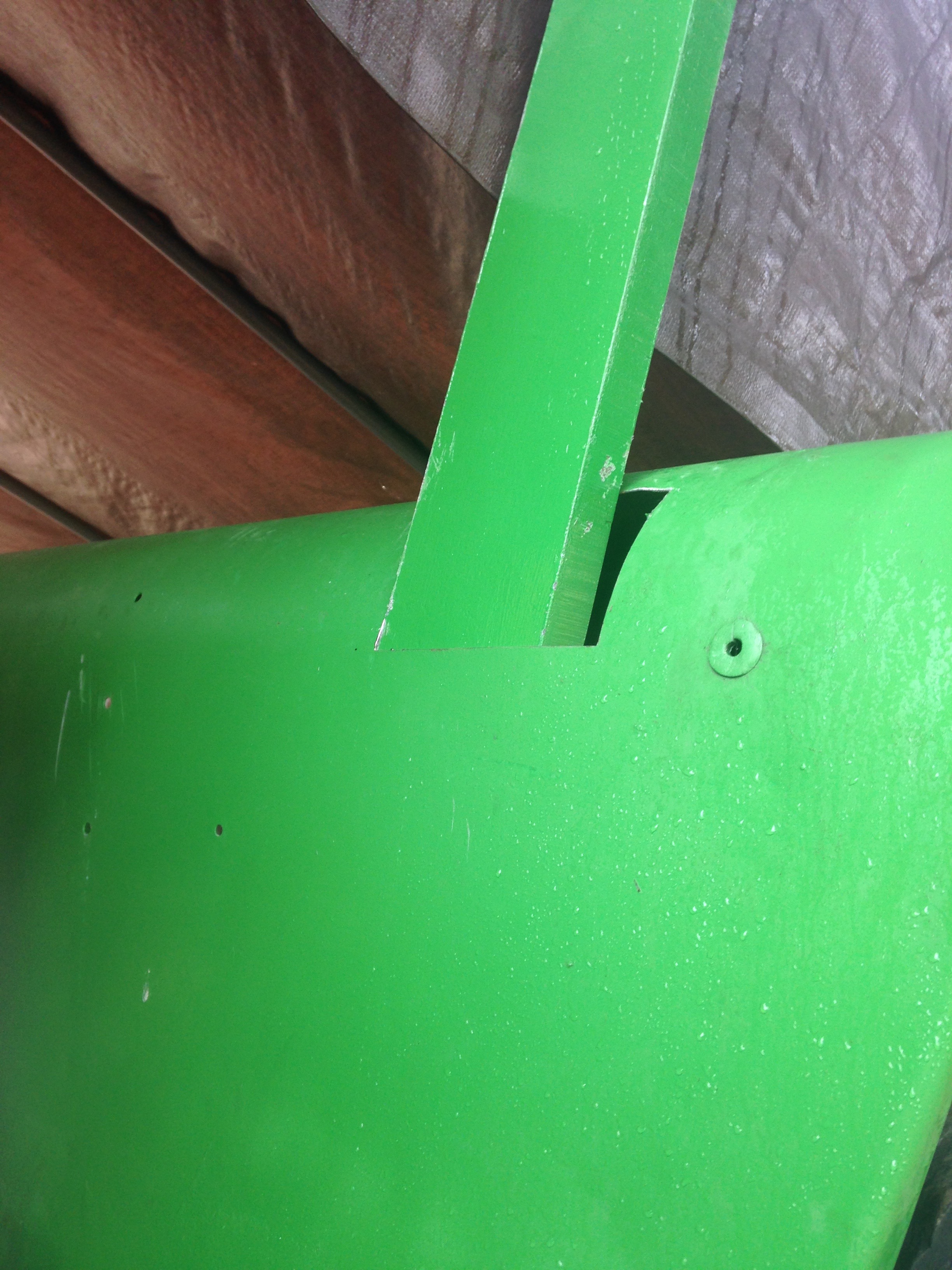

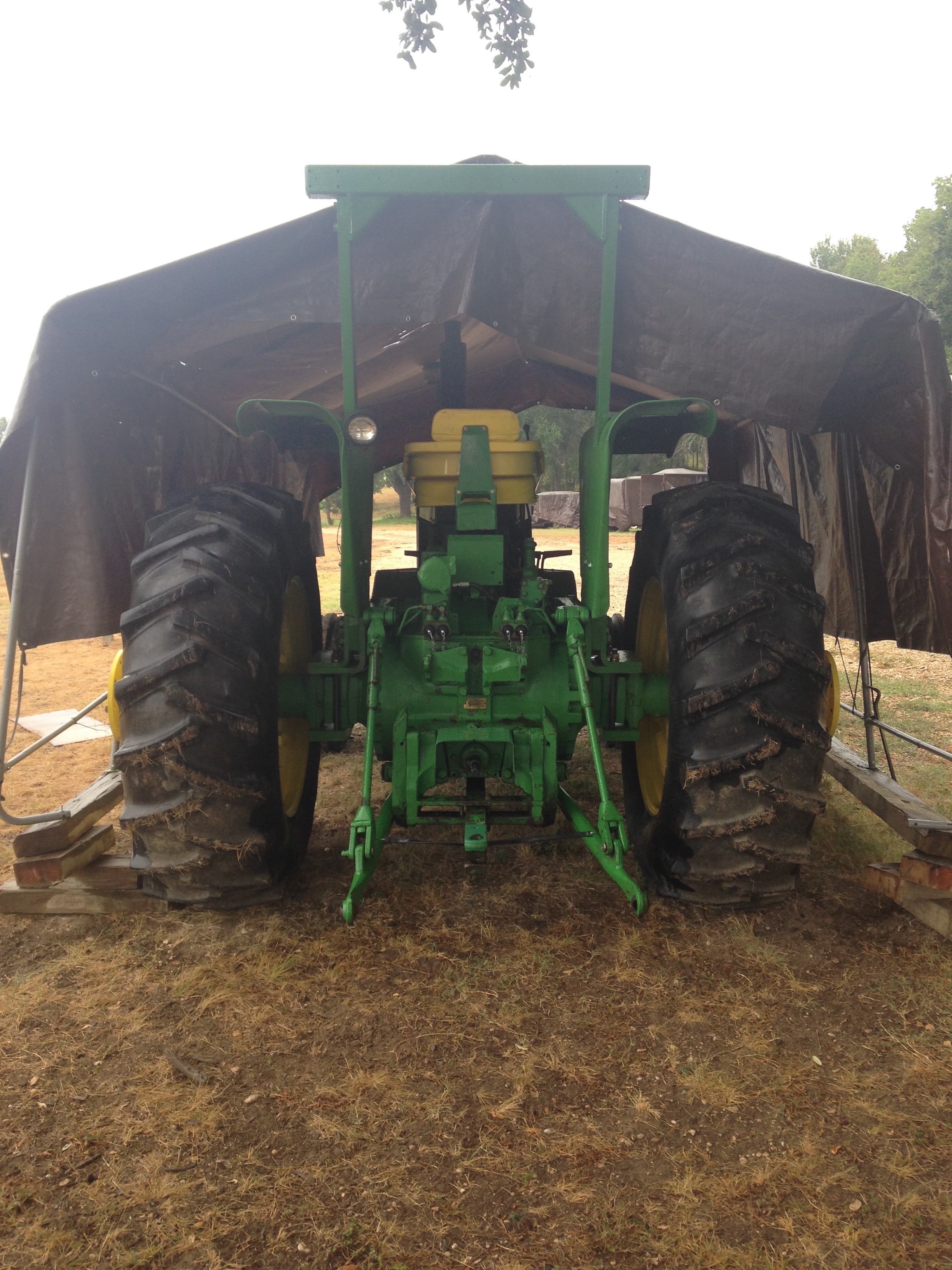

I finally got around to installing the roll gard and fenders on the 5020. I had to make some modifications to the fenders:
- I cut out holes (I used a template from another 5020 owner) that the vertical bars pass through
- I cut off the inner 2 brackets on each fender as these were not wide enough to allow the vertical bars to pass through
- I added another drill hole and clamped the fender to the vertical post with a metal bar - it is very solid
I think the fenders look good overall. They seem a little high, do not bother me enough to shorten them though. The nice thing about this set-up is that I can bring the wheel in closer as needed. I have to do some paint touch up and find a canopy next. Does anyone know if the 4020 canopy will fit or is it too narrow? Thank you for the info. IMG_1620.jpgIMG_1621.jpgIMG_1619.jpgIMG_1620.jpgIMG_1621.jpgIMG_1619.jpgIMG_1620.jpgIMG_1621.jpgIMG_1619.jpg

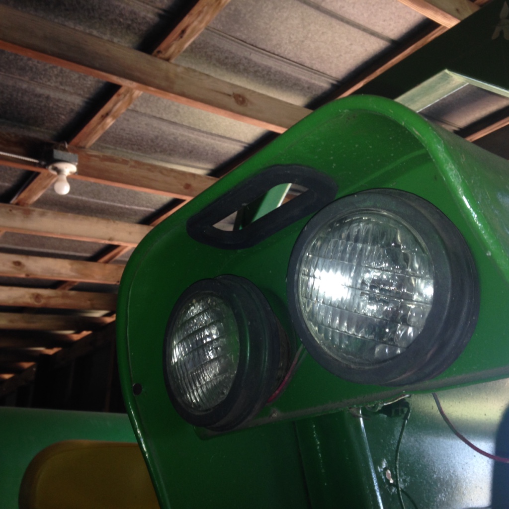

A few questions first. Do you have fender mounted headlights now with two lights per fender? Do you want to add extra lighting above the standard set up? What is the cost of the OEM harness?
If you can build your own harness using the tinned copper wire and new heat shrink materials you will have a better than original harness. If you are adding additional lighting the custom harness makes more sense. If you are satisfied with the original lighting and prefer a quick fix the factory or OEM harness may be the easier route.
I can check on the lighting for your tractor this week and will post back here.
/ 5020 roll guard installation #15
marcin,
I suspect you can use led replacement bulbs on your tractor par 36 with the rubber rings common to these and the older bulbs. Do you have the original light bulb cans or housings on the fenders? There are several brands of par 36 lamps available with and without housings. Ranging from low power work lights to landing light replacements which would be more than you would want. If you don't have the housings there are lots of them available too.

Yes, I have fender mounted lights with 2 lights per fender. I also have 1 work light in the back. Is this sufficient or should I put more? I do have the housing cups and rubber seals. Attached is the cost of various parts of the harness - I think it would total about 600-700$, this is not cheap. I really wanted to do it myself until I saw the diagram with various breakers, many wires and so on. Are all of those necessary? I am fairly handy with mechanical stuff but do not know anything about electrical stuff - I am not sure whether I will be able to do it. Which of the par 36 bulbs would you recommend for each location?
