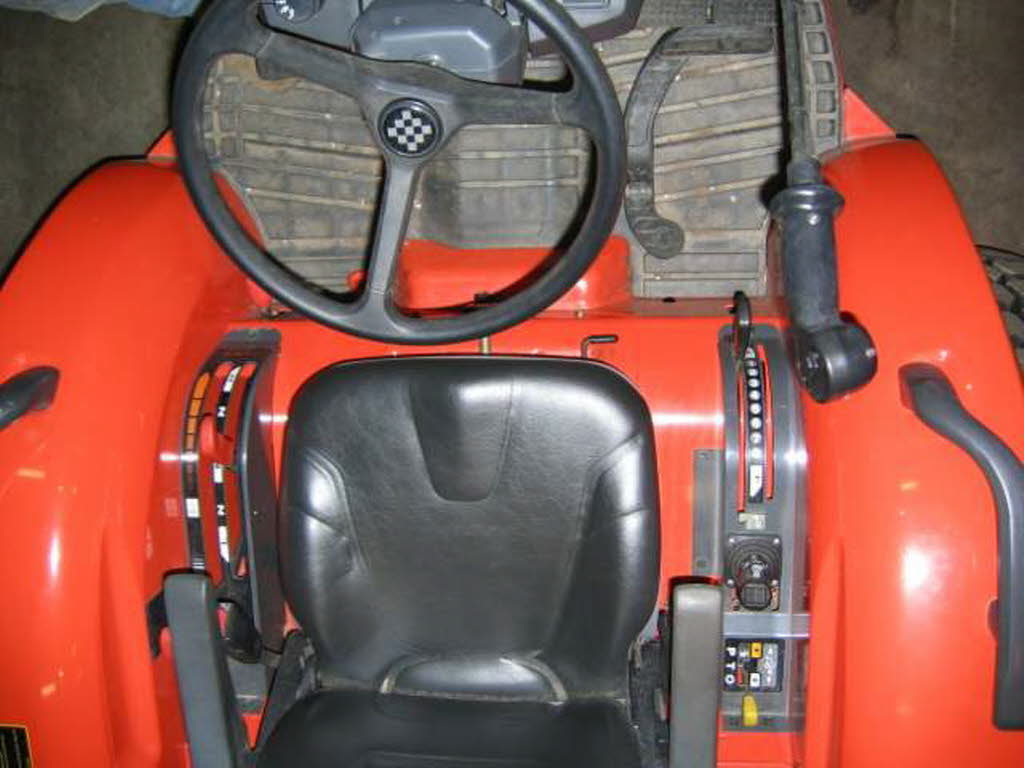

This is an overhead shot of the "operator's station". It shows how handy all the controls are. I never did show the loader joystick with the rocker switch for the front grapple; it replaced the stock loader handle. You can see the rear grapple joystick to the right of the seat.

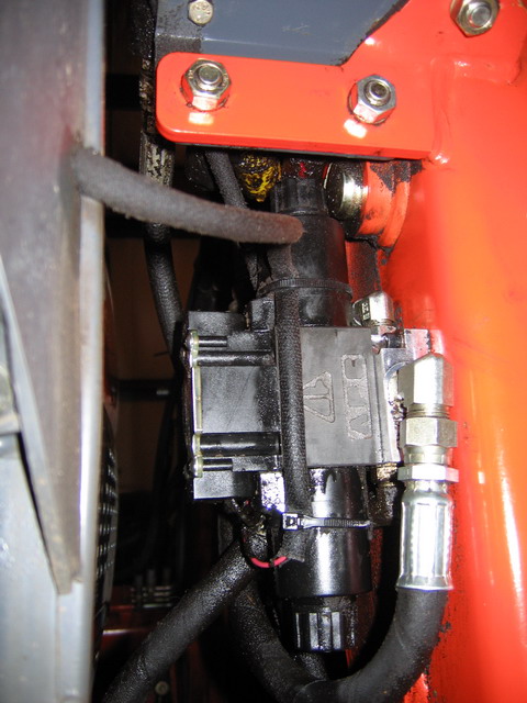

This shows how the solenoid that controls the front grapple is mounted on the lower right-hand side of the loader support. It's tucked neatly out of the way and it doesn't interfere with anything. To look at it, you'd think it grew there.
Notice the wire coming in from the left of the picture, throught the cowling on the instrument panel. That wire comes from the rocker switch on the loader handle and carries the signal that causes hydraulic fluid to flow one way or the other through the valve body to open or close the front grapple.

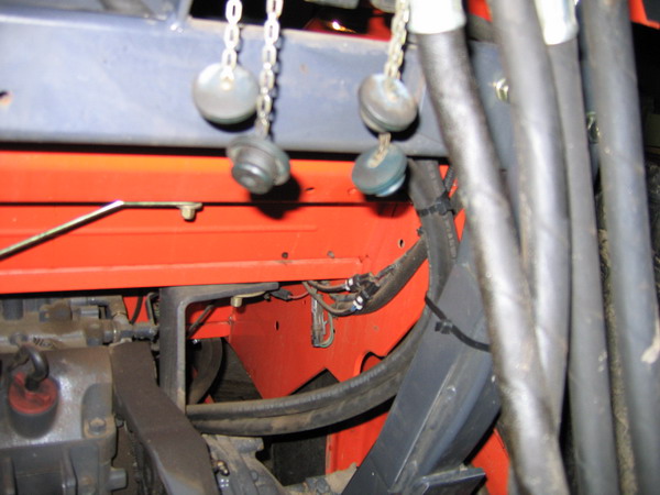

This pic shows how the hoses are routed to the front grapple. They largely share the same route as the hoses for the loader , then go to a bracket mounted between the loader arms. They end in two Bobcat-style quick disconnects that the grapple hoses plug into.
