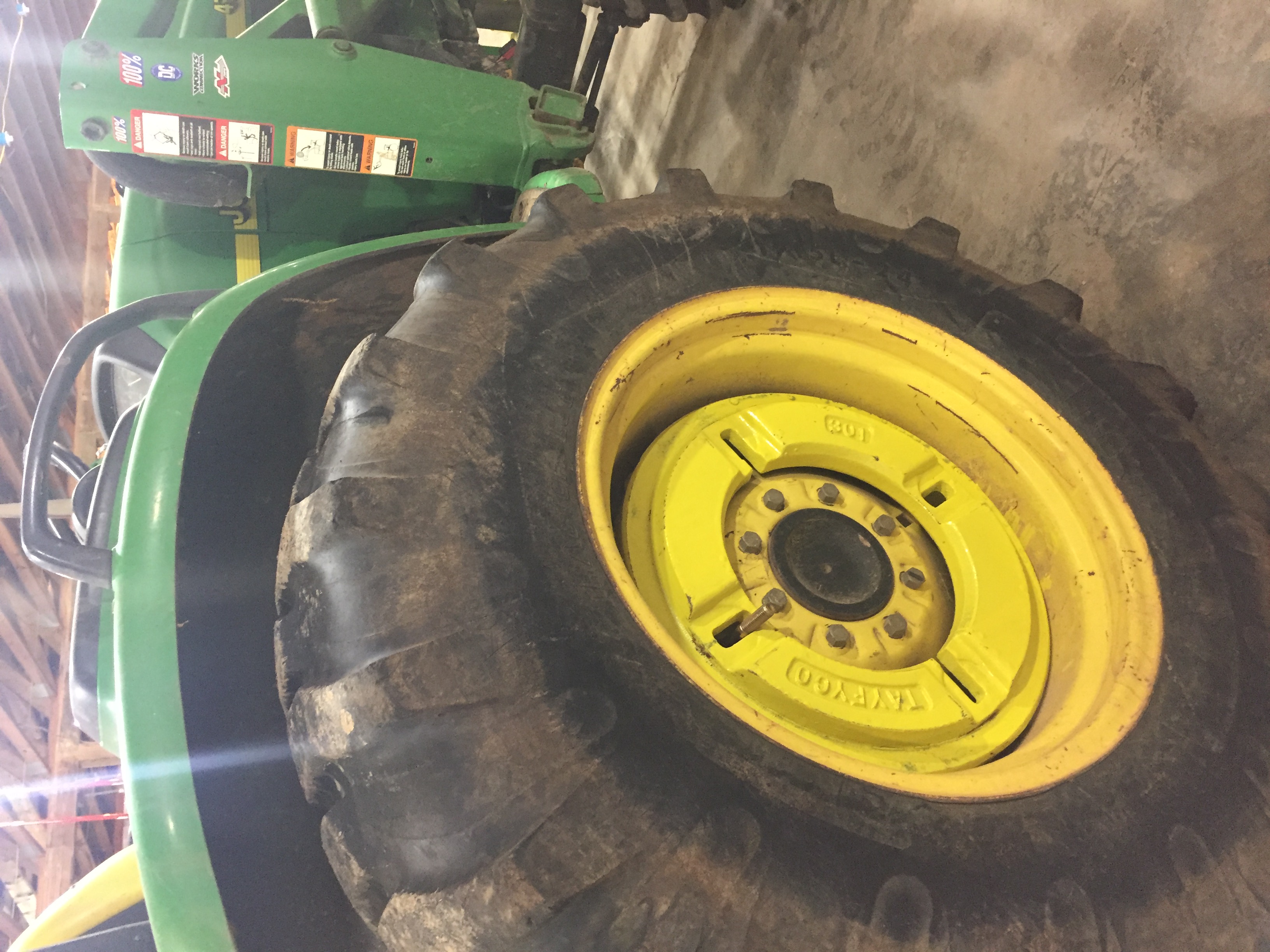

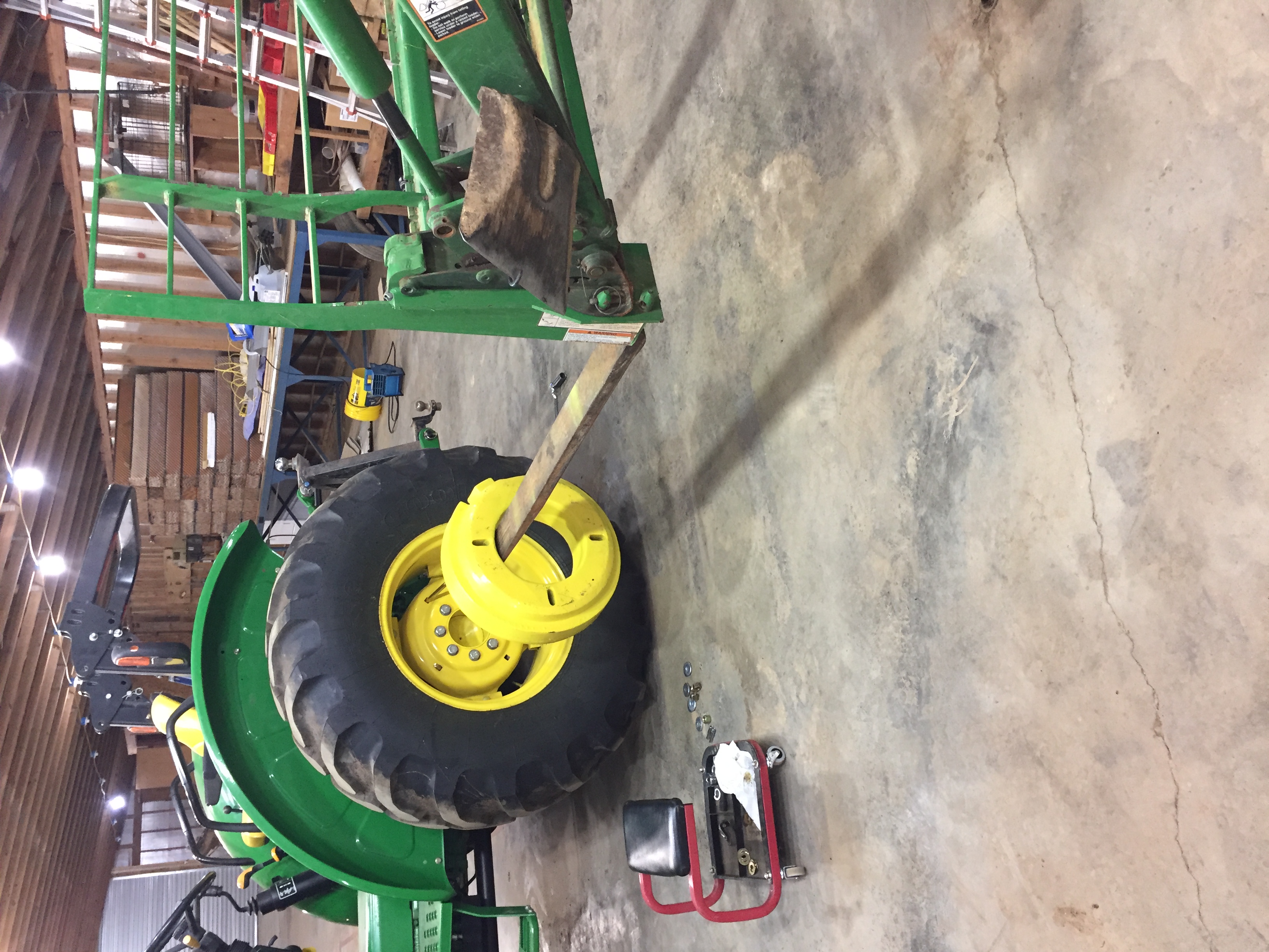

I Got the 4" Rear Steel Spacers on, wheel centers flipped (to except weights on outsides), tires / rims swapped sides (v/stems now inside) & 350lb weights bolted on outside of rims
The 4" Spacers with current wheel configuration on the left is the exact same width as config on right w/o Spacers as I had before.
   / 5101E with 19.5-24 Rear R4 Needing OEM Rear Wheel Weights info #28
Good thing you have a loader tractor to put them on. I've hung the 110lb weights by hand and they are a "hand full"
