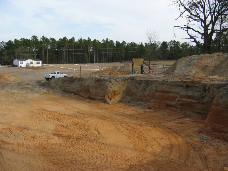

I have a 5205 MFWD and it really is strong with the loader. I dug a 38x45 basement an average about 5' deep (walk out on one side) in about 10 hours. It worked the machine, but I got er done.

All sand with a little clay here. I don't think I dug up one rock. Attached is a picture
Joe
