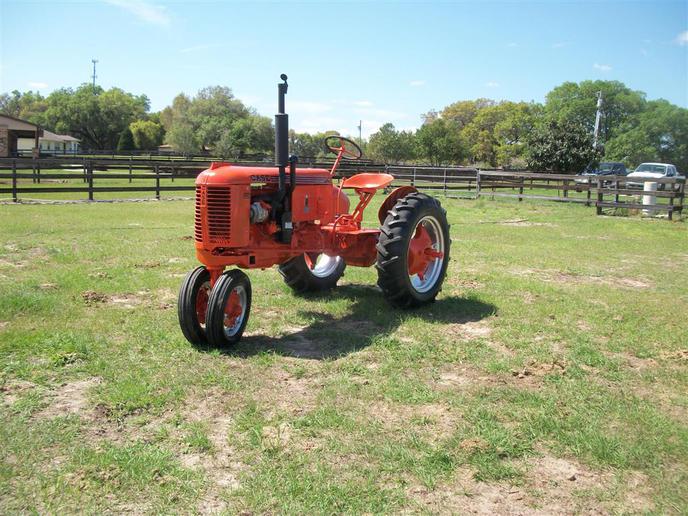

ps, post some pics of your vac.. here's mine:
