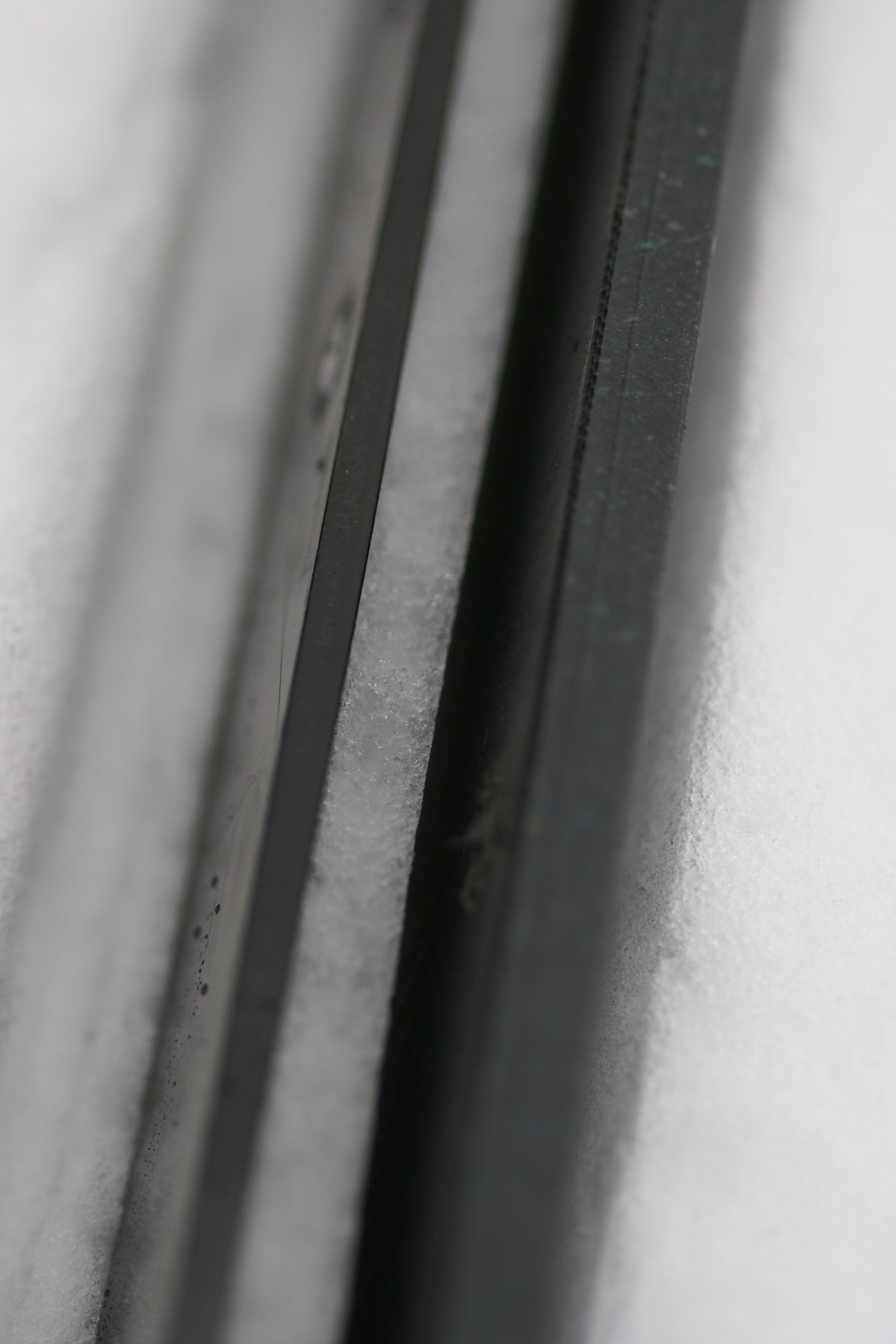

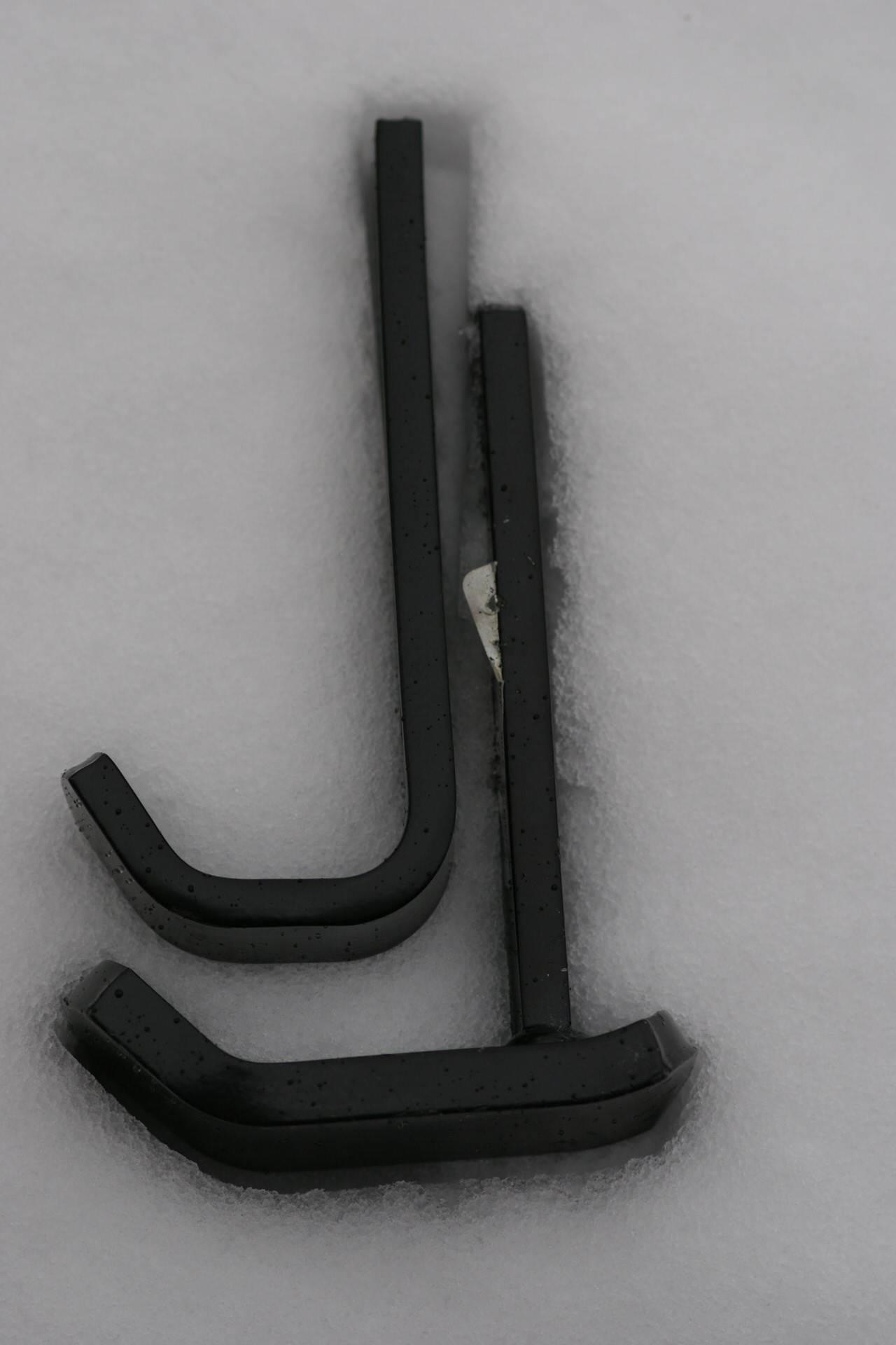

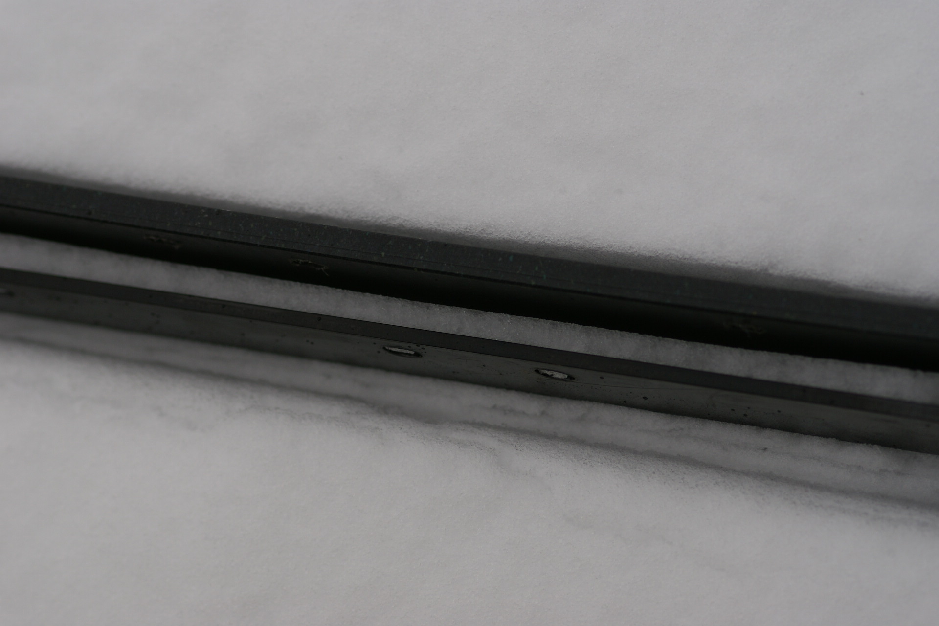

The material you really want is urethane for the plow wear edge. Wears 5 times better than rubber according to manufacturer.
I got my material from these guys.
Truck Surface-Saver Snow Plow Blades and Urethane Edges in Stock For Immediate Delivery
I got 1 inch thick piece that is 54 wide for the plow and 6 high. I cut it right down the middle to make it into two 3 inch edges. Drilled my own holes. I now have a replacement plus I can flip it when one edge wears. My cost was 100bucks but that is for enough material for the 2 I mentioned. I also backcut the edge about 30 degrees on the wear edge so it would sit flat when the plow is flat to the ground.
I'll get some pictures today and post them up.
Will
Pictures added (my plow is the johnny bucket plow set-up)

Interesting. The UHMW has a 60/65 durometer and the urethane referenced has a 90/95 durometer. I would think harder is better. Might have to try that urethane stuff.
   / 54 inch john deere snow plow wear edge #39
I will see how the UHMW wears, I purchased it prior to looking into the one inch alternative which I think is probably a better choice.
