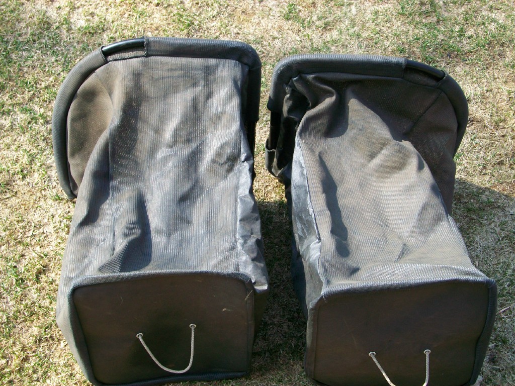

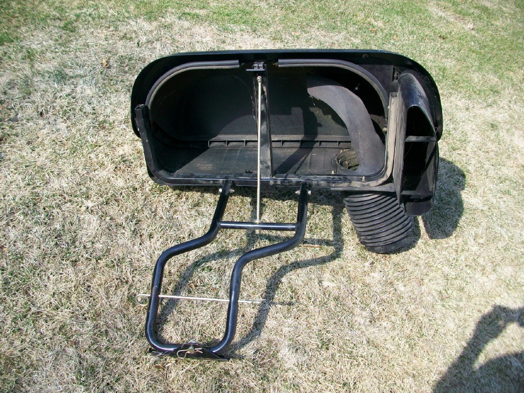

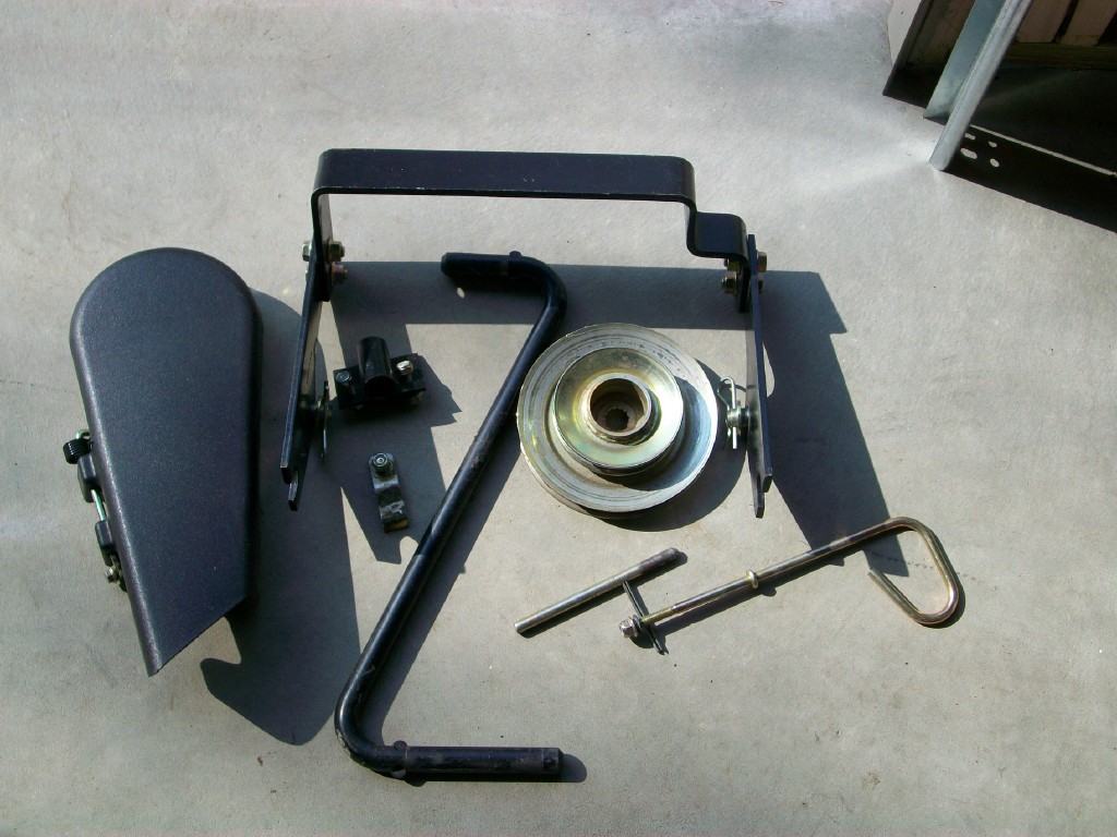

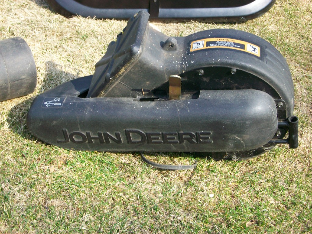

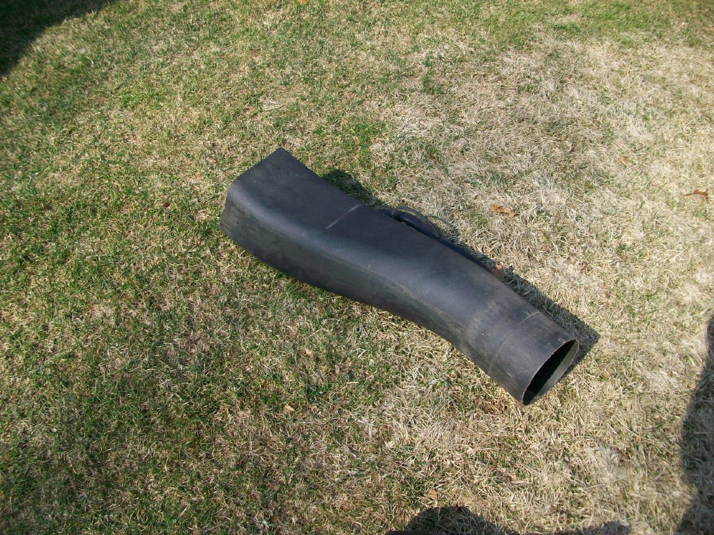

It needs to be from a 54C deck, and not the previous 54" deck. It cannot be from a 48" deck because the discharge openings are two different sizes. The bagger assembly is interchangeable, but not the chute from the blower to the hopper. they are a "cut to fit" deal, and once they are cut, they only work on that size deck. The hooper frame/top can be from any 325/335/345/355 or the following GX series 300 machines.
These are all part of the blower/bagger from a GX335 with the 54C deck that I had. I have sold them since.
