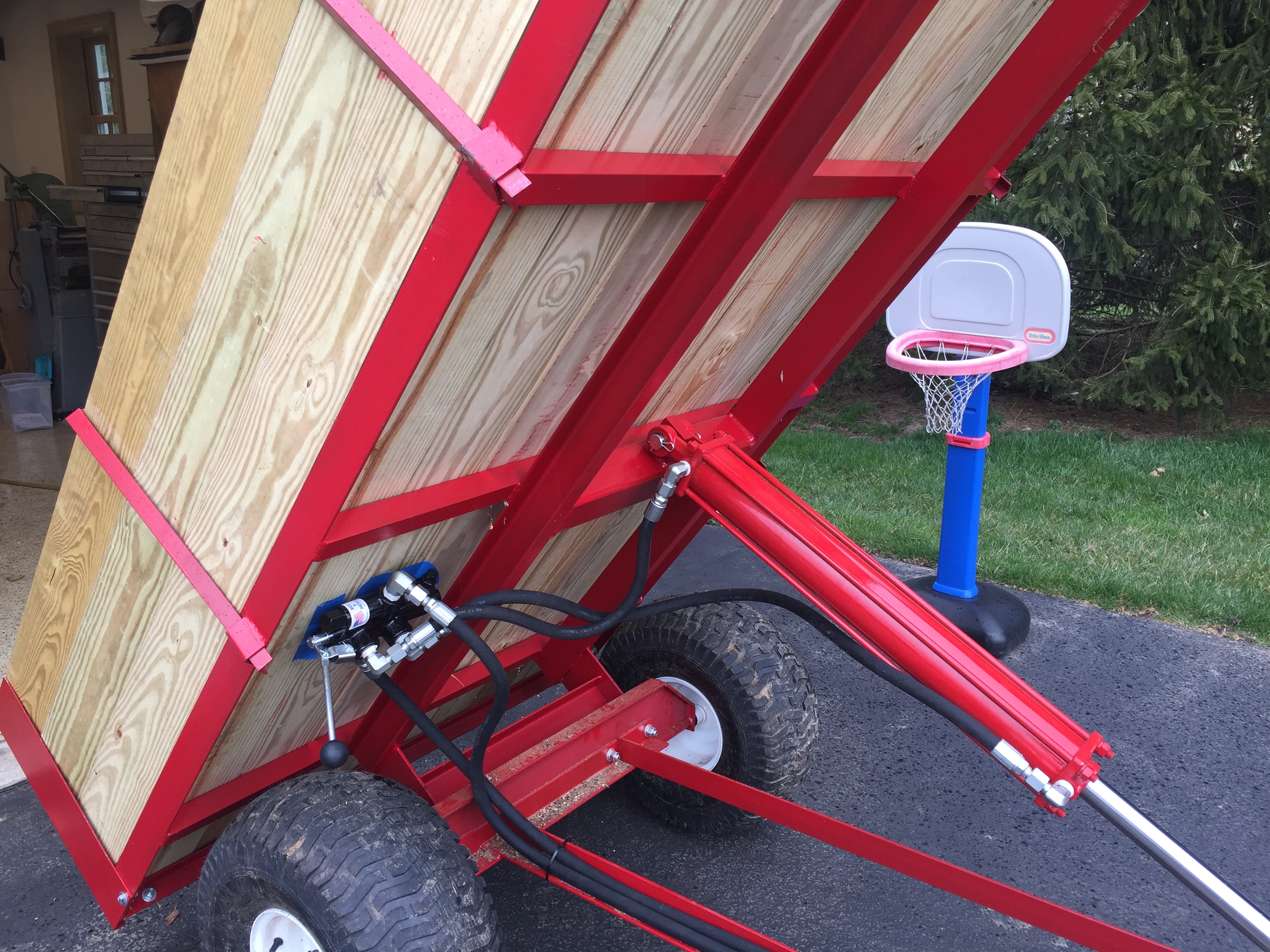

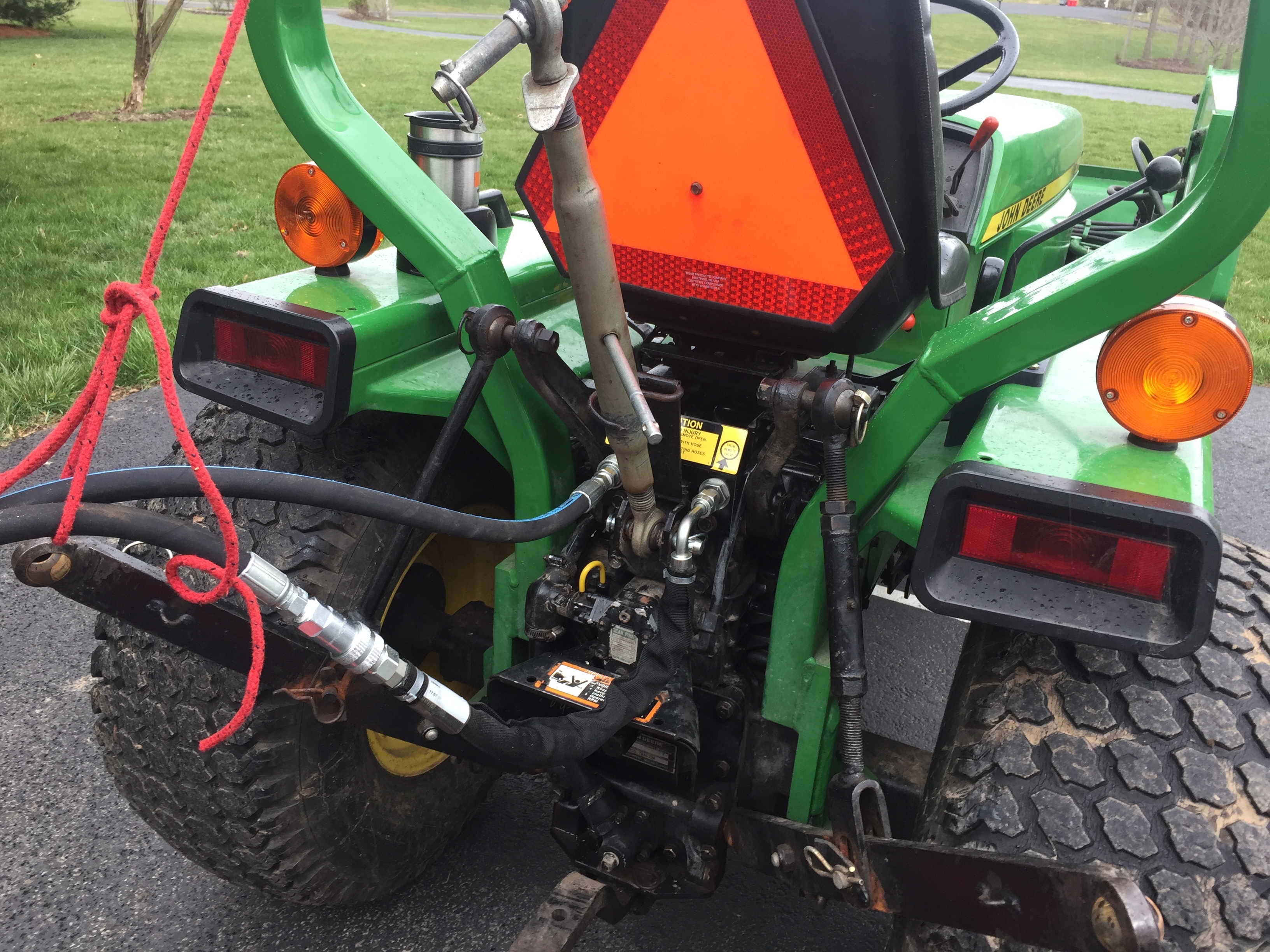

I actually bought and then later dumpstered a whole spare seat frame for that tractor, including the lift and suspension. Tried to sell it on ebay real cheap, but no takers. I just gave a few box loads of other spare 855 parts to another local owner, as mine was a bit of a basket case when I got it, and I did a lot of improvements.

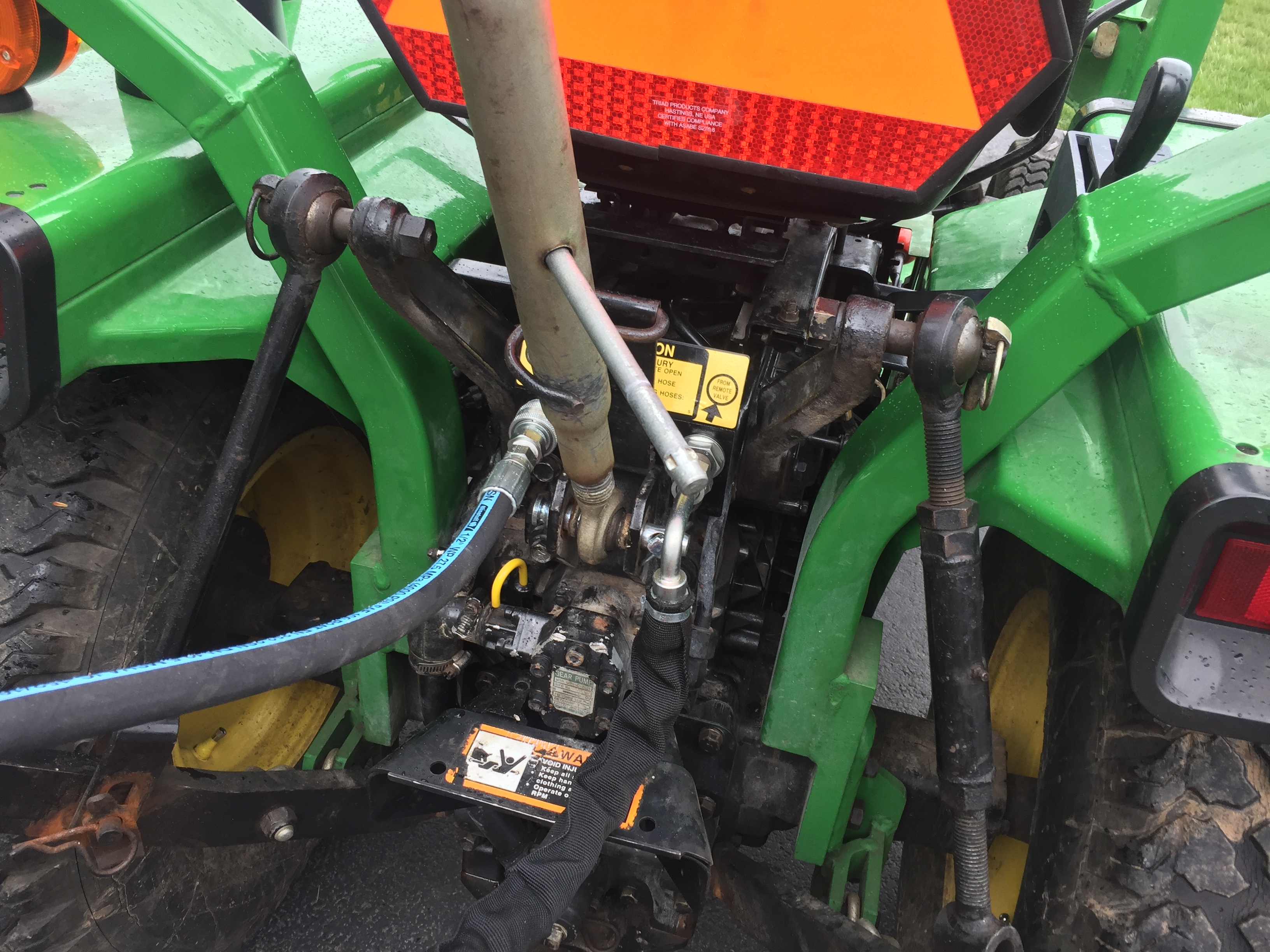

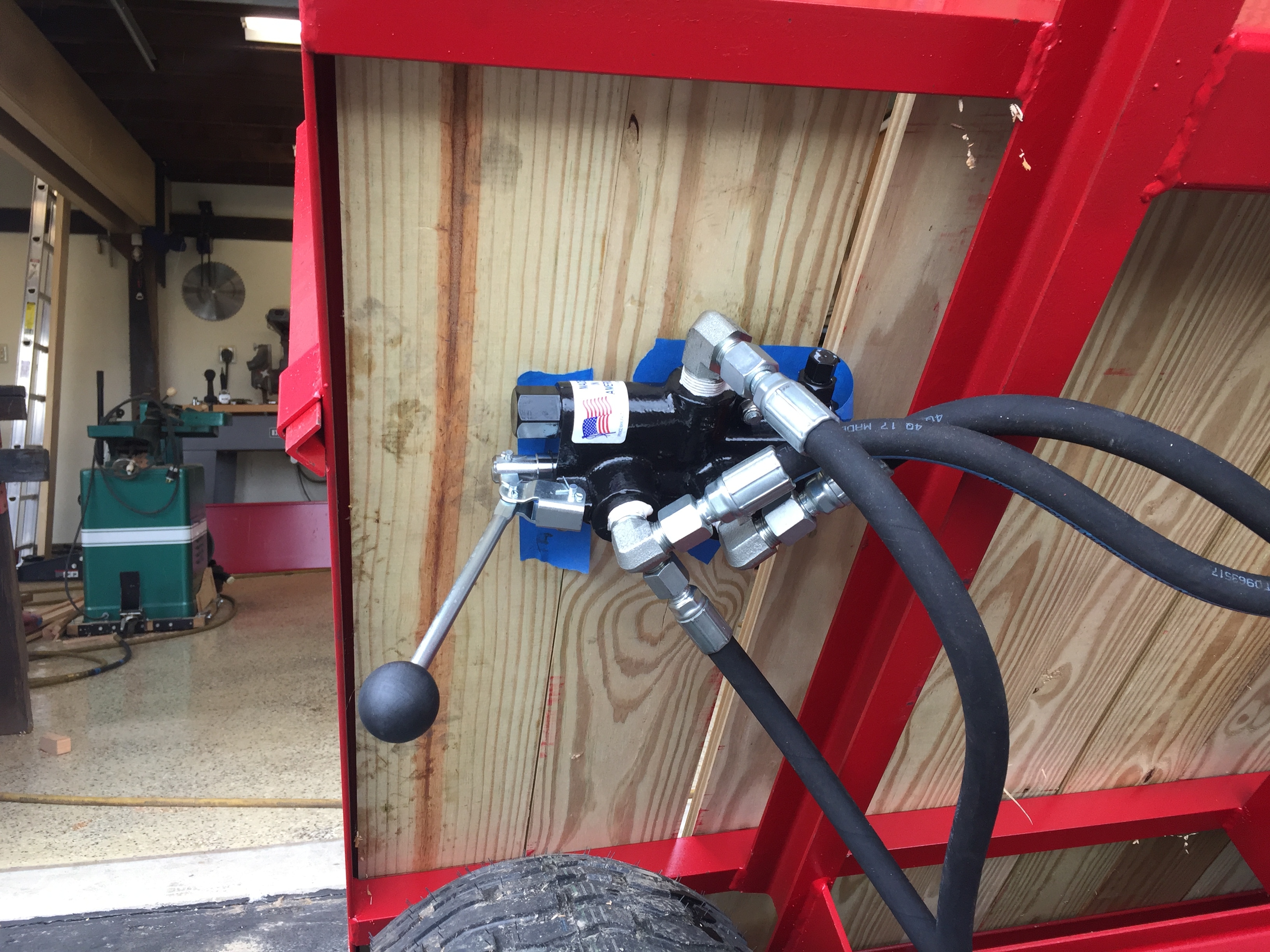

I even added Power Beyond to my 855, to power my dump wagon. I had to custom-make a hose, as one of the hard lines required for that accessory was NLA.

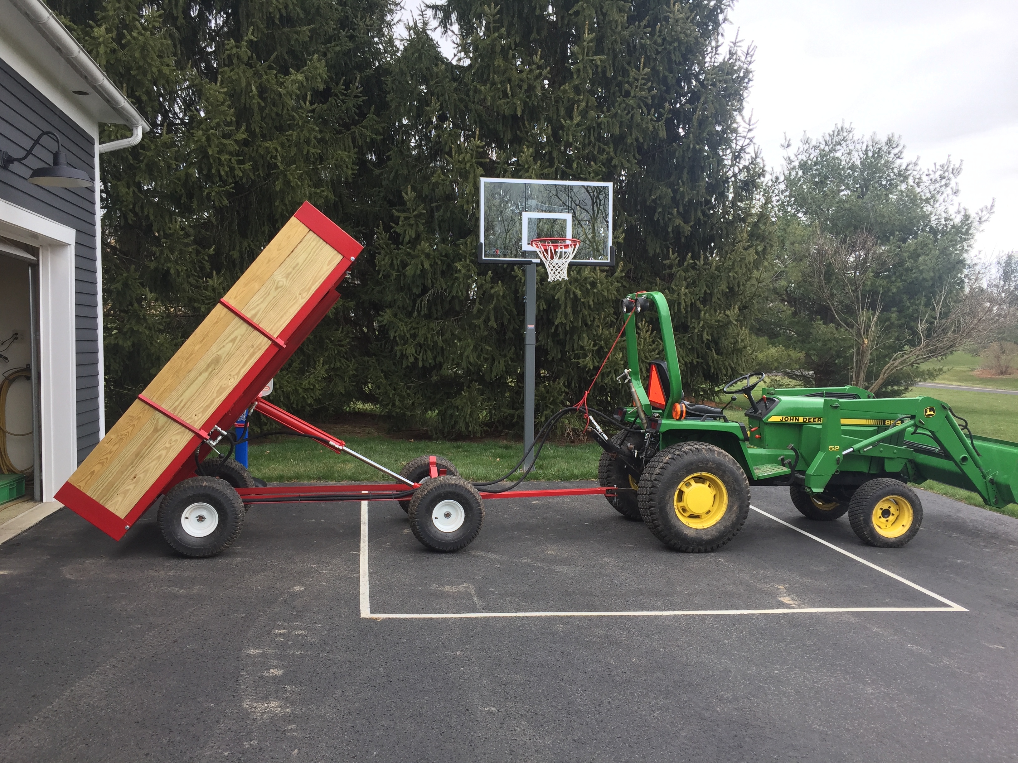

Impressive trailer! I could certainly use that around here. All I have so far is a small 5x8 utility trailer that does tilt, but the pivot point is so far back, it is next to useless with any kind of load in there - other than dry leaves. However, now you gave me the idea to find a hydraulic lift for it...

Yeah, the hydraulic dump is a great feature, when you have the thing loaded with mulch or topsoil. Highly recommended, if you have the auxiliary hydraulics to support it. I set it up to run on Power Beyond, with the SCV mounted on the trailer itself, because the 855 didn't have a 3rd hydraulic function.
