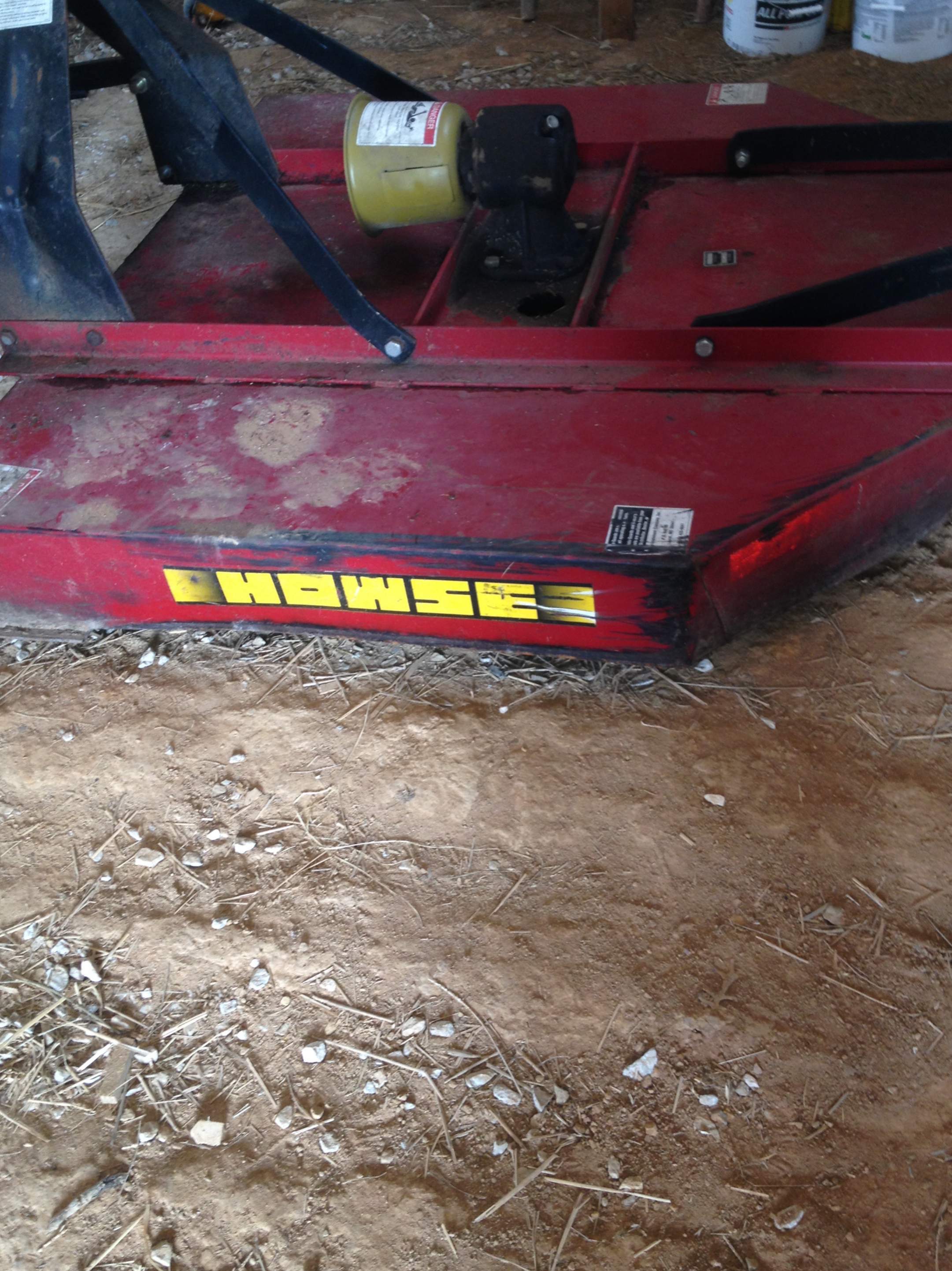

I have a broken joint on drive shaft now that the po ran 1000 rpm in heavy brush. Luckily that was all that happened. When I told him he couldn't do that with a 540 rated bushog and is why it broke, he looked surprised & puzzled.
Must have hit something too. Looking underneath one blade is wrapped over the other one like a pretzel. Bet it was a heck of a bang. Amazingly didn't seem to hurt transmission other than loose bolt or the tractor PTO.
Actually in heavy cutting a 540 will pull much easier running 540 that it will running 1000. He must have had a lot of HP for the size cutter.

image.jpgNo the tractor was only 25 hp and probly running wide open. I was lucky to be able to order the back half of the shaft from HOWSE mfg. I got two quotes on parts to repair at other shops & both were $200
