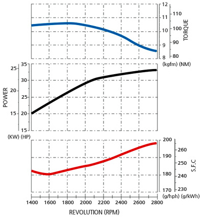

One drawback of running at 1900 rpm is that you don't get "torque rise". That's where torque increases as rpm decreases from normal operating rpm, as long as rpm does not get too low. Most tractor engines including ours are set up that way. For example here's power curves for the A1700:
Note the torque peaks at about 1800 rpm, but HP is highest at peak rpm. (The bottom SFC chart is specific fuel consumption or fuel used per HP. Running in 540E would result in lower fuel use).
