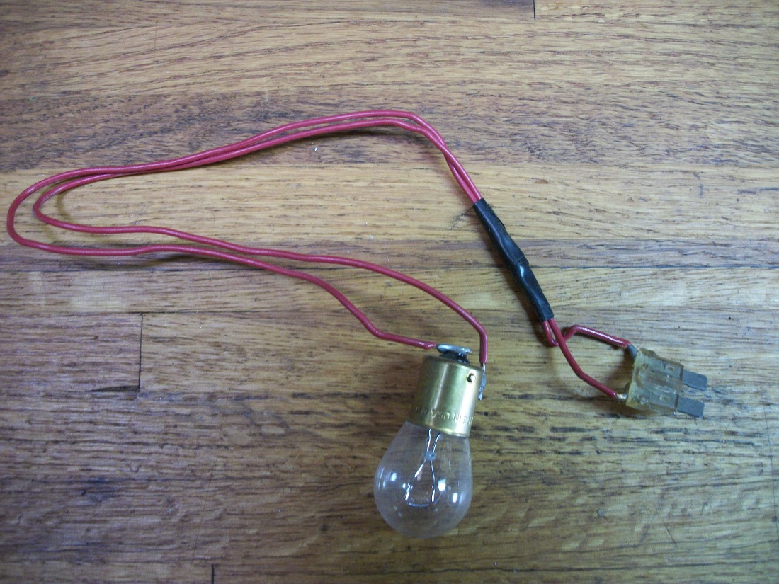

What I do to find a short that is causing a fuse to blow is stick in a light bulb (rigged on a blown fuse) in the fuse slot. If the bulb lights up, there is a short to ground. Gives a visual aid when moving wires around to find the one shorting out. Saves testing with a new fuse, just to learn there is still a short.
Even tho no blown fuse has been reported by the OP, if a small drain is suspected, then the same trick may be helpful in locating the wire that is the culprit.
Hope you can track it down, whatever it is.
/ 5410 lighting issues #5
I like the bulb across a blown fuse trick. I'd never thought of that one. The severity of the current leak will show in the amount of illumination while the bulb serves to limit current flow in the circuit. That's one I can hang onto. Thank you.
