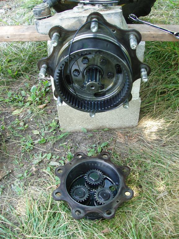

see if this helps -
Can you share those pictures from above again? I have a 5320 that looks very similar to the pictures that have been shared here as well. I'm hoping that all I need to replace the seal as well. I sheared a stud last week and noticed oil all on the inside of the rim. Thank you for any advice or pictures that you can provide to help me diagnose the problem.
   / 5420 MFWD Hub Gear Oil Leak #13
Got it done in the shade this weekend. Really pretty easy except for wrastling the tire/wheel back on. The old o-ring did not have any obvious faults, but there was some buildup in the groove. Recall above I noted I had found the #1 screws broken last year, it was obvious the tractor had been run with the lugs nuts not properly torqued as the stud threads were banged up. After a month or two I'll update if this fixed the leak, or if I have to replace the inner seal. Thanks to all - it really does create a suction with the drain plug in. Below is a photo.
