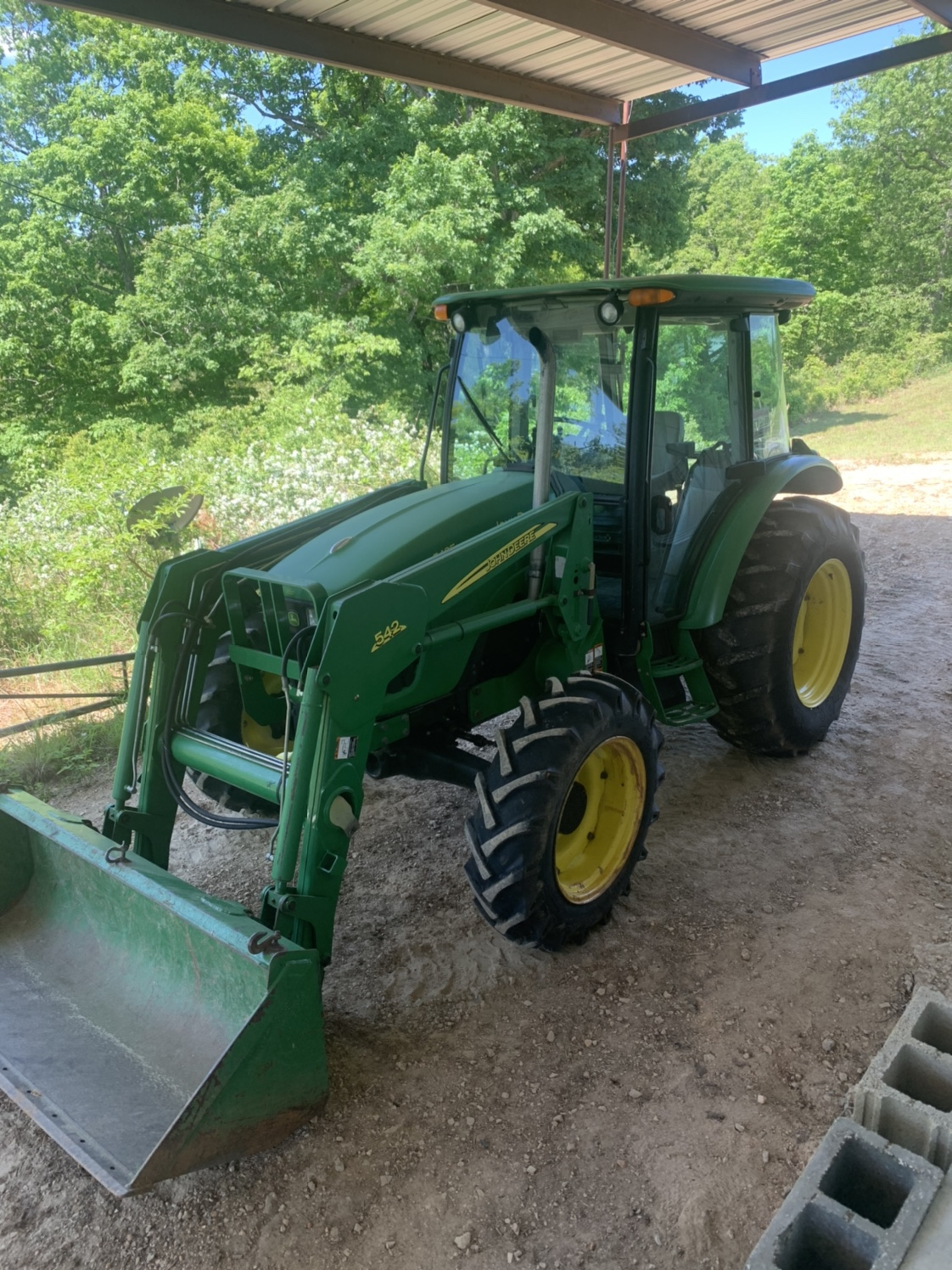

I just signed papers for a 2005 John Deere 5425 4x4 with a loader with 2200 hours yesterday. Its in excellent condition. This will be the last tractor l buy hopefully at least according to my wife. 🤪. Should be deliverd this Thursday or Friday. Only problem it too wet to do much of anything.

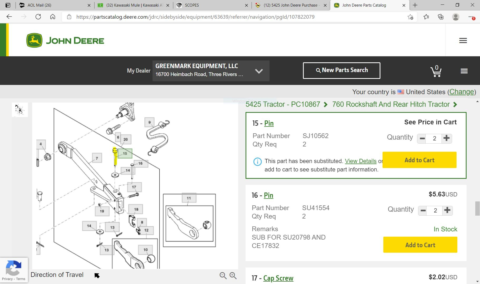

That’s one of the many things I’m going to have to learn, this is my first loader tractor. Need to figoure out how to slide out the 3 point extensions. On side is missing some parts. Dealership said they will ship me the parts to fix it. They are also getting me the service/technical manual. Hopefully they will come through.

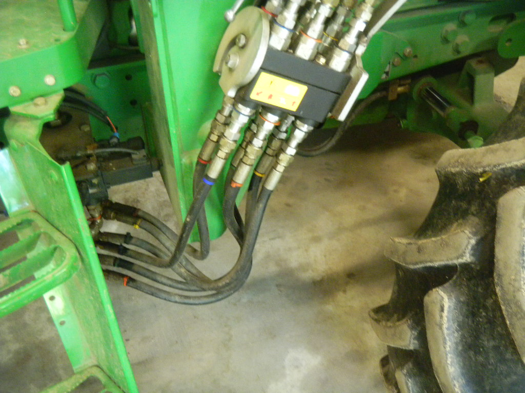

Yea, looks like you may be missing the pins for the stands. That loader is so easy to remove and install. The hoses are actually the hardest part. I have a single point hookup on my new tractor that I wouldn't trade for anything. Probably the single most useful addon that I got. I'm always attaching and removing my loader. I do't have it on my tractor unless I'm using it.

You lift key 15 to release the extensions of the 3pt lower link/arm

Single point, or Multi-coupler is a great addition if you take your loader off and on a lot.
Both of my tractors have one. Both are 3rd function equipped, so it saves dealing with six quick couplers.

Zebra5, l thought l did pull up on pin #16but wasn’t able to slide it out. In reading the operating manual, says to push pit to the inside of tractor then slid out. Haven’t tried this yet won’t be back to the barn until Monday.
That is very nice setup on all the loader hoses on one coupler. Did you install it yourself or was it already on tractor? What would it cost to have that setup installed?
I was guessing pull the pin when I looked it up in JD parts.
I bought and added the single point coupler. I made the mount and had to adapt my loader hoses from JIC to ORFS. It cost me about $600

The 5xxx series telescopic draft links you push the knob to the side. That disengages #18, then pull the end out. If you have the draft link balls with both cat 1 & 2... (shown as #11) Don't use the cat 1 hole. The balls break. Better use a sleeve to adapt a #1 to the #2.

That sure is a clean looking tractor and one of the best of the modern JD's. Good find.
