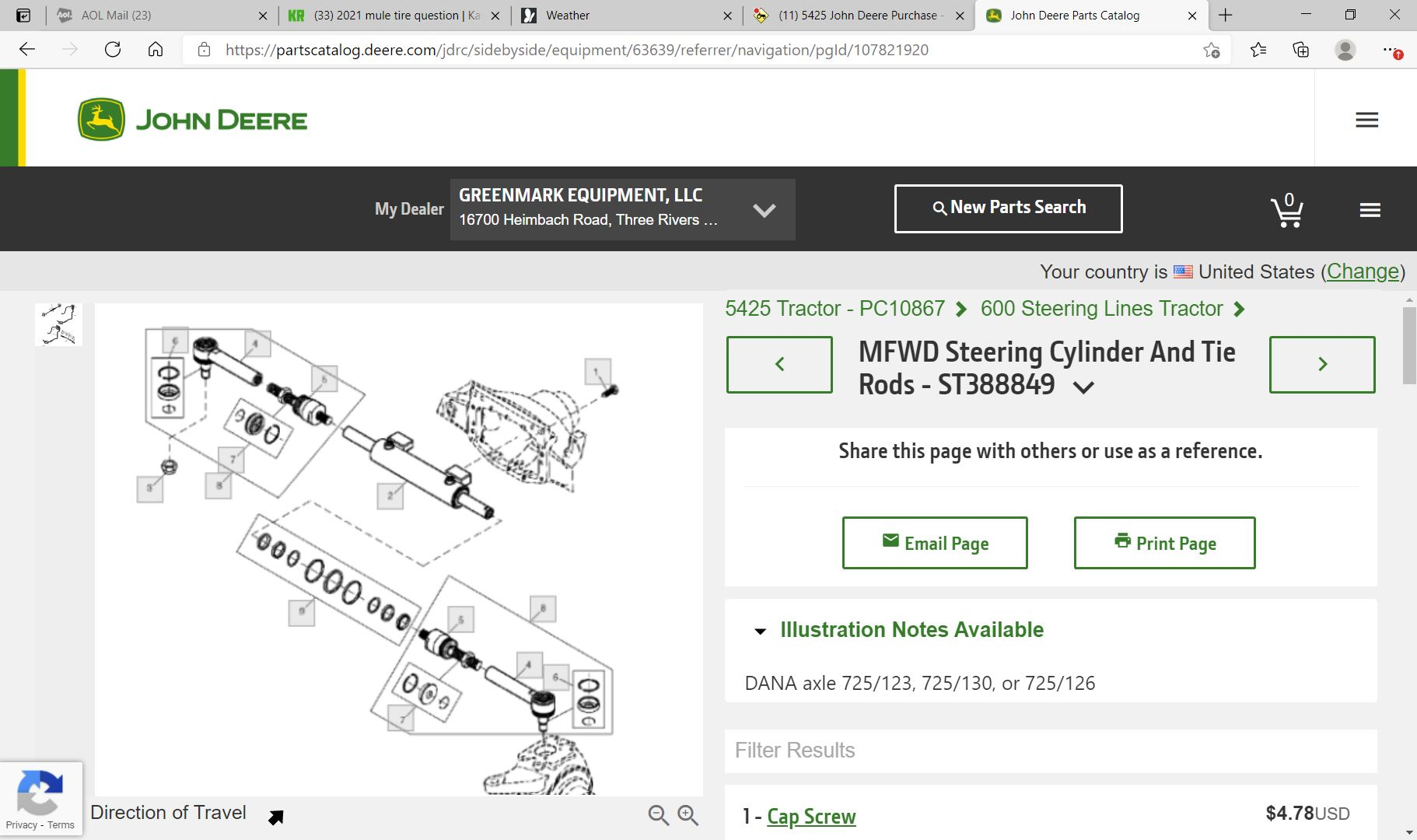

I’m looking for the ball joints for the front wheels steering & the piece that screws on the hydraulic steering cylinder. I tried to look at John Deere parts but guess l don’t know where to find it. Anyone good at finding parts can come up with part numbers. I need both sides.
Which front axle do you have? Carraro or Dana?
Drawing is Dana, does it show parts you want?

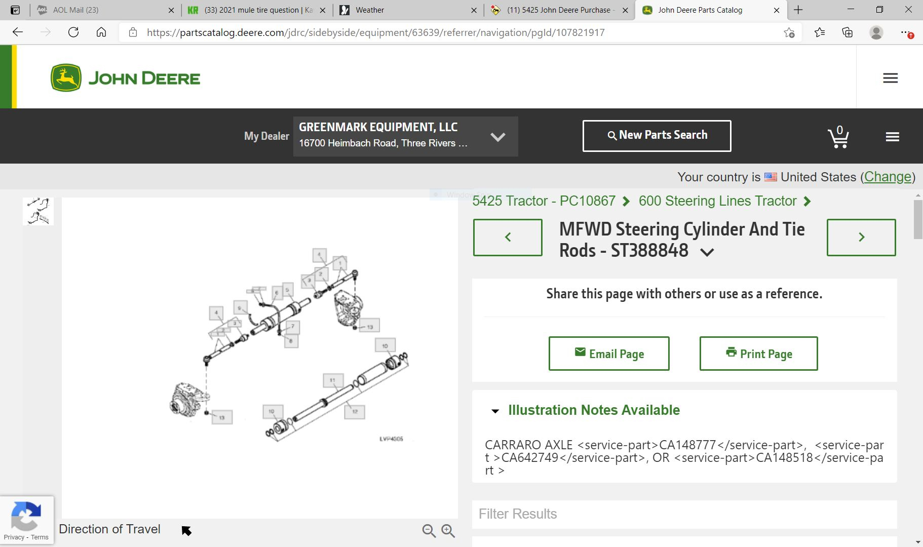

Here's the Carraro axle

According to the drawing you provided, it looks to be Dana. I’ll order the parts according to the drawing. Thanks. I tried to look them up but guess l need more practice. Thanks again.

Your axle should have serial number tag from the maker.

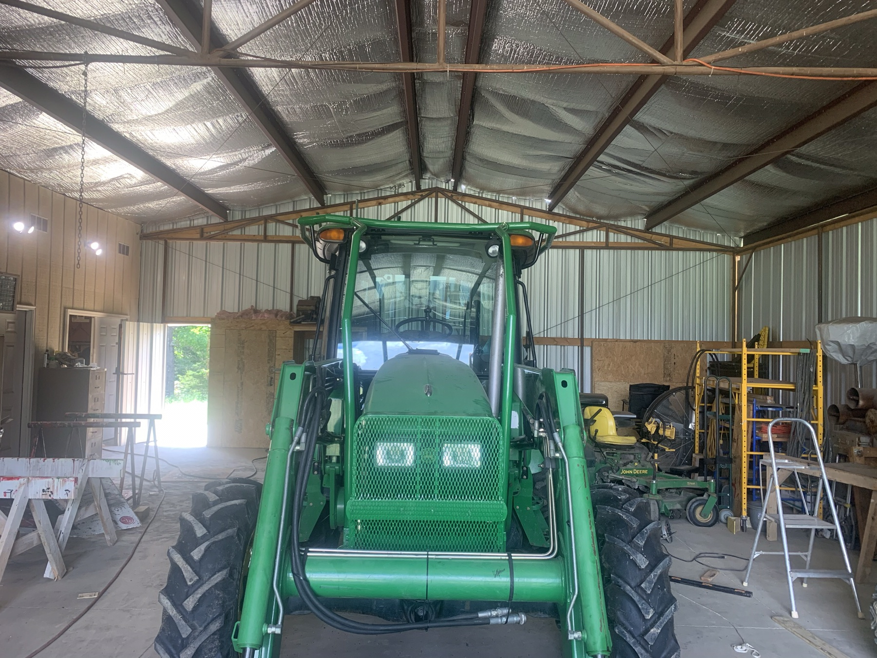

Thanks, l ready like it so far but haven’t been able to use it yet because it still too wet.
I’m fabricating a guard around the top of the cab with risers from the front of tractor to top of cab to help deflect limbs. Ive got one support leg fabbed with 3 more to go then the risers from the front. Spent too much money to take a chance on damaging the cab.
I traded a 2002 Case backhoe & some cash ($$) for this tractor.

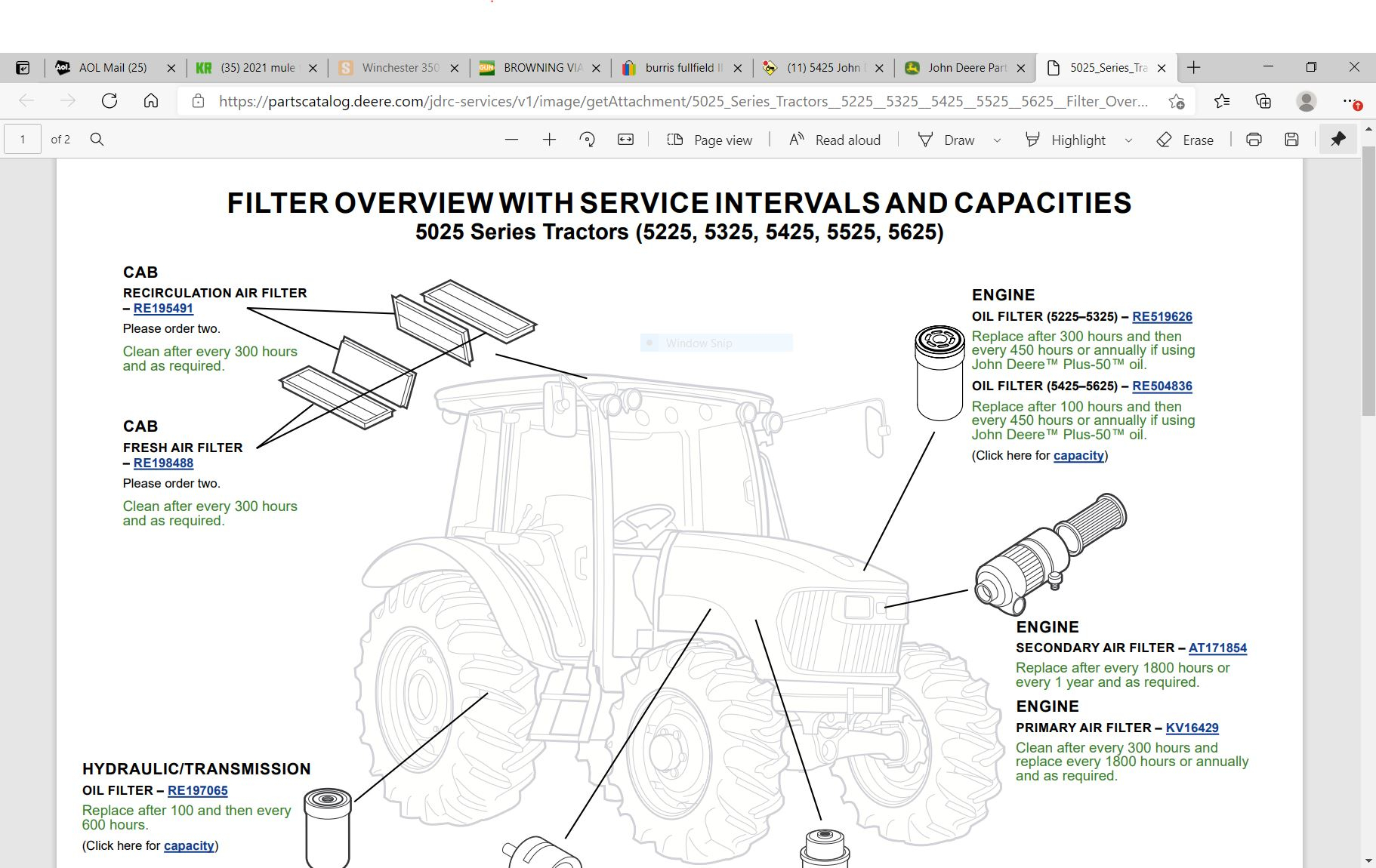

I need to get all the filters & oil from the dealer to get a fresh start. Does this come in a kit form or doml have to buy separately? Would like to order & have shipped. There sure are a lot of filters including the ones for the cab.
As far as the tie-rods l need to look at a new one to determine exactly what l need. The tie-rod is definitely bad, no grease fitting. What I’m not sure about is on the other end where it ties to the hydraulic cylinder. Looks like a boo should be there but isn’t.

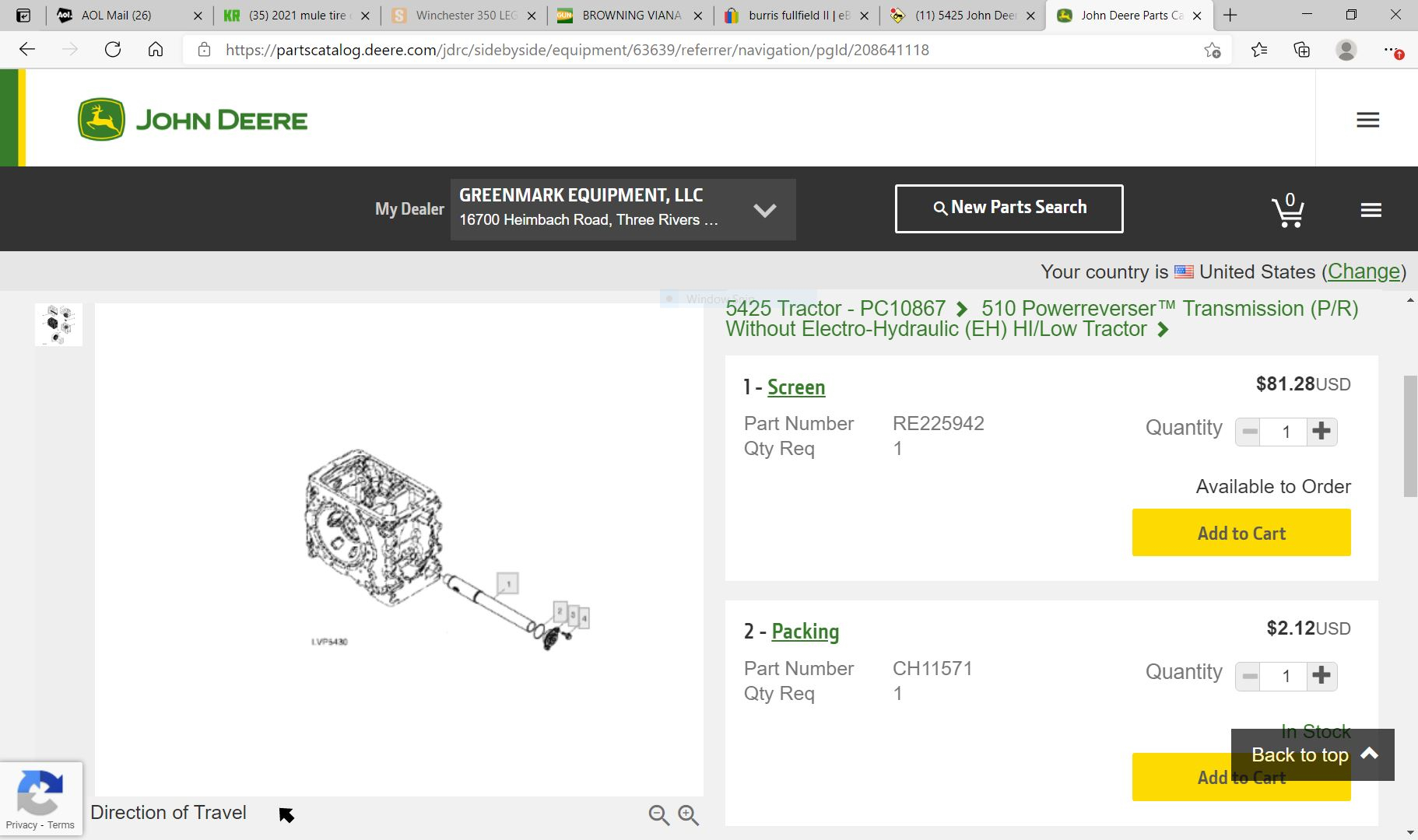

No kit, you have to buy separate. Be sure to check/clean the suction screen in the transmission, get a new packing key 2 also.
