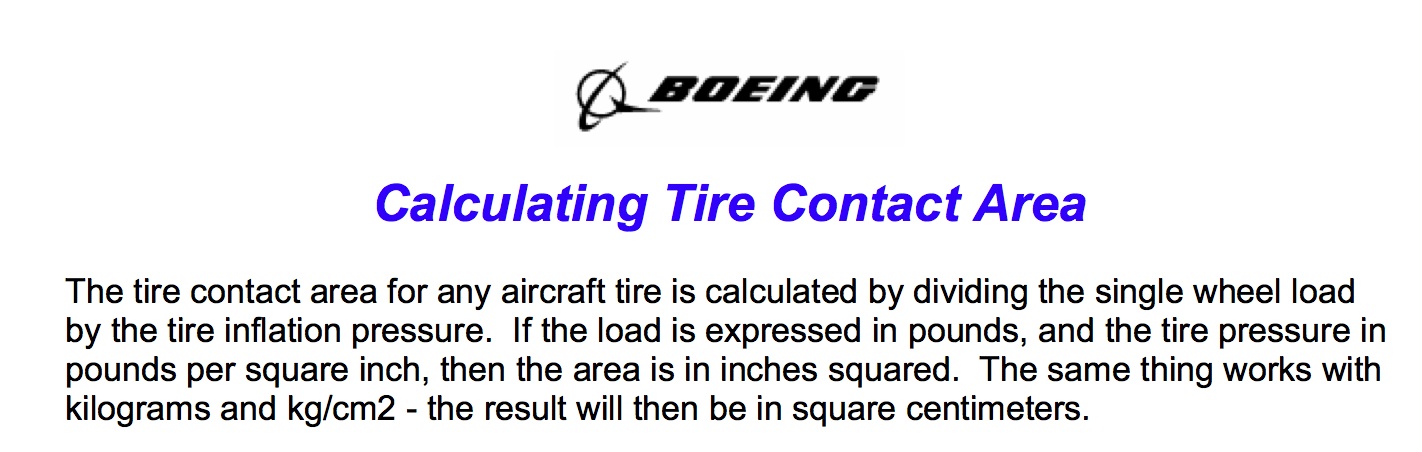

Oh man, LD1, did you let Boeing know?:D
   / 5425 vs 4320 vs 3720 Surface Pressure #44
On my list of things to do today:thumbsup:
In all seriousness though, aircraft tires are about the closest to a balloon as you could get. So I am sure the ground pressure is much closer to PSI on them. Since they are like a balloon and on hard surfaces only.
Car tires, tractor tires, etc are different. Ground pressure and PSI are NOT LINEAR.
So, I will call boeing engineers if you call EVERY big farmer and tell them that they are wasting time an money running duals since ground pressure is =to tire PSI, and that running 4 tires @ 8 psi is TWICE the compaction as 2 tires @ 8PSI

You are right, it's not 1:1, but within a range of pressure it is actually linear. Tire construction does matter, and they are designed to operate within a narrow range of pressure.
The reason for larger tires, duals and triples is because the soil conditions will not tolerate the pressure, say 10psi in this case. You can certainly decrease contact pressure by going way up in tire volume.

The key point that most of us have been trying to make to you is that within the design parameters of a given tire the tire pressure is a close match to ground pressure. If you exceed the design pressure or deflate the tire beyond the design limits you can distort the tire and all bets are off.
The OP asked about R3 tires on three different tractors no one but you has said anything about using the same size tire on the different sized machines. The 5425 will use physically larger R3 tires than a 3x20 or 4x20 tractor which weighs much less. I think most of us understood that appropriate R3 tires would be selected for each of the tractors being considered.
This isn't rocket science, just simple physics. Your repeated comments about dual tires:confused2: have no idea where you are going with that.
