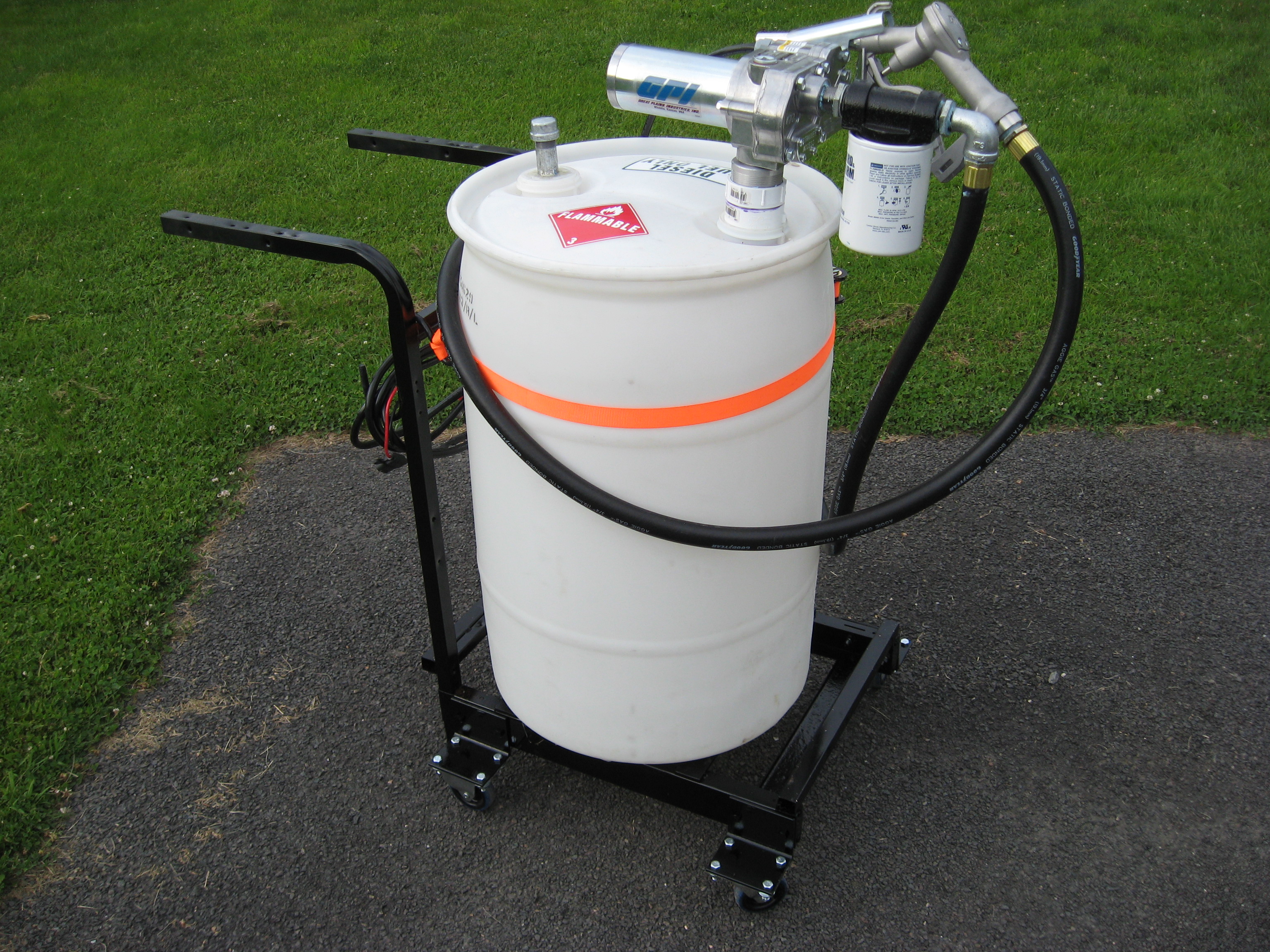

   / 55 gallon barrel fuel station questions #8
This is what I built. I had an old gas grill frame that got repurposed and a set of wheels added. A free 50(?) gallon plastic drum from a car wash that was cleaned completely and a pump purchased from Tractor Supply. A couple added pipe fittings and it works fine. I added a metal nipple on one of the bungs that I open the top cap for venting while using the pump. The nipple was the same thread pitch as the inside of the bung knockout. I added some epoxy around the top of the bung cap and the bottom of the nipple to keep it all tight. The pump works on 12v so I just hang my battery jump box off the back handle when I need to fill the tractor and connect the power lead alligator clips from the pump to the alligator clips on the jump box. Turn the box on, turn the pump on and away I go. To fill the drum I unscrew the bung/vent nipple, put a funnel in the opening and pour the diesel in there. It's a lot easier lifting a 5 gallon container and pouring it into the drum than it is lifting it to the top of the tractor...and usually spilling diesel all over the place.
