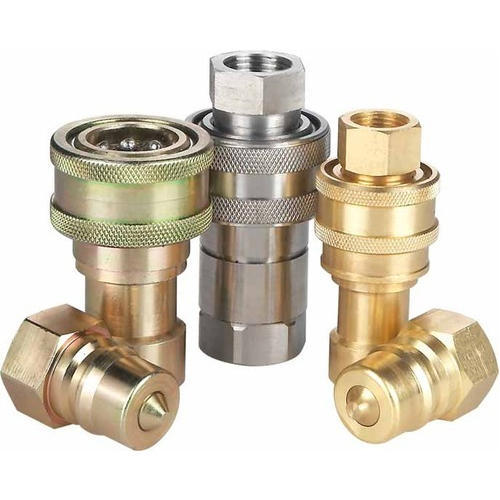

I use a 55 gallon drum with a 12v Fillrite pump. Usually when the fuel guy comes to fill the heating oil tanks I have him fill up the 55 gallon drum. However I have taken the drum in the back of my truck to the filling station. There's a few thinks you need to think about. 1st 55 gallon drums don't easily tie down in a pick up bed. I made a ring that slides over the top of the drum that has 4 loops in it out of steel. This allows the ratcheting straps to easily work. 2nd if you don't have an easy way to lift it safely then having two drums (if you have a place to store the one not in use) works well. You simply use the pump to transfer the fuel from the tank in the truck to the tank that's not. 3rd you will want the tank either in a handy place or on wheels so it can be rolled around your shop. 4th you will want to put a quick disconnect/ plug both the hose and the power cord on the pump. Since my pump is 12v I didn't want to use the typical 110v plug so I used a twist lock and the prong that's normally the ground I used for +12v and the neutral prong for the -12v. That way if it is plugged into 110v by mistake nothing bad should happen. That way when you screw the pump into the drum you are not fighting the cord and hose. Also with the hose removed when not in use it's less likely to get dry rot damage. I don't have a picture of the ring I made but here's the disconnect and plug.
