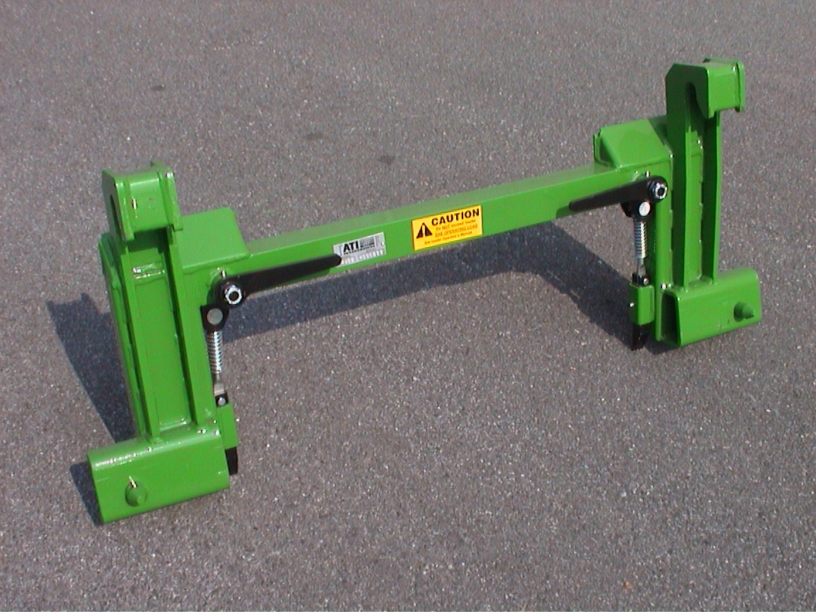

Anyone got one of these for your JD's? It looks pretty slick and you can use both JD and SSQA.

I debated it last year and learned there were a number of sellers but only a couple of actual makers and I got confused. I wanted to use a "tree shovel" type transplanter that only comes in skid steer configuration. The price of the Deere loader frame adapter varied widely. As well, there are two types; the one you show that hooks to the QA brackets (seems the easiest?) and one that you remove the loader pins and OEM bracket and replace (seems the strongest but least practical?).
I learned Deere made an adapter but never got that far to learn more. Deere also makes QA brackets that you can weld to an implement and allow it to QA to your current existing OEM brackets. They call them "bucket brackets" in the "bullet attach" style and are whole goods #BT13919 ($255 last year). There is a picture of this bracket--plus some other great loader info--in the attached PDF.
Also, did you know you can put a 3 PT hitch on the front of the JD5520 that I think(?) is compatable with the loader? These are remarkably versatile tractors.

I like the design of this one and the fact it goes both ways. Kinda spendy .... Everything I have is SSQA ... with this I would not have to modifiy the JD Bucket or the JD hay spike.
One of my other neighbors just took delivery of a 5083E and says JD ordered him a SSQA for his front loader ... when it comes in I want to look at it.
Thanks for the PDF ... and I did not know about the front 3 point.
