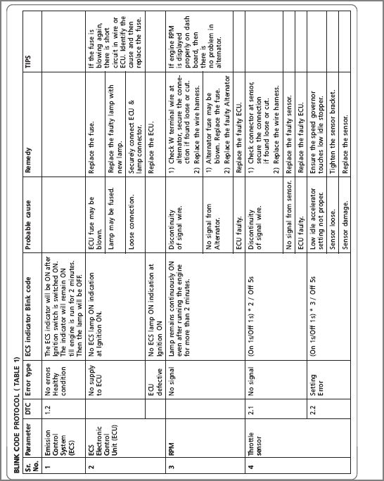

   / 5530 Back to the dealership. #13
Mine flashes 4 times stops and repeats. Called dealer said "ignore it". Thanks to the EPA it was put on to meet their import requirements. Sensor has no bearing on the efficiency of the 5530, so i was concerned at first also. All in all the 5530 is a heck of a work horse. It's even great for picking up 4 elk from my field, 320 yards to the hanging meat pole!!

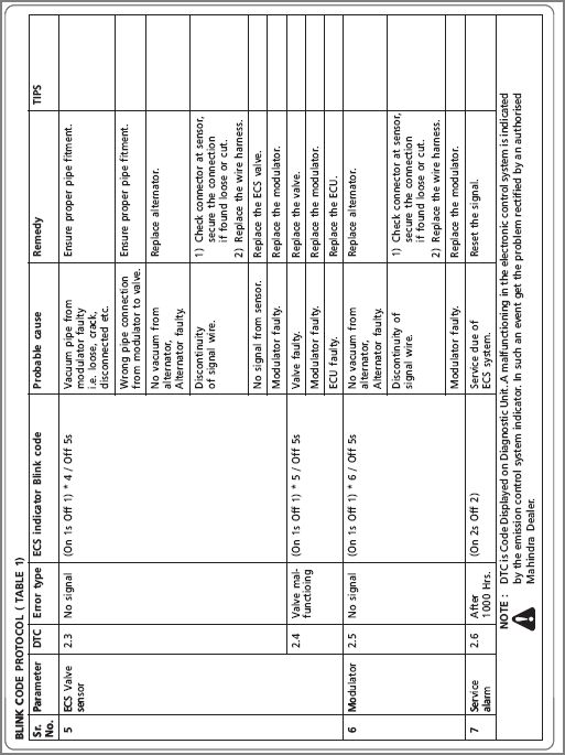

   / 5530 Back to the dealership. #17
Sure would be informative if we all were able to have a code reference. Save all of Mahindra owners the hassle of resolving these blinking light issues, which to ignore or which have a real concern about. Any dealers out there that can shed light on this would be appreciated by all.
Idaho2
   / 5530 Back to the dealership. #18
Hopefully these help they are for a 2010-2011 5530 6030 & 6530
