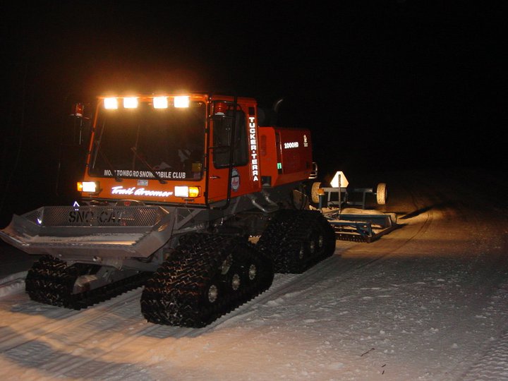

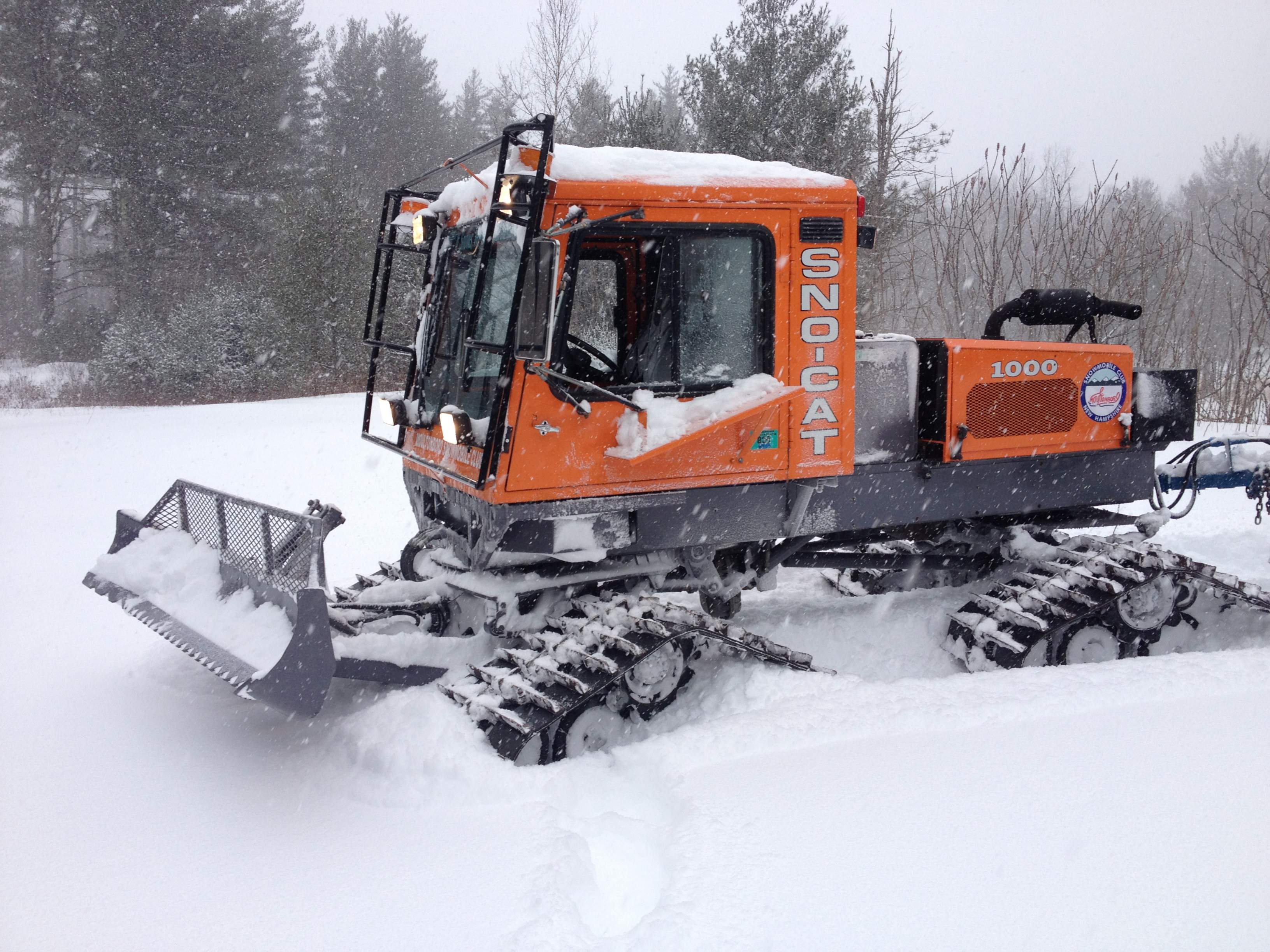

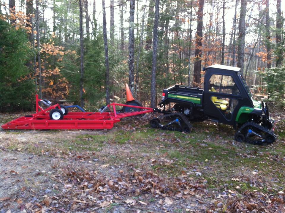

I groom a fair amount of snowmobile trails so here are my 2 cents. To your point, I can just run the Tucker with no drag and pack with its tracks, it does a good job but I have to go over everything twice to cover the trail.
The drag is for making the trails smooth. We like to pack them by rolling them first, otherwise the drag's pan blows the snow off the trail!
If the picture post, you can see the roller tires behind the red drag- I can take a better pic if anyone is interested.

I think what you have will end up working. Super low moisture snow is impossible to work with anything. That is what I was in in my third pic above in the 97 Tucker. You can see it gets pushed out of the way too easily, 14"=2" packed!
