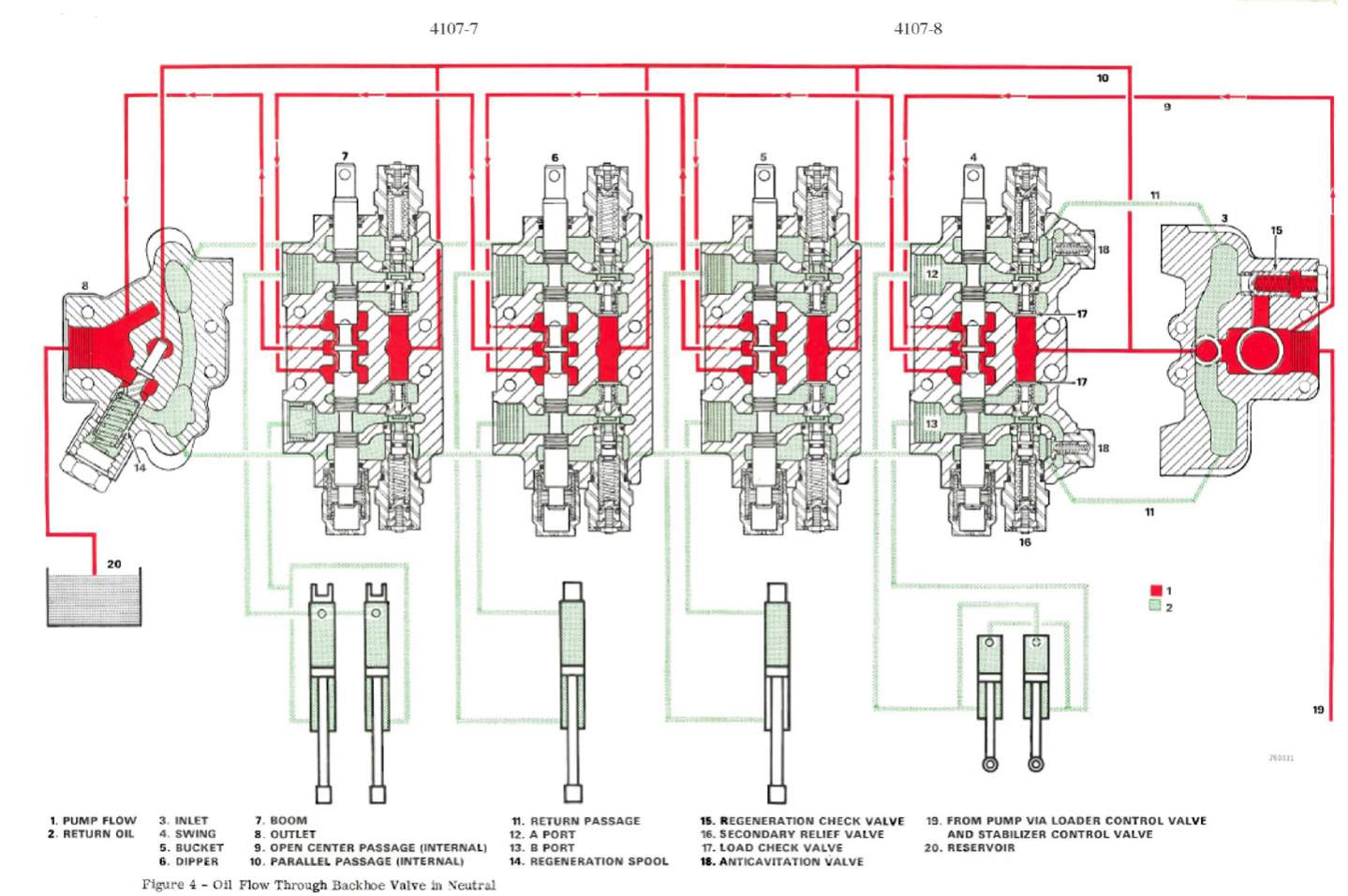

Today I had to replace the main hydraulic supply hose under the loader valve. A while later (maybe an hour or so) the backhoe hydraulics were slow and weak. The loader is fine. Fast and strong.
When operating a control, say raising the boom with a load in the bucket, the dipper drifts down and the swing drifts to the left. The drift is quite fast. If I release the boom control, the dipper and swing drift stops. I imagine I got some crud in the system but would like some advice as to where I should start.

I am absolutely positive the dipper and swing spools are bypassing fluid. I tilted the machine with the stabilizers so it leaned to the right (sitting in backhoe position). The swing drift is absolutely to the left. Not sure if it's a "drift" if the swing is uphill though. So, when putting a load on the system by curling the bucket all the way in or out or running the extend-a-hoe all the way in or out or raising the boom with a load, there is positive oil flow that makes it swing to the left and drop the dipper.
Since this happened suddenly, I can't imagine that two different controls would simultaneously have springs out of adjustment. I'm sure you understand what I mean when I say my hands are very familiar with the position of the levers. They are centered while this is happening.
Another symptom; I do not hear it (I guess my ears are too old...) but my son tells me he hears a "hissing" sound when operating a control that was not there before.
In studying the diagram, I don't see anything that explains the exact symptoms but then I've never had one of these apart... However, the regeneration parts seem suspect to me. If one is stuck open I wonder if that would cause these symptoms.

Do you have any other diagrams of this valve or a hydraulic schematic? I am having difficulty understanding how flow is controlled or directed to work ports from the diagram you attached.

I had to post it on another site since uploads are limited to 1M here. The backhoe control valve docs start on page 99 towards the end of the document.
http://absolutenet.com/tim/580Chyudraulics2.pdf
Today I pulled the Regeneration Check Valve and Regeneration Spool to check for crud causing them to stick. Although there might have been some really small stuff in the spool, cleaning and flushing did not fix the problem. :(

I finally talked to friend of mine that worked for Case in their BH plant hydraulics division. He said if your valve is a "Case" valve and not one made by Continental the problem is a pretty simple fix.
Between the work port or auxiliary relief valves and the load check is a plug. This plug requires a special tool that is described in the service manual to remove. On these plugs are O-ring and back-up rings that extrude over time. When these seals fail it will cause the drift problem you are experiencing. He said you should probably check and replace all the seals on these plugs.
