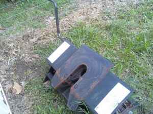

Hi, Wanted to ask -
With the 5th wheel plate level what is approx the height from the truck bed floor to the hitch plate surface or how many inches below the bedsides would be normal?
I got a used reese 20k dual pivot hitch but not the mounts. Thanks, Dave

Cool , Thanks for the info guys. Im stuck at work and this is the only pic I have, saved from the CL ad that I bought it from.
Kind of hard to conclude from the photo, but you may be missing some parts. There are rails that bolt to the truck bed/frame. The hitch pins to the rails. They run "east/west" across the bed.
Also, you'll get all sorts of advice on fore/aft position. Just make sure the hitch pin sits 2-3 inches in front of your rear axle. Check the Reese site, they probably offer the installation instructions, or a phone call could get them.

Yeah, I know its missing the base, thats why I asked about normal height. Its different than that one you guys posted the pdf for. this thing is older and has a flat bottom.
I will mess with this after I finish a couple other projects, dont even have a 5th wheel trailer yet, just wanted to have the capability.

In that case Dave, it doesn't matter. The base should be close, or at the bed level. Is the hitch itself height adjustable? Mine has a number of holes to mount the upper frame to the lower. So do most trailers so you should be OK.
