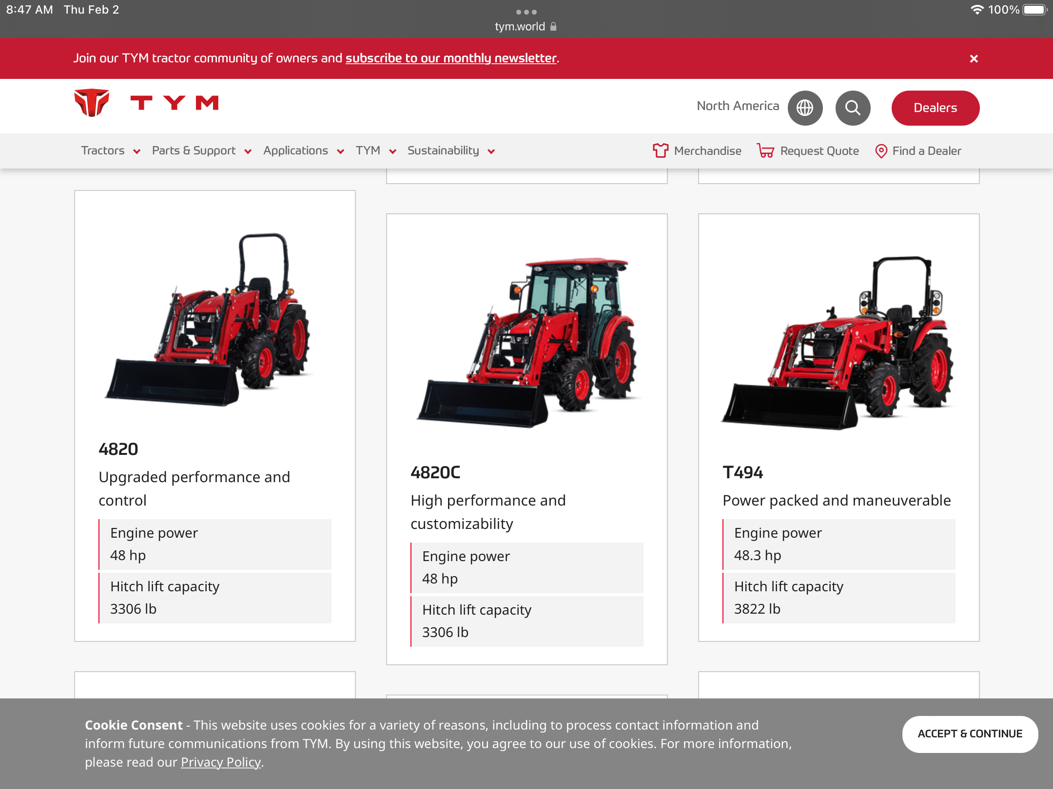

TYM's web site nor tractor data.com show a model TYM 4820.
What tractor do you have? Enter your tractor make and model into your TBN PROFILE correctly.
Appears to be a Branson TYM 4820H.
Open station is ~3800lbs so it must be cabbed.

TYM 4820H.
The unit weighs #5000 with loader.
