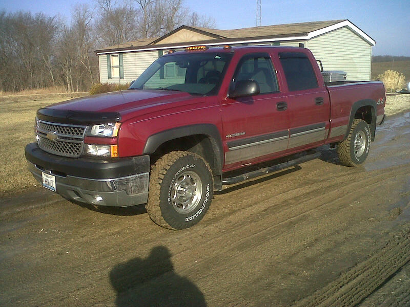

I like my 2500HD with 6.0L. I have not had a chance to do much towing with it but the truck has power that's for sure. A freind of mine is a masonry contractor with a 3500HD dually. He has the 8.1 with Allison. It is a pulling machine. I have seen him pull loaded trailers out of the mud that a newer PowerStroke couldnt budge. He has 4.10 gears. 8-9 mpg
See this for link to my truck http://www.tractorbynet.com/forums/trailers-transportation/197020-2005-chevy-2500hd-crew-cab.html
