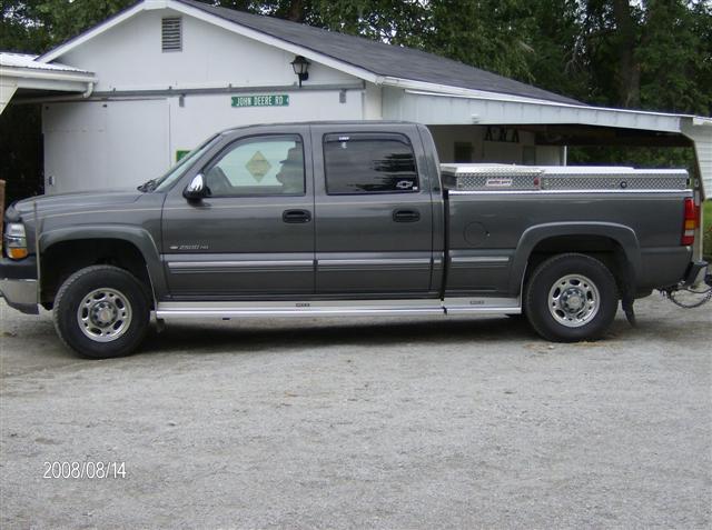

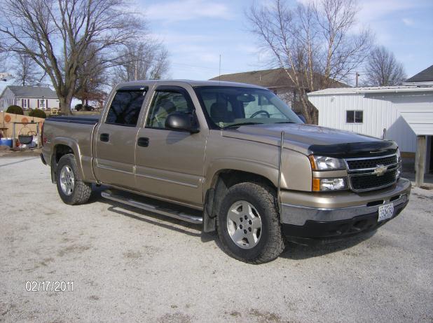

I just traded off my 2001 2500HD w/6L, trust me, you won't have any shortage of power! I've towed 12-13,000 with mine (JD 720D w/500# of wts., plus second trailer w/4 bottom JD mounted plow). We have a pretty fair hill outside of town that's over 1/2 mile long, I could gain speed all the way up if I wanted! Of course, the gas gauge went down all the way too.
Don't plan on very good gas mileage though, maybe in the area of 15-16 at best.
I went down to a 2006, 1500 w/5.3 as I don't tow more than 7,00 now, much better gas mileage. as for the bed length, I'd rather have the 6-1/2' bed (NLA on a crew cab), but I'll live with it. If I'm going to haul more than tools, I just hook onto a trailer! ~~ grnspot110
