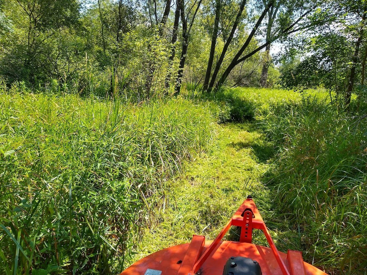

I have a 6' mower on my B2650 with 19.5 HP on the PTO.
I knew about the HP to size ratio but salesman said go 6',
and there have not been any issues.
