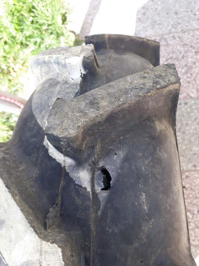

The front tire (Golden Rabbit brand from China) on my tractor got a flat as I drove it through a field where I'd just mowed some brush. At the time, I only saw some thorns stuck in the tire, which I thought was the cause. Yesterday, the tire shop repaired the tube, and now rolling the tire back to the tractor, I noticed a huge hole that I guess wasn't visible when it was deflated. I have a feeling that such a hole is going to lead to a defect sooner or later, and probably sooner, and probably can't be repaired.
So I wonder, are there 7.00-16 tires that are tubeless? The wheel is solid, so I think it could work with tubeless tires? And holes in tubeless tires can be plugged just like car tires, right? Or is it possible to also plug holes in tube-tires?
The tire says "6 ply rated" and "nylon". Maybe there is a thicker, tougher tire than these?
I really doubt you will get a tractor tire in that wheel size of more than 6 ply. On TT vs Tubeless, the wheel rim really needs to be designed to seal a tubeless. Most TT wheels will not provide adequate tire to rim surface area to make a tubeless work....even on a new wheel, nice and shiny.
If you want more, suggest you look for a 16.5 tubeless wheel in 6 lug like would be used on a セ-1 ton pickup truck where you can get 10 ply tires to fit. Course they wouldn't be 3 rib and in turns you could have some slipping you don't get with Farm Rib tires.

A 235/85-16 is the same as a 7.50-16 and are available in 8 and 10 ply ratings. As retreads they can be found with a tri-rib,
also used aircraft tires of 15-24 ply have been used on wagons and front tractor tires quite successfully.
