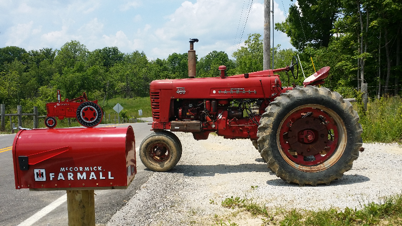

I live in a very rural area so I have the perfect tractor parts store that will make anything custom and so far has come up with all of the parts I've been looking for.
They've actually taken parts off of their Farmall tractor and sold them to me. Very obscure parts of course.
Thanks for all of the help! I will have new battery cables as soon as it warms up enough for me to take the old ones off.
With that being said...
I'm still going to ask if anyone knows of a 6 volt battery starter?
