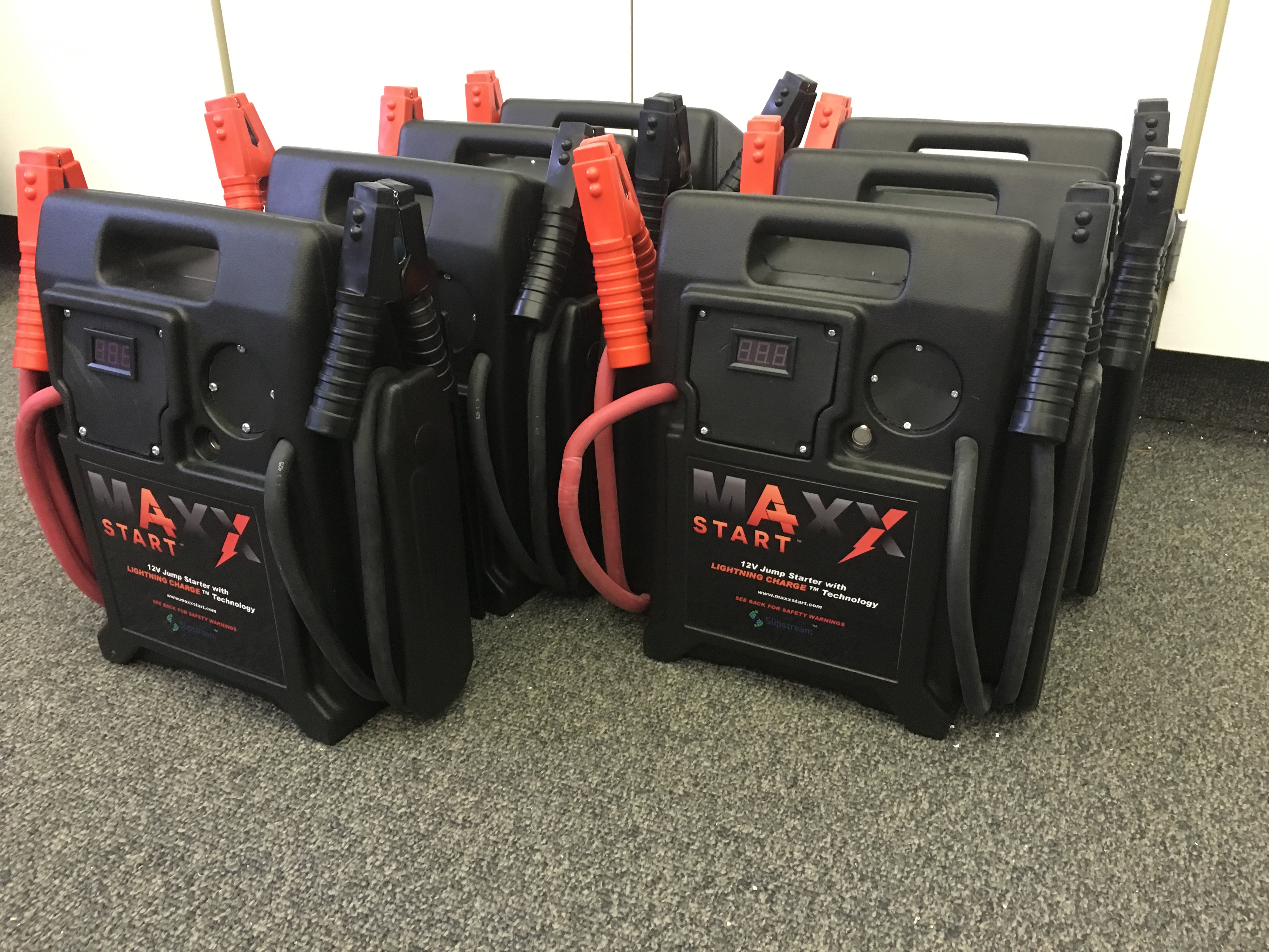

My company has developed a new 6V jumpstarter with very high cold cranking amps. It is capacitor based and recharges instantly. If anyone here would like me to send a free unit in exchange for user feedback please reply on the thread or send me an email. kokeeffe@maxxstart.com IMG_5005.JPG
