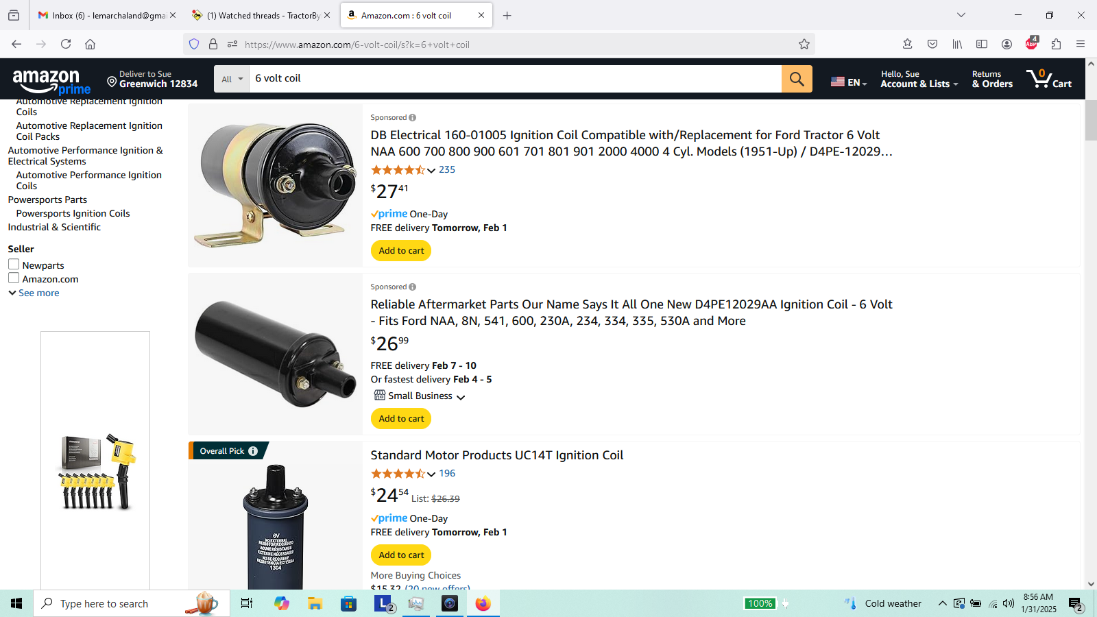

Lots of places to get a 6 volt coil for less then that;

“Less than” is not always the ticket. This will be the third one on my 1951 Ford 8n. I’ve heard that the NAPA ones are supposed to last the longest. The last one that I got for it was from TSC. I see that the new ones from NAPA are made in China. There seems to be quite a variation in product quality coming out of that country.
