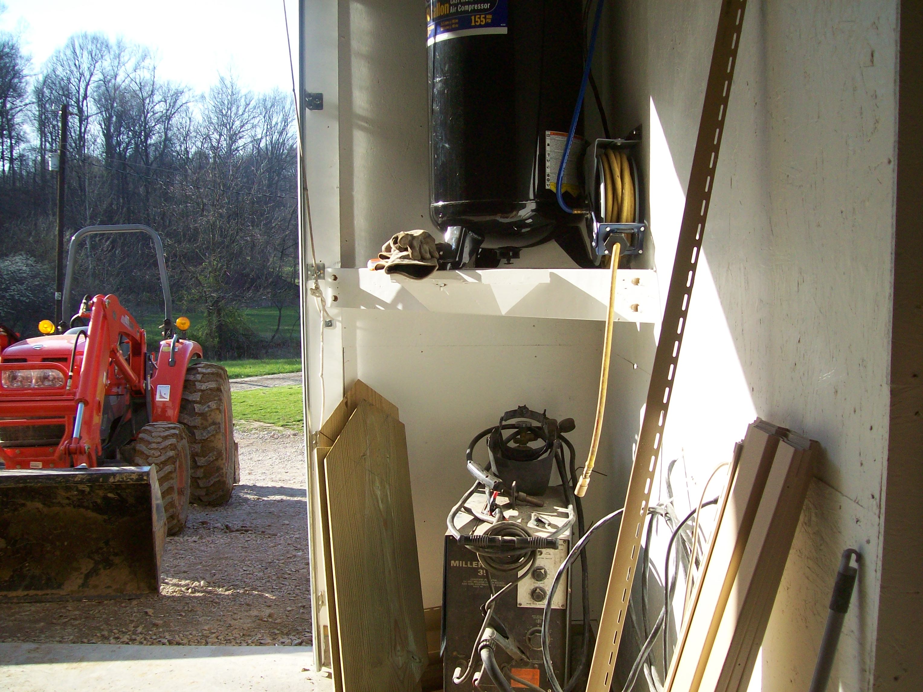

My kobalt 60 gallon from lowes sits about 5 ft off the floor. I mounted it up high so I wouldn't loose any floor space. I don't think it's going anywhere any time soon. I lag bolted 2x6's to the walls, it's pretty sturdy
Now there's an idea. I wonder if there is any downside to this set up????

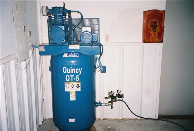

I Got agree , My Bigger ones a Quincy Commercial in My big Shop , & They Said It Should be Bolted Directlly to the Concrete When I Bought it .
I Dont quite get why You would want to Leave it on the Pallet, Unless You Want to Move it all the Time . & have 4 Others in the 2 garages & Sheds that Have Wheels on them for Being Mobile , :D , Bob
