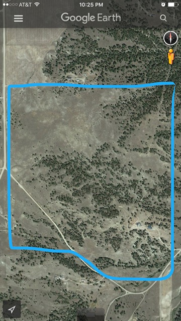

Property from space, I would say its a pretty good mix of trees and pastures, I made a shooting range out of one of the pastures, no idea what im going to do with all the rest of them yet :)

About an hour north of Billings Montana, I dont actually live in the town, its in name only, house in the country/mountains
I suggest you add Montana to your location of Lavina in your profile.
Here we are at Post #29 and the critical information of THE ALTITUDE OF YOUR PROPERTY is unknown. Had Montana been included in your profile someone would have asked your Montana elevation by Post #5.
Altitude reduces diesel engine power output fairly quickly. Over 6,000 feet a turbo-charged diesel engine is recommended in most tractors, in most situations.
