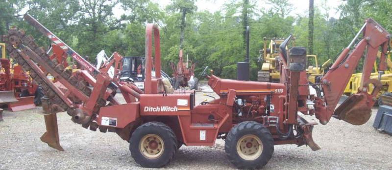

Rent a ditch witch with a 48" stinger or a decent 5 ton hoe. No way would I mess with a bx for that long and deep unless I had no time restraint. We did 300' water and 200' of 3" conduit 36" deep. If you have a helper to glue connections it's no bad at all. Try to get 20' joints too

I recently used a ride on ditchwitch trencher to go 42 to 48 inches for a lot longer trench than yours. You could do it in a day. I don't recall the rental rate. Rocks were abundant and a problem but we got it done.
If you don't go with a trencher get a small to medium excavotor.
Pay extra for for damage insurance. These things are expensive to fix.

I've used trenchers several times, and learned to go big or go home. Rent the largest trencher available with at least 48" capability and 6" wide with rock teeth. Ride on, 4wd, and diesel. They will have a backhoe on them which makes the start and stop points easy, and lets you dig out large rocks if you hit any. I used a large Ditch Witch for an uphill, 1000' run which worked fine. I started the cut and ran about half way, then my wife ran it from that point while I started laying out conduit. Another time I used a Vermeer which was even larger and made the work seem easy. If you're not going to get the utilities in and the trench backfilled before rain, then I would use a backhoe or excavator. The big advantage of the trencher is the narrow trench and smooth dry backfill, but if it gets rained on, that turns into a huge disadvantage.
