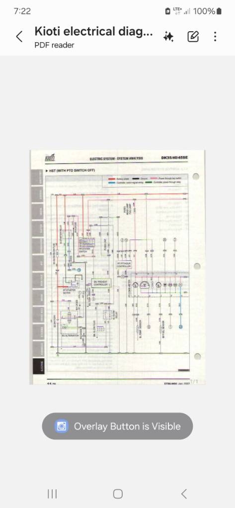

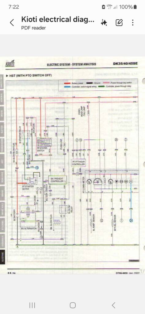

New here. I have a DK45SE that when the key switch is turned to the first position (where the glow plugs kick in) it blows the 60A main fuse. I just installed a new starter and a new key switch. It was doing this before the new components were installed. I disconnected the glow plugs and tested the circuit. Timer comes on, the glow plug light comes on for 15 seconds and 12v present at the plug. The fuse does not blow when the plugs are disconnected. I pulled all of the glow plugs and tested them. All at 0.8 ohms and tested on a battery for proper operation. For the moment I am running without the glow plugs connected and everything works fine. Any suggestions? Thanks in advance. There seems to be a lot of knowledgeable people here and a great community.

Starter ground may be bad, so it's back flowing thru the glow plug circuit. Without the plugs wired in, it's finding another pathway. The 60+ amps is the starter load backfeed.
If so, disconnect the heavy wire from the starter, and see if the glow plugs work as they should. The starter won't roll, solenoid MIGHT try to pull in (also could be bad ground related). Another way to check would be to hook a grounding starter cable from the battery neg to the starter housing.
Just a wild guess. Couple of Fords with the woven grounding strap drove me nuts for a while.
