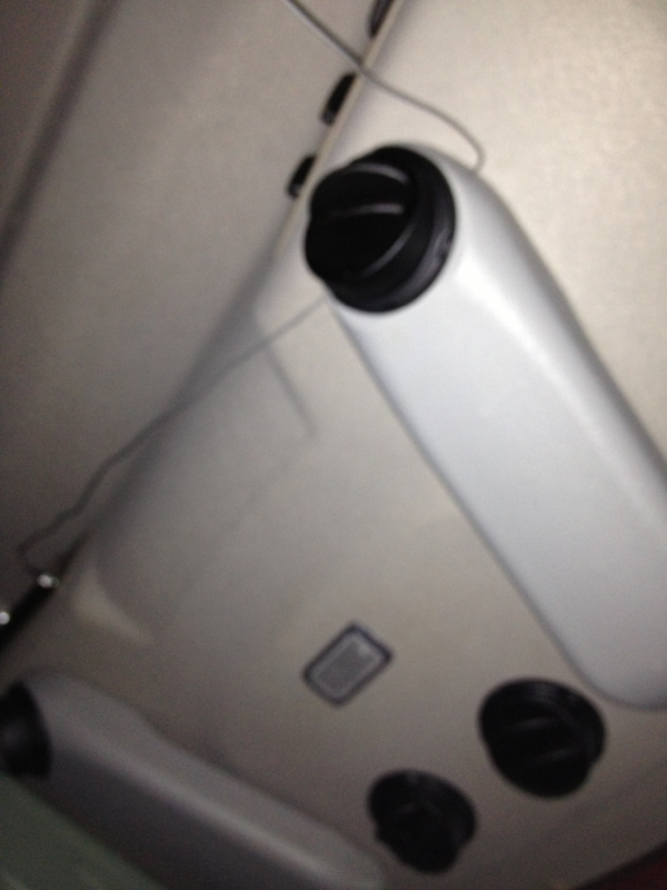

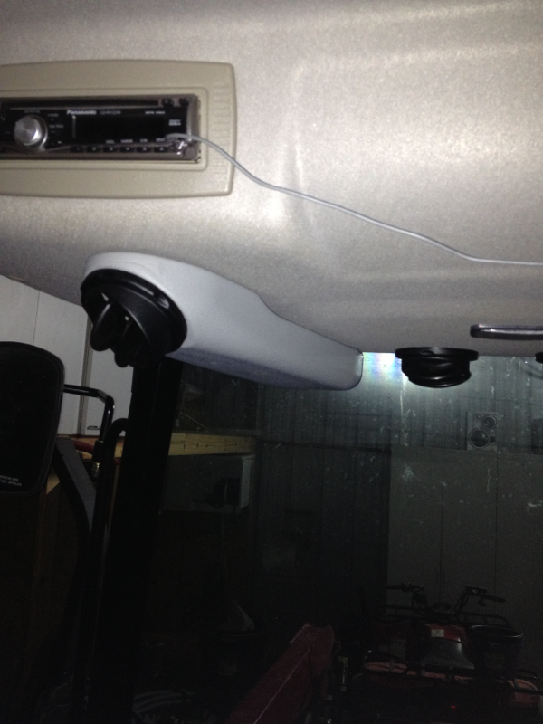

Just bought one two months ago. So far I am pleased (70 hours). There is a recall or service bulletin on ac. It leaks out if the ceiling, the warranty repair solved the problem and actually improved performance. I am in Texas and spent 6 hours this past weekend mowing... 90 degrees sunny and very humid at least 80%. Ac kept up fine until condenser got dirty. I will probably tiny the windows.

I have been using the AC in mine for a little bit now......It hasnt been super hot yet here in AR, but it is coming. Lately i have the AC on about half/blend and with the fan on low and i have been plenty comfortable. I made the mistake of only running two vents with the fan running on a higher setting and ended up getting condensation leaking in the headliner. Be sure to open all your vents and let the fan blow.

/ 6110 cab questions?? #5
The original set up is four vents across the wind shield. Upgrade will add two "arms" that relocates outer vents back towards the driver. Also, it will have a newer style blower assy. and drain pan. It is a package deal so if it looks like this you are good to go,if not it will rain inside...a LOT.
Hope you get a good deal. Enjoy.
It definately doesnt look like this.....Thanks for the pics! I will be checking on this for sure!!

/ 6110 cab questions?? #9
This is the warrenty repair from Mahindra cause mine didn't get this all they did was wrap the excisting pipe with insulation and it didn't help.
